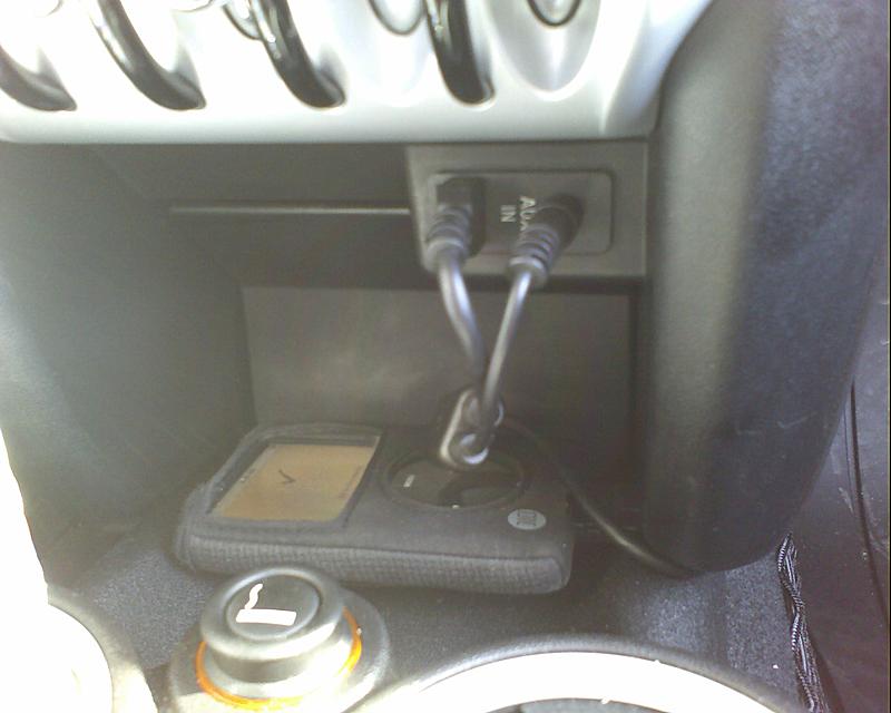

Not stupid at all- you would think that would work, but it doesn't. The Y cable has both USB and aux (3.5 mm) outputs to plug into the two ports in your central pillar. The other end is an iPod connector; in between is a box that translates "iPod" to "MINI." Your dealer should have thrown one in if you got the convenience pkg, though they're not obliged to do so.

Here is a picture of the cable connected. And it MUST be the Mini supplied cable as there have been others that have tried a cable for Kenwood and others that do not work because there is a resistor built into the cable to tell the computer what type of iPod it is. I.E. the USB port has a way of determining what type of software connection to use with the iPod.
I appreciate your efforts, but it looks like the picture post didn't work out? Nothing appears in your post image wise. These forum picture things are a bit tricky....I've never understood why they work half the time.

Yes the thread keeps telling me i can not attach this photo as is has already been attached to the thread so i have renamed it to see what happens.
Attached Thumbnails Playlists in USB/Aux Y Cable-mini-y-cable.jpg
