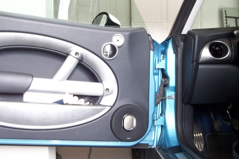

Thanks nabeshin. I still didn't get the bass loss thing, so I called Crutchfield to see if they could explain it to me. The salesman said that you didn't loose it, but the speaker upgrade changed it into clarity which you are percieving as loss. Not sure if that makes sense or if I got it right, but that's what I understood him to say. He also said that you can get more bass out of those speakers by adding an amp, which can be done anytime in the future.

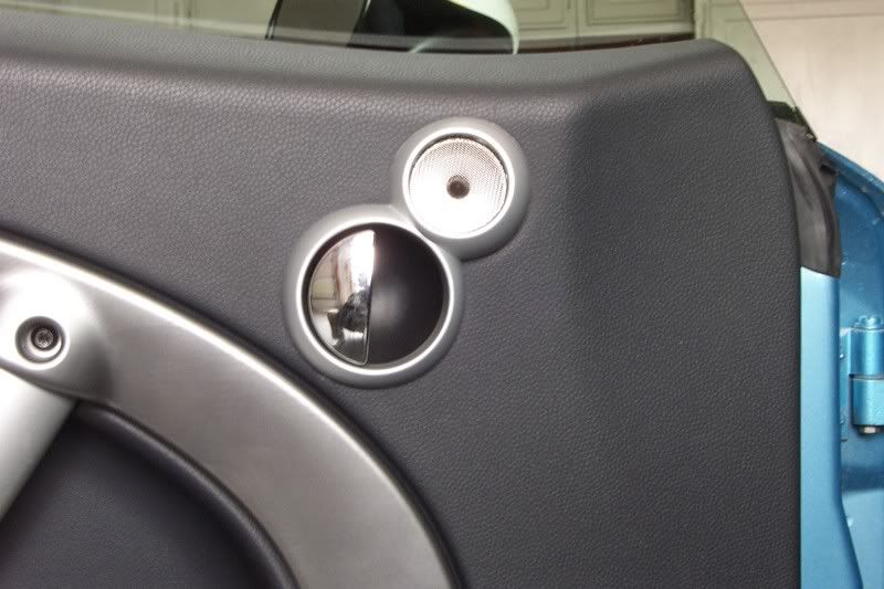

So the way you cut door panels, the speaker and wood stick through the enlarged hole. How much does the speaker stick out from the door? Obviously not beyond the cover's ability to completely cover it.
Can you take a picture of the final door? I'm interested in the tweeter covers and good shot of the woofers.

The speakers and mounts ended up flush with the door cover. The tweeter only looks off center because of the angle. It is pointed in the same direction that the stock grill did, even though the stock tweeter wasn't pointed.

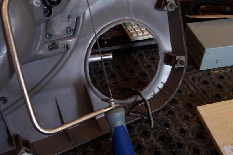

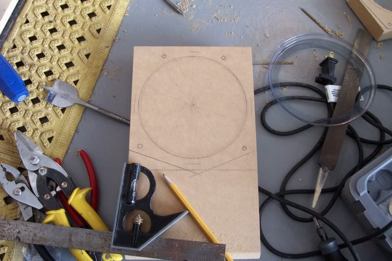

I spent 5 hours last night, and 8 hours today installing the Infinity Kappa 60.9cs 6.5" speakers. It was my first ever install. It took a lot of time to figure out how to get the speakers to mount. I didn't any pictures of the driver's side. I attempted that first, so it was a thinking game. After I knew what to do, I did the passenger side, with many pictures. Note: The resolution and clarity you see is the best my camera could do...

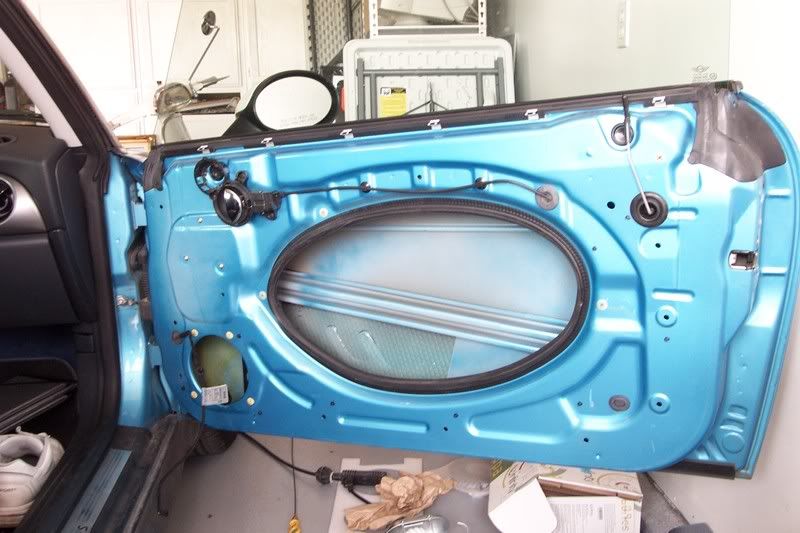

Pulled the door panel off and removed old speakers:

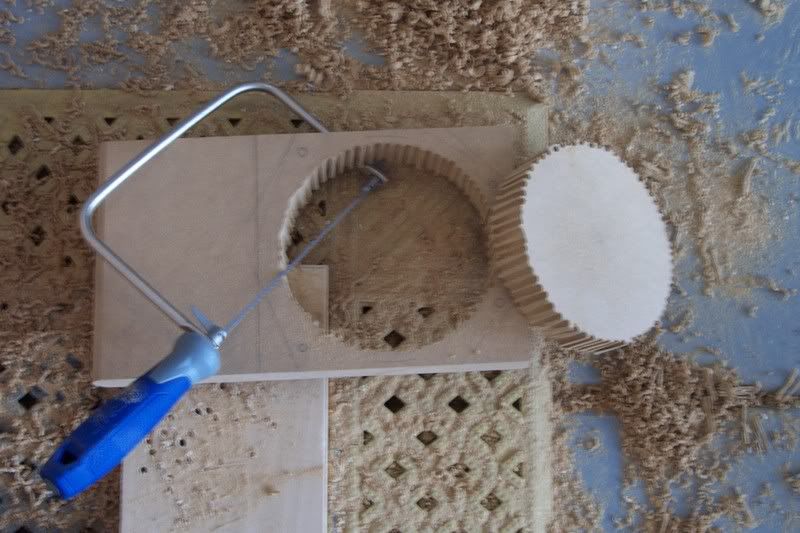

Engineer speaker mounts/adapters out of MDF:

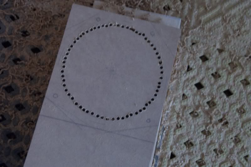

Manufacture said speaker adapters/mounts:
this is how it is done if you don't have a router, and your dremel is too weak.

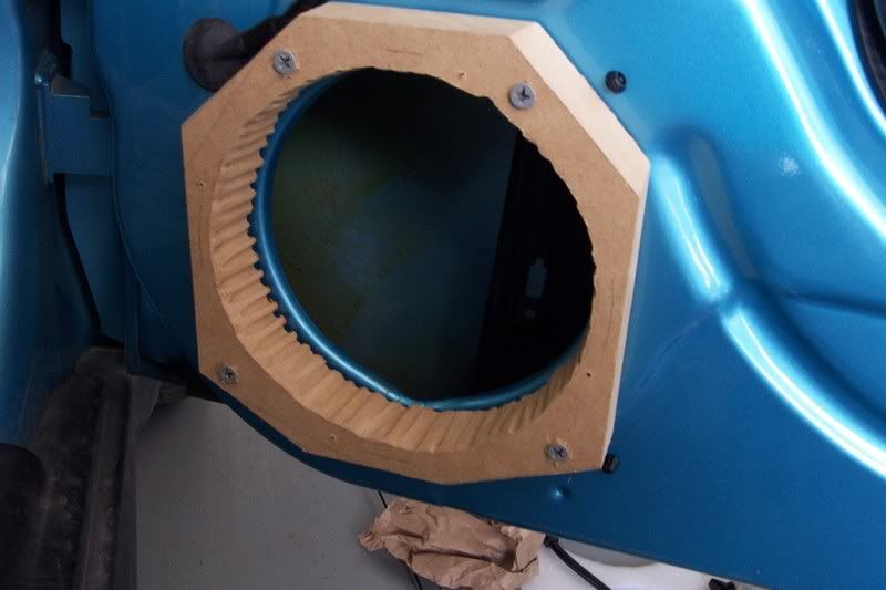

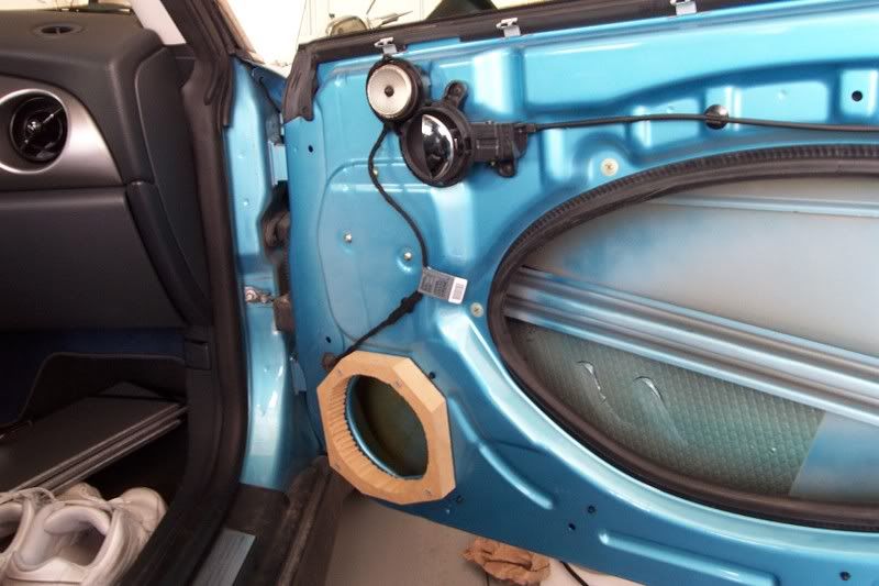

Install the adapter/mount:
It does not need to be really neat, the speaker baffel fits into it just fine.
I didn't get any shots of the crossover install, but they are stuck to the inside of the door with super sticky 2 sided tape. The window clears the crossover and the wiring.

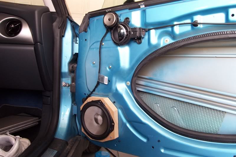

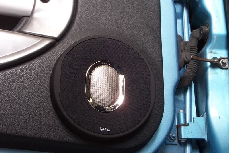

here are the speakers in:

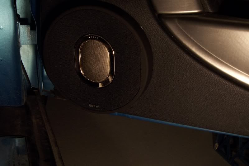

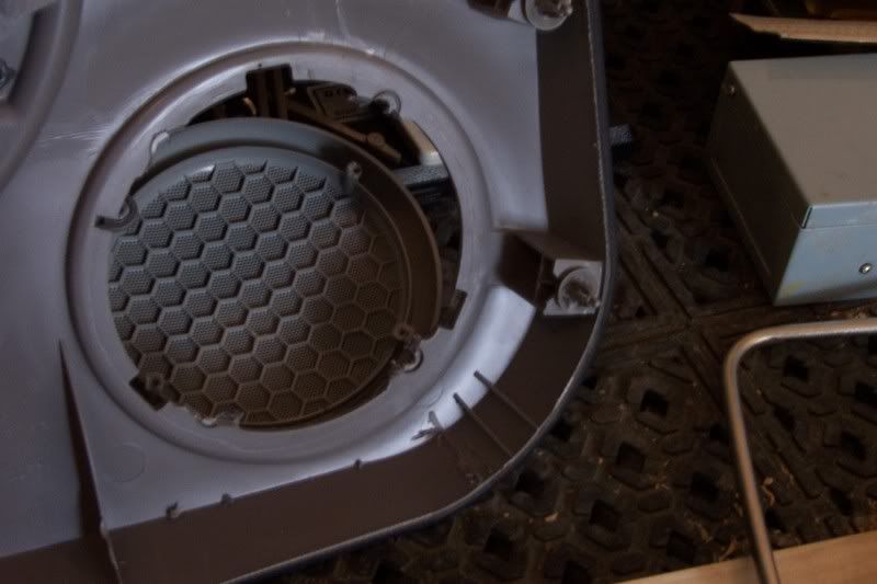

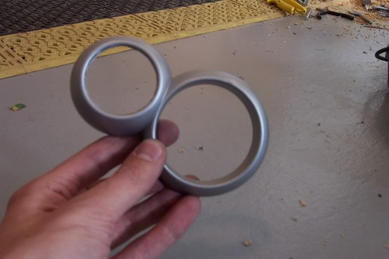

When I tried test fitting the panel, on this side and the driver's, it became apparent that I could not keep the stock covers.
I had to dremel them out and use a coping saw to cut larger circles.
Here is the new larger hole, and another shot of my soon to be famous coping saw.

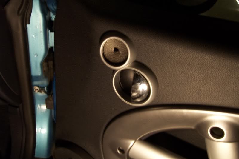

The new tweeters were also considerably larger, but they fit in the stock bracket. However, they stuck out and the grill had to be trimmed away.
You are looking at over 2.5 hours of hand work with an exacto knife:
And the final product, sorry for the bad lighting, I'll get better shots out in the sun later.
I mounted the new grills with 2 sided tape for now, untill I find a better way, or get some black 2 sided tape and spend the time to mount tape around the entire ring.
The sound is amazing. Very clear. I had to tweak all the stereo settings. With the crossovers, the bass up front is almost gone. I might have to get that Infinity BassLink to compensate. The stock deck had no trouble playing these speakers.
