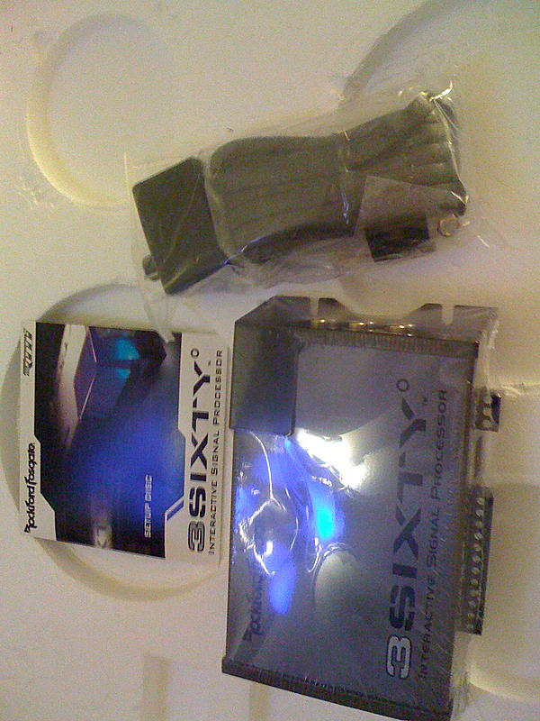

I have chosen the Focal Polyglass 165 vr3 3pc component set .
I will be removing the rear speakers.
And will be using a rockford fosgate three sixty interactive signal processor.
I need to know if by using the rockfordfosgate 360, will I still have to use a JL Clean Sweep?
And these are the amps that I've chosen. Small but powerful... Can someone tell me what 4/3/2 means in laymans terms? If I'm correct, I should be able to use the base line amp for the 6 speakers at the front of the car. Right>?

4/3/2 means channel setup - four channel, three channel or two channel. You can bridge the front and rear channels for more power. 100x4, 100x2+300x1 or 300x2 for example.
That Focal set appears to be a three way, meaning the amp sees it like a normal pair, so two channels can be used. Are you running a subwoofer? or the rear speakers? If a sub, I'd run the front channels to the Focals, teh rear bridged to a sub and the stock 6x9's leave alone.
the RF 360 takes teh place of the JL CS.
