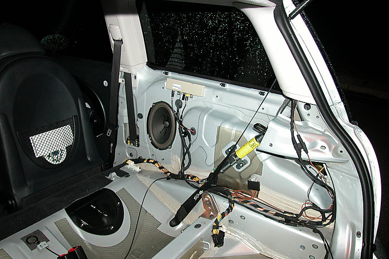

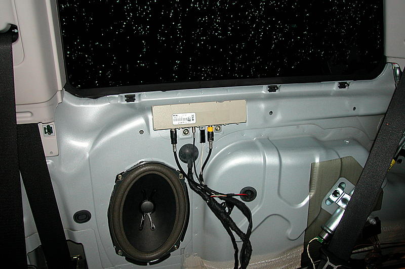

My hk amp is toasted and upon gutting the rear half of my car I found this...anyone have any idea what it is? also a side note if anyone has a h/k for sale im in the market so it seems

antenna amplifier
here's the diagram
http://www.realoem.com/bmw/showparts...08&hg=65&fg=30

Originally Posted by the_miniscule
antenna amplifier
here's the diagram
So its for the raido im assuming, Ive seen other minis with out it. keep in mind I dont have the nav nor the sat raido systems...

Originally Posted by MaxMini81
Phantom, I dont have satellite radio, or nave either... but i have that thing... I dunno what to tell ya. Mayber the year? or MC vs MCS?
BMW's have the same thing. Its the Antenna Amplifier along with the selector. The rear window heater is also an antenna. That litle box gets the signal from both and decides which is better, of course thats saying your not using the rear window defroster.
And the year determines where it is.
