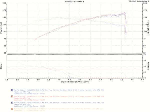

sorry for taking so long. i'm have some issues being delt with at the dealership so my car is unavailable for further dyno work.. here is the lastest dyno.. it shows very rich conditions with the turner file installed. i'm thinking it programmed for a reduction pully more than a stock one. i actually lost power on the dyno because of the rich conditions. i went ahead and reloaded the orginal file back(dinan).. it truely has made the difference.. the car feels like it should with the header installed. i havent had the chance to re dyno the car with the dinan/header combo.. i will as soon as i can. or if MTH guys hurry up and give me i properly tuned file i get it dynoed again asap... needless to say this dyno is not what i was looking for. but, there is hope at the end of the tunnel....(lean me out, man!)
dinan program with my other mods minus the header got me 172hp.. the most i reicieved with the tuner/header combo is 168.. not good..
i'm working with MTH to tune my car further.. i will post update dynos when i can..
peace

hope u get it werked out w/MTH =0)
NO KIDDING on rich, huh? Holy!!!! Ok, well, it's their header and they write the software, both of which are NOT cheap, so they better make good by you. I am sorry to see, but you've very well hit the nail....that's richer than...a stock MCS [lol!] .

indeed.. .. i might end up with a pully mod after all..

what were u running to get 172 WHP to begin with? just an alta cai and miltek catback?

i was runing 91 octane, miltek cat-back, alta intake(stock hose) and dinan stage 3 programing.. it worked well... i imagine with the dinan prgramiing and mth header i'm up there at 180hp or more..(butt dyno says so) hopefully with the new files i'll get even more...
i have the new files.. i'm just waiting for the car..

hey guys, just to let you know. i've have the new leaned out mth header file necessary to produce maximum gains on the dyno.. so, hopfully by saturday you'll see the result you and i been waiting for... "come on, 200!"
