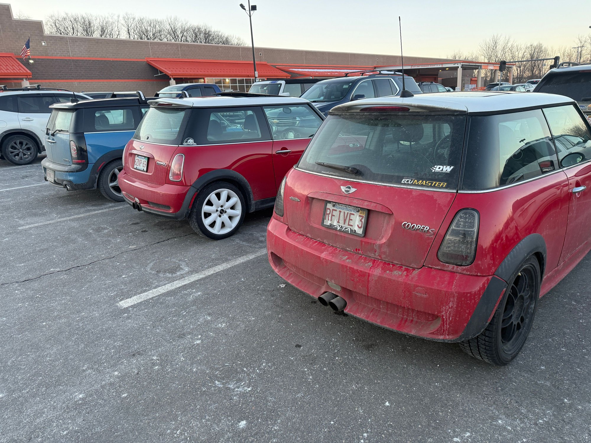

Went to Home Depot and parked next to another r53. Extremely rare to see in my area! This was a pre-LCI car with a rear wiper delete and a Malian exhaust. I came and left before the owner showed up sadly.
Out and about! How's it running with the tune update you posted about?

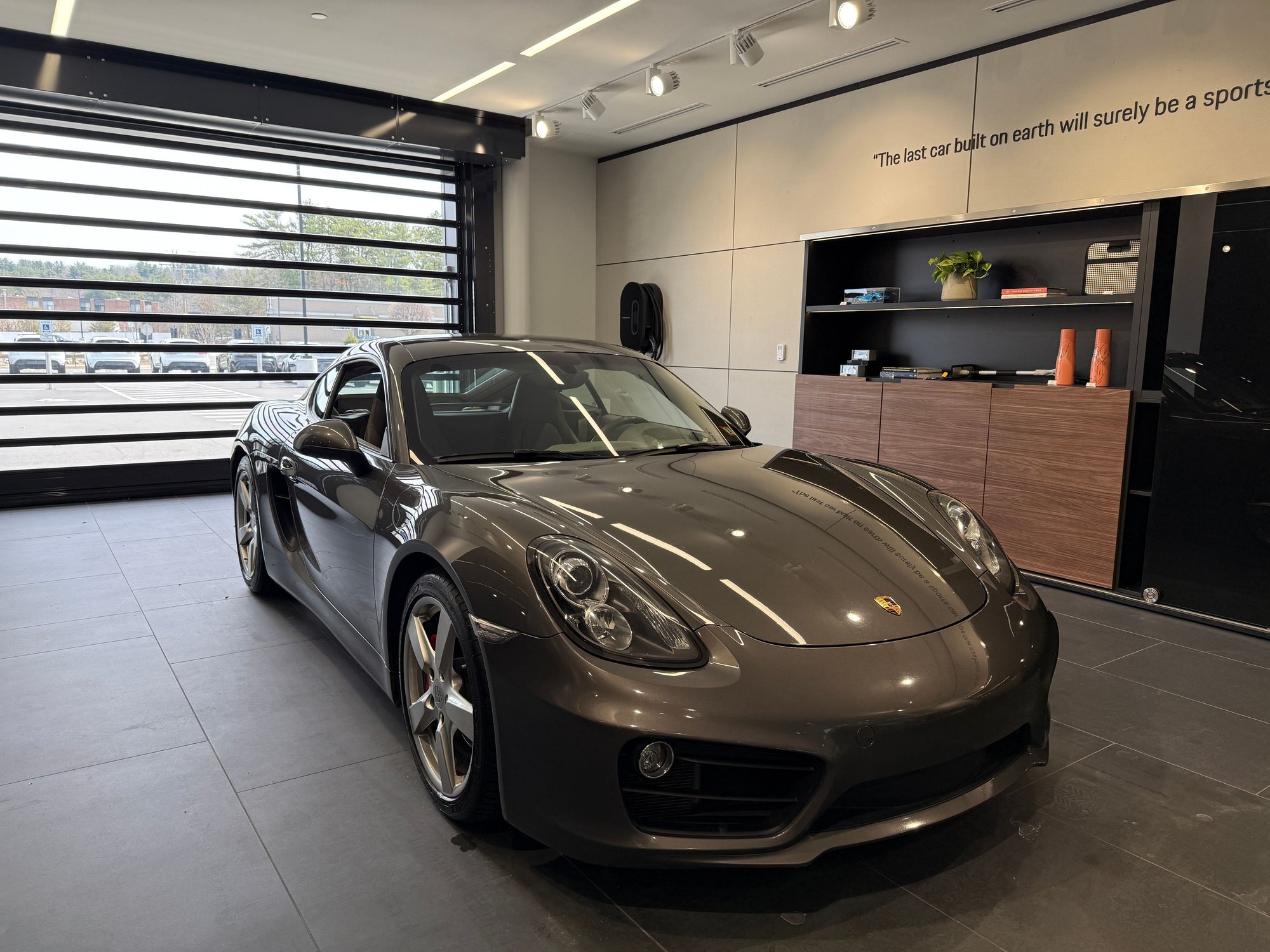

Also my other car was a 2019 Mustang GT, in large part due to the way my r53 drives I decided I didn’t wanna drive a GT car any more.
I sold the Mustang and bought this very clean 2014 Porsche Cayman S PDK. I guess I’m fully a German car guy now
Sehr gut!
Not sure I understand your rationale for switching cars, but I do understand your purchase. Congrats on the Cayman. The people I know who have them think that they are one of the best cars on the road.

Yeah its definitely not the most obvious line of thinking. Really what happened was the mini taught me that i value handling far more than straight line speed. The mustang does not prioritize handling in any significant way, I was having more fun driving my clapped out mini on bad weather days than i was in my "flagship" GT car on nice days. I was out one night on some fun backroads in the mini and the reality that a car that I'm into for under 10k was making me happier than a car that i had spent years saving up for became very very real all at once. That was when the decision was officially made.
This all started a few months prior when my two brothers and I did a mountain run, I took my mustang and one of my brothers took my Mini. He was eating me alive on corners, places where I had to slow down or risk flying off a cliff he effortlessly handled in my mini. I was fighting underster, and oversteer the whole ride. Sure i could waste him in a straight line but that just isn't exciting for me. That was all before the rear end refresh on the mini too, it was eye opening how much higher the ceiling goes. I found myself wanting that performance.
I came very VERY close to getting a new GR86 manual, but the motor is just so sad in that car. The intoxicating howl of the boxer 6 in the cayman, combined with the effortless handling from the mid engine mount sold me. I fell in love on the test drive. I love my mini, i truly do, its just such a good car. I wish something like this still existed new today.
