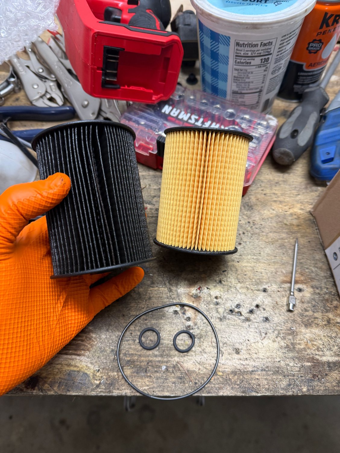

Fuel filter
Can’t believe I forgot to post this. I finally changed the fuel filter, 148k miles and likely original. Totally full of sludge replaced with all genuine mini parts because I don’t like to be questioning my fuel system. I think I will replace the pump too, it makes quite a bit of noise.
I don’t need to state which one is the new part I think it’s obvious
I wonder how many extra PSI you picked up that the fuel pressure regulator now has to regulate....

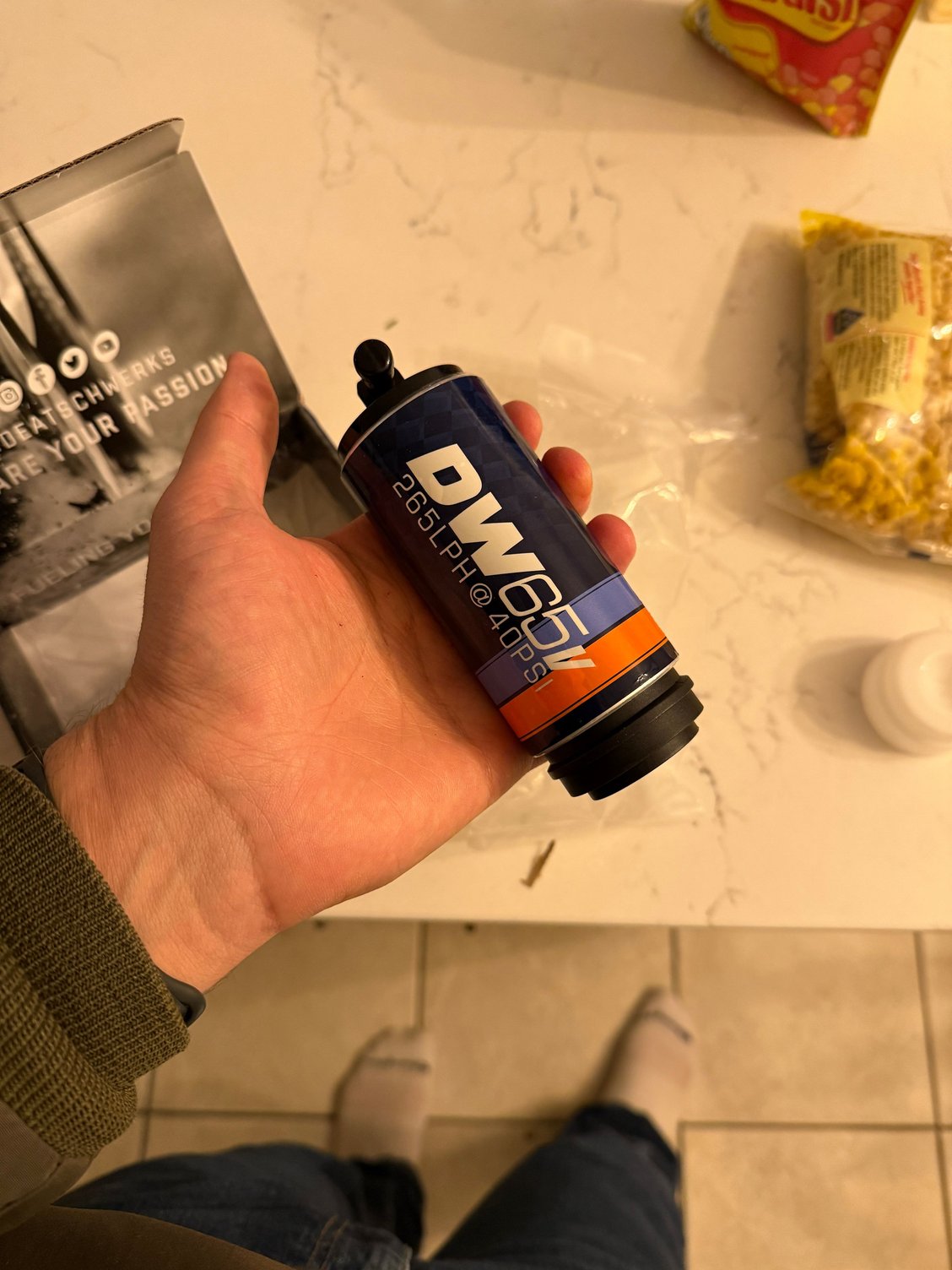

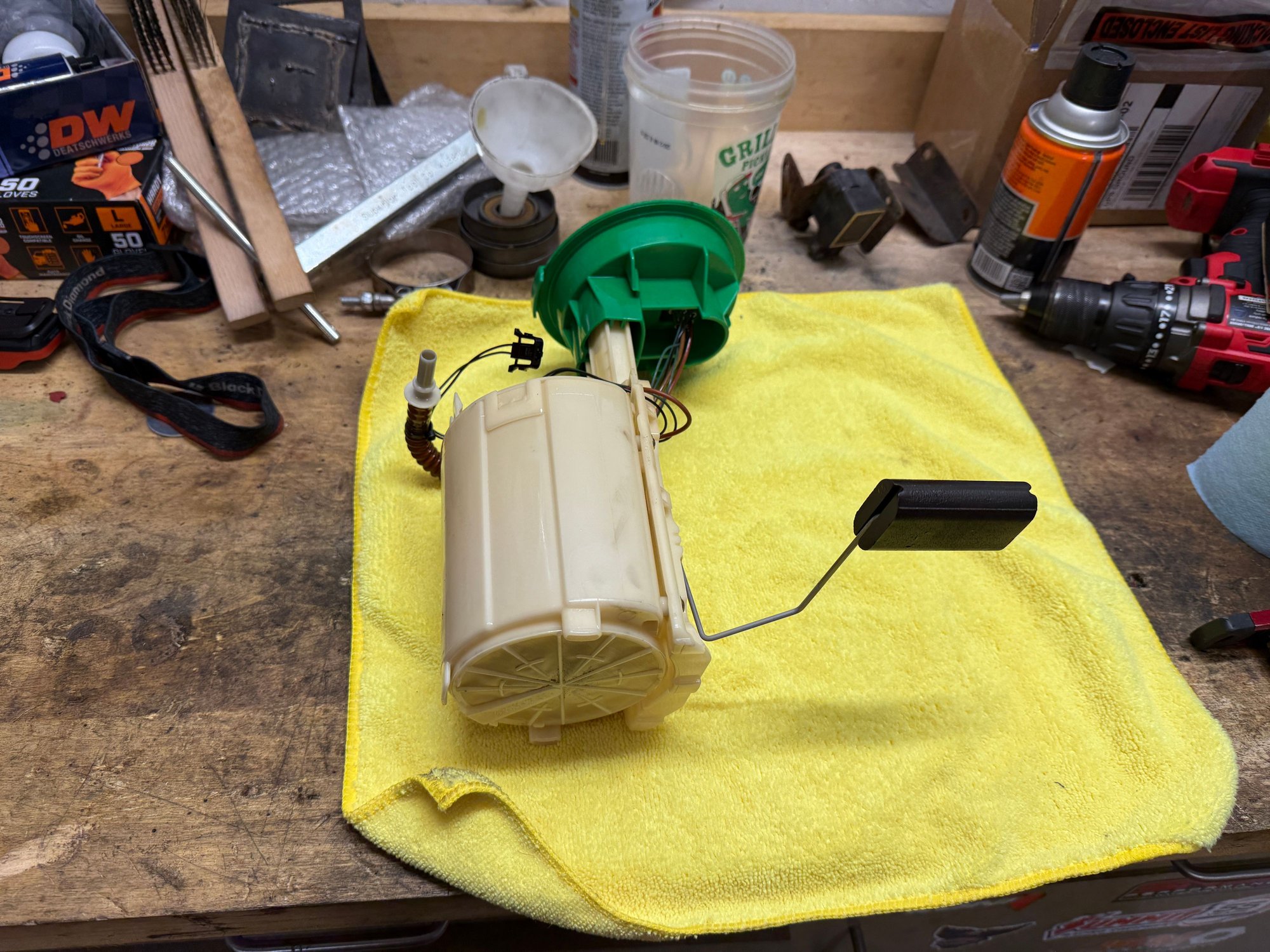

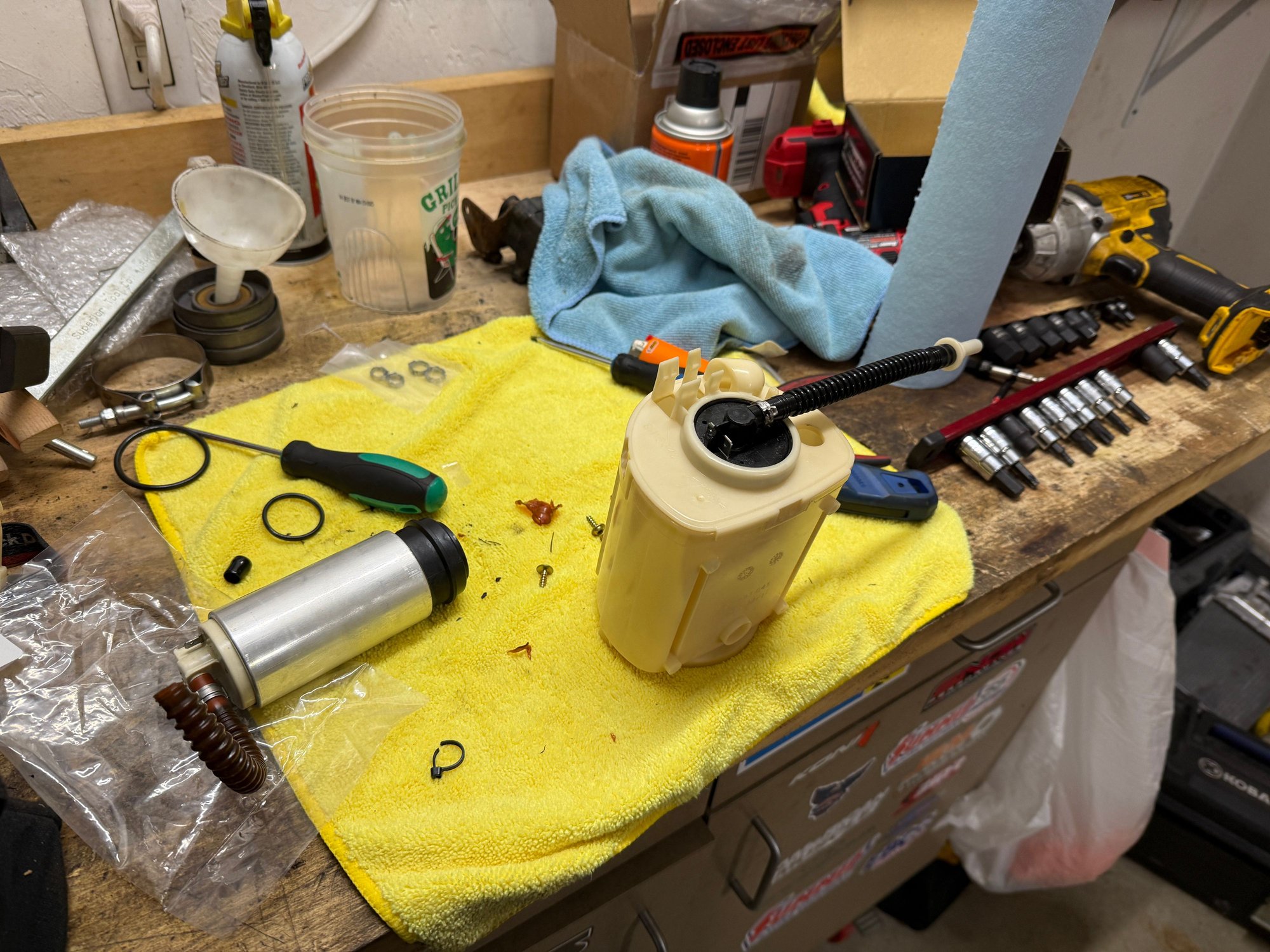

Fuel pump
My original fuel pump was quite noisy, I don’t know it’s that’s normal or not but I don’t like it and after nearly 150k miles I felt it prudent to replace it. Since this car is trending towards more and more power I opted to go for an upgrade.
enter: Deatschwerks 65v 265 lph drop in fuel pump.
new pump
basket and original pump removed form the car
new pump installed in basket
Level sender and wiring re-attached.
it fits really nice, it is ever so slightly shorter than the original pump so it wasn’t fully snug in the basket. I’m sure it would have been fine but I added a second o-ring on the top just to force it down and keep it snuggly in place. I also peeled off the shrink-wrapped label on the pump that you see in the first pic. I couldn’t 100% verify that it was fuel compatible and if the intention was for it to be removed or not. So out of an abundance of caution, I removed it. It means the pump is now just a nondescript silver tube and is not immediately identifiable as upgraded, but I don’t care about that.
much quieter too, fueling behavior is 100% identical on logs so that tells me the regulator has no trouble handing the added fuel flow.
i think it’s a great upgrade, with this and the 550cc injectors I’m e85 ready not that I’ll likely ever do that, the WMI kit will provide nearly the same gains, but if I ever go to a better SC or a built engine the fuel system is already ready to go.
