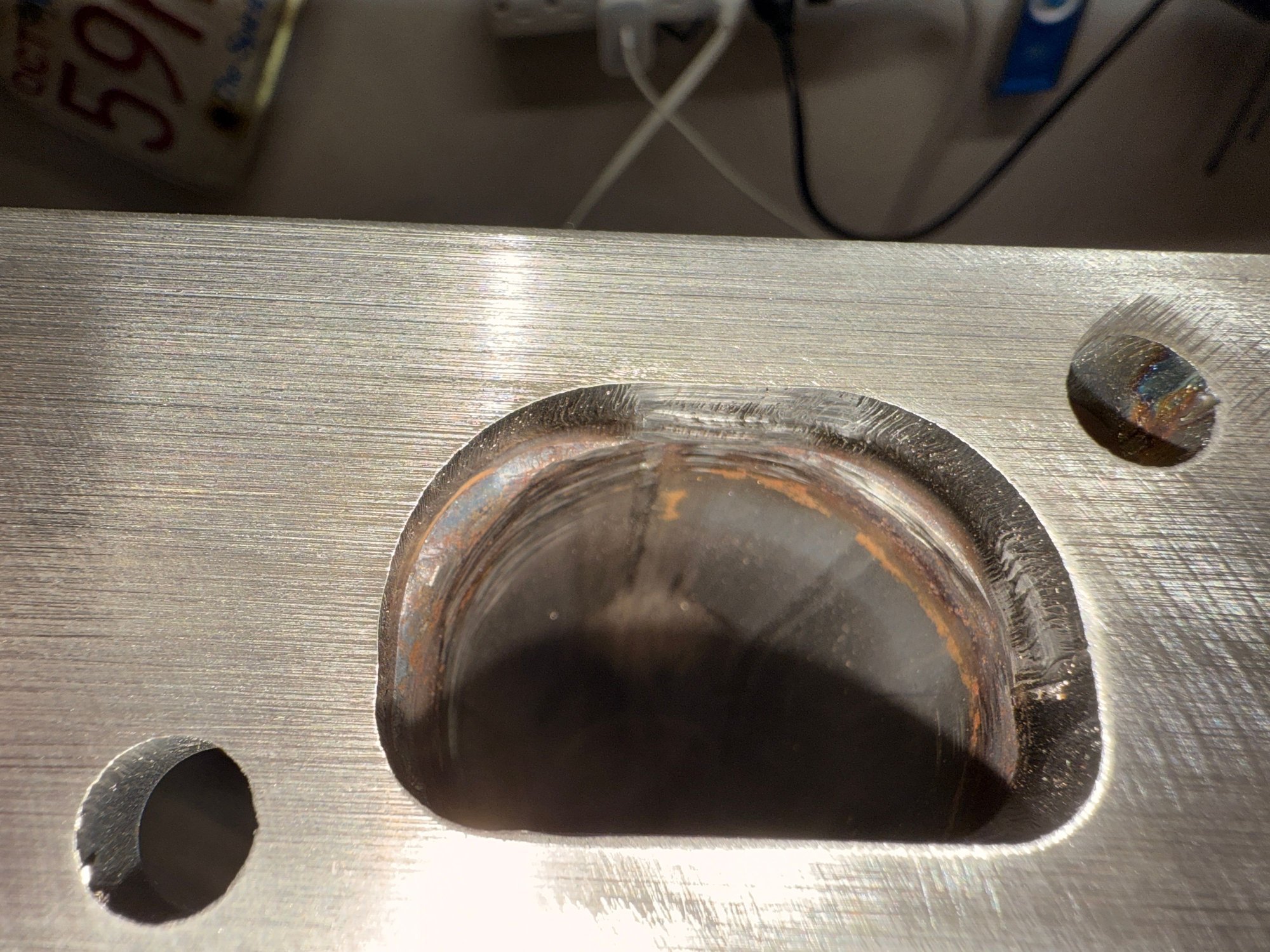

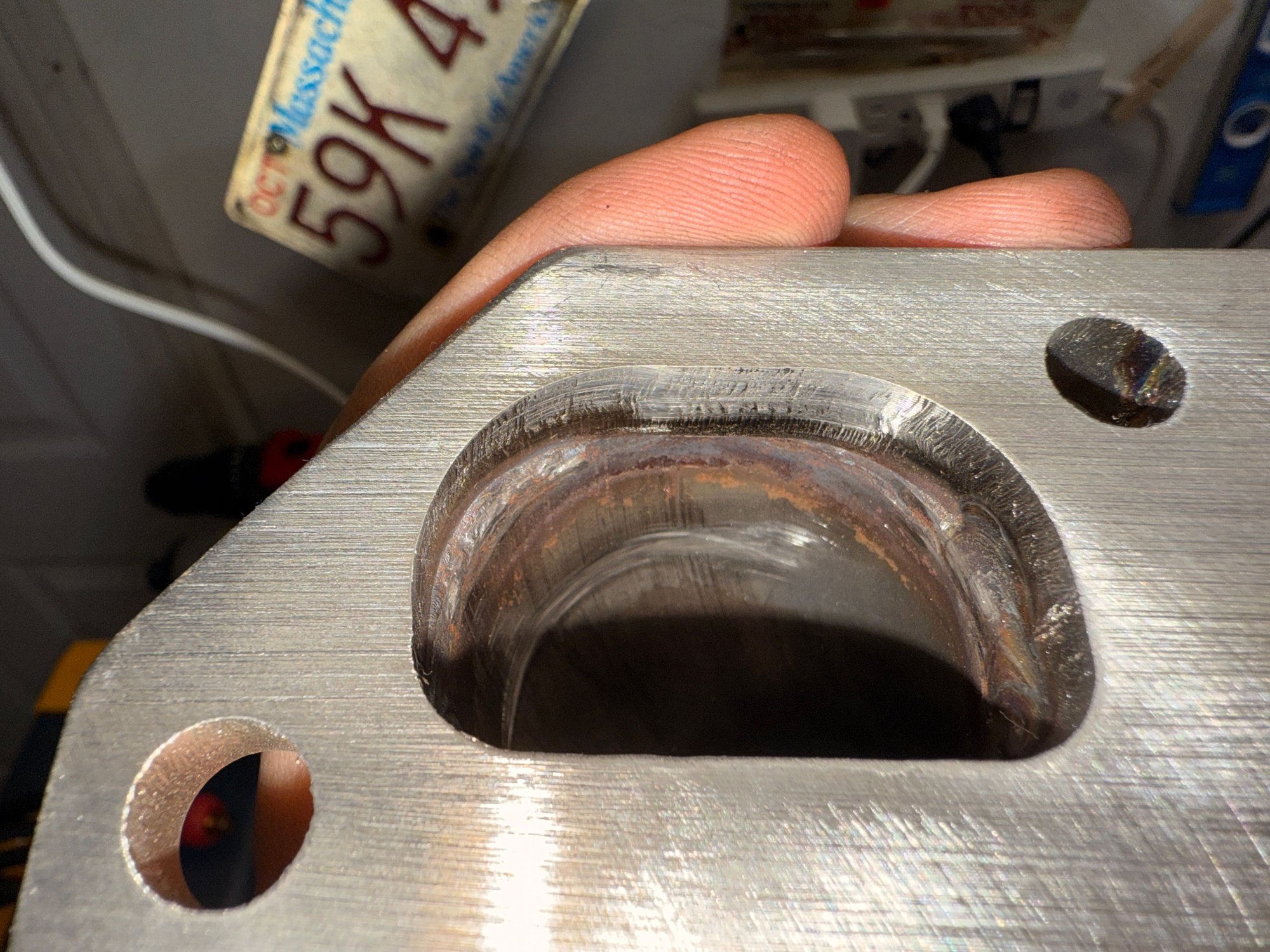

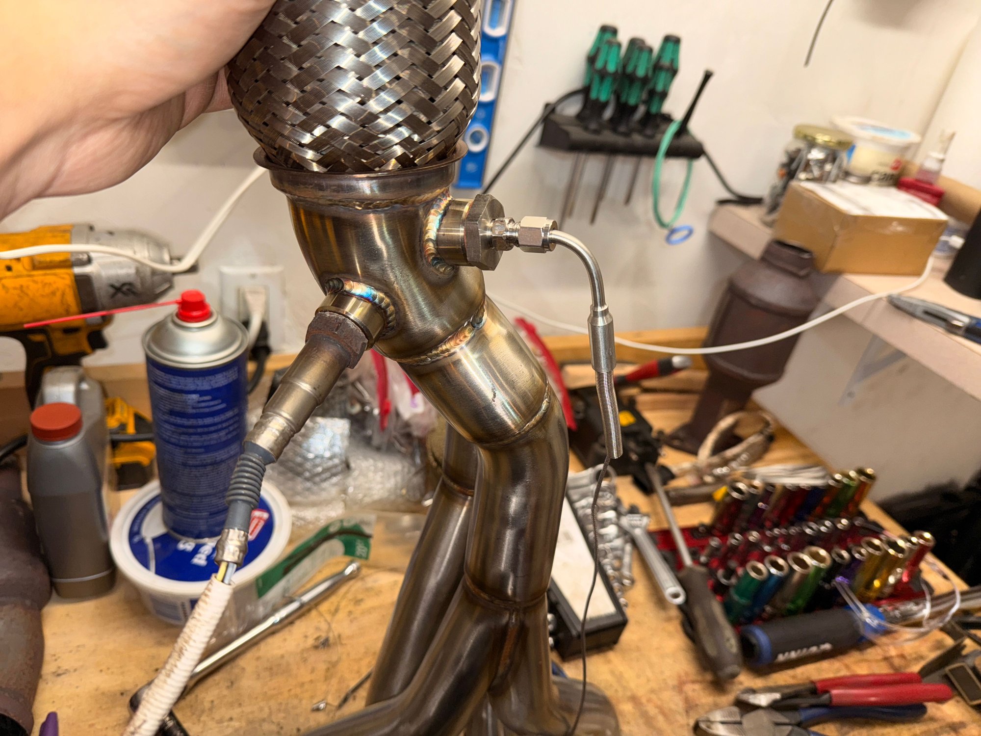

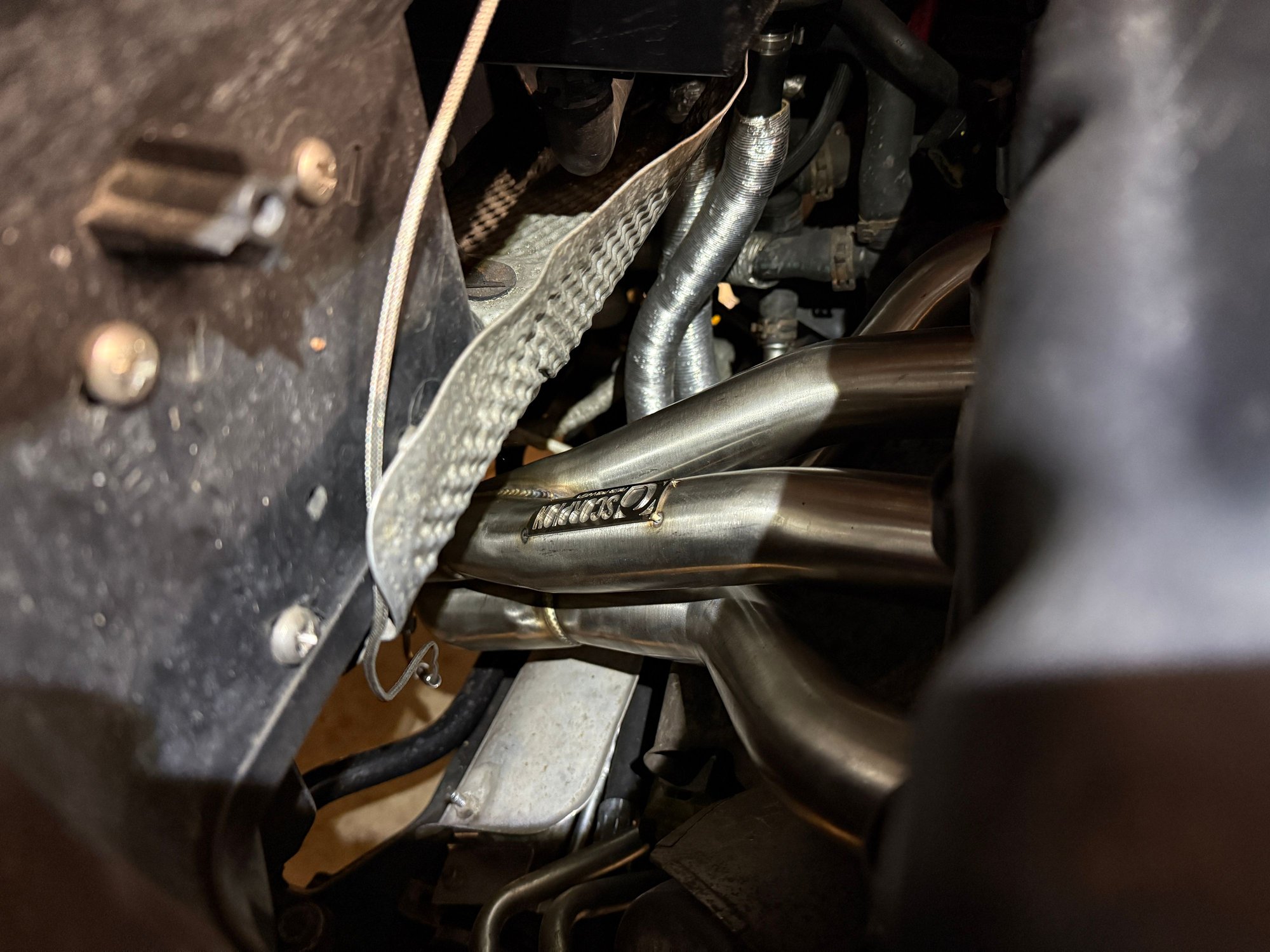

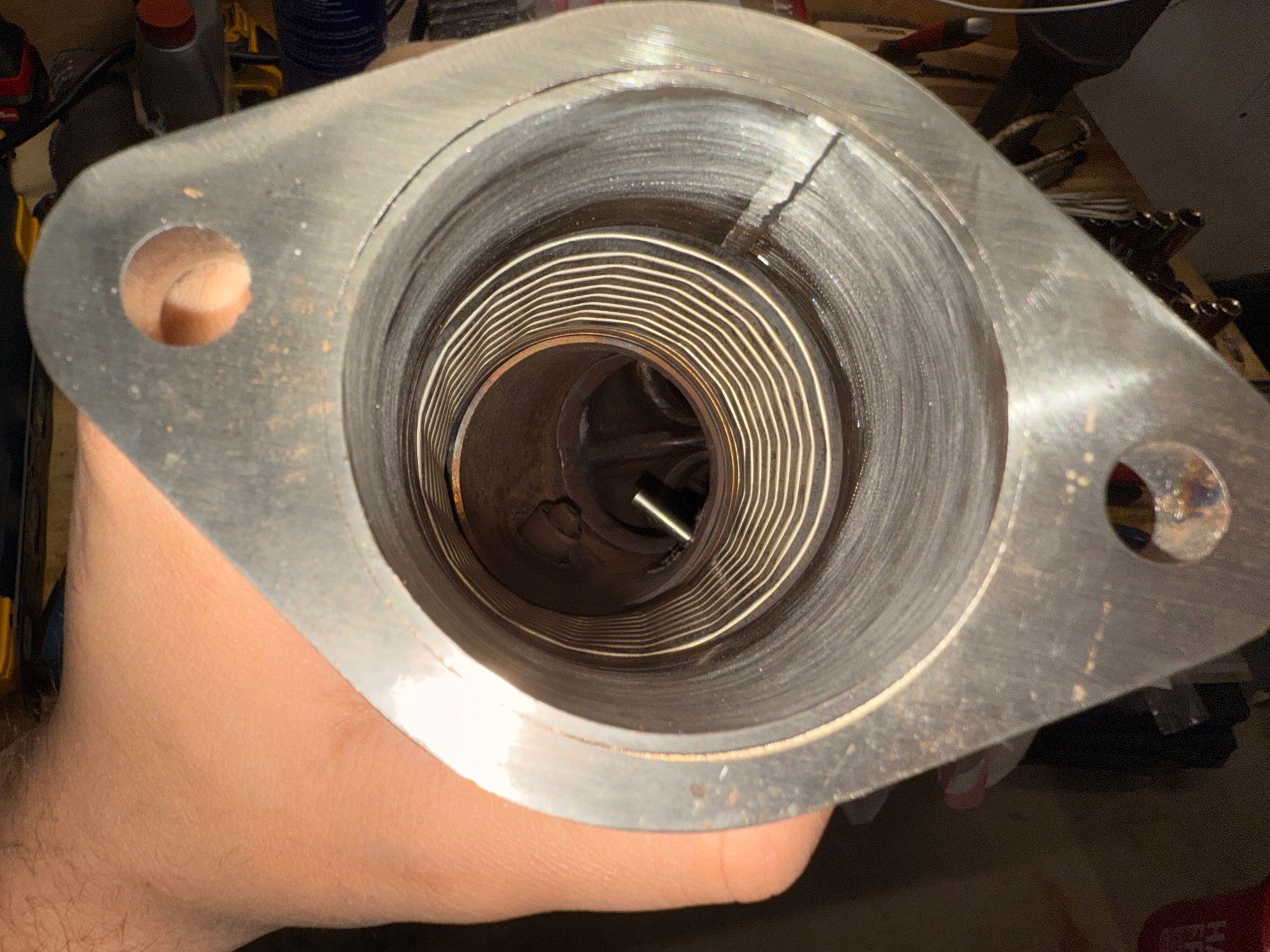

Welp it was bound to happen eventually!
My super cheap $100 header has developed a leak, time to replace it. Torn between spending the money for a nice scorpion header with a cat ($1000) or taking a risk on a chinese 4-2-1 header with a cat ($500)
the scorpion is a known quantity, but its really pricy. The Chinese one is literally half the price, but comes with the risk of it being junk and a longer delivery time. I have inspection due by the end of November, exhaust leaks will cause me to fail so I have a little time to decide but need to make the choice this weekend.
China special
Scorpion
Hmmmm....

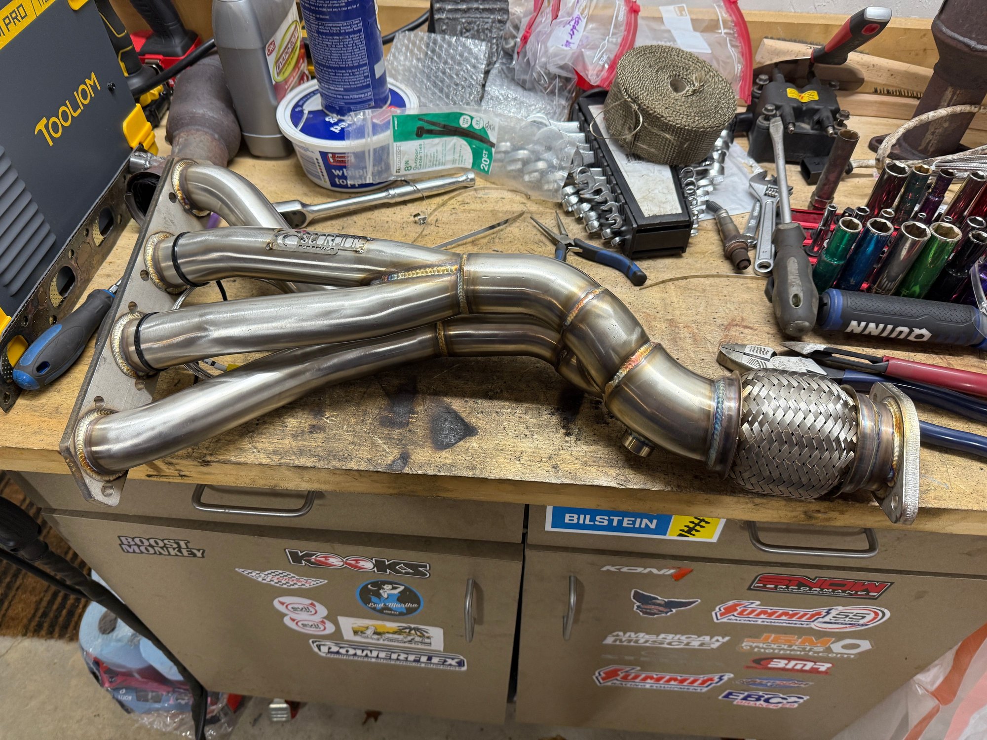

SO more research...
The China 421 is $568 after tax, tariff, and shipping. The header itself is $250, so I really need to think of it as a $250 header and understand that's the quality I'm going to get but i have to pay $570~ for it.
The scorpion catless 421 is available form Orranje for ~$775 shipped from the UK, and that's $610 for the header itself and $175 for shipping. So in that case I'm paying $775 for a $610 header. That's a much higher quality part, comes with a warranty, made out of thick stainless steel, well designed with a flex that won't just crack.
Its $200 more for the Scorpion over the China header, its a no brainer to just spend a little extra to get that better part, I have an inquiry in with Orranje to see how much they want for shipping to the USA. I'm confident they will ship this product to the US because it is available from their eBay store with USA shipping. The only reason I'm not just ordering right off eBay is because i know eBay charges a fee, so I suspect I could get a slightly better price by ordering directly.
To note: Since my car is older than 15 years, I'm fully emissions exempt in my state, so there's no inspection related headache by going catless, I don't really like running without a cat but I do like saving $300. I still have my OEM cat and in the long term I will weld it back into the exhaust to kill the smell.

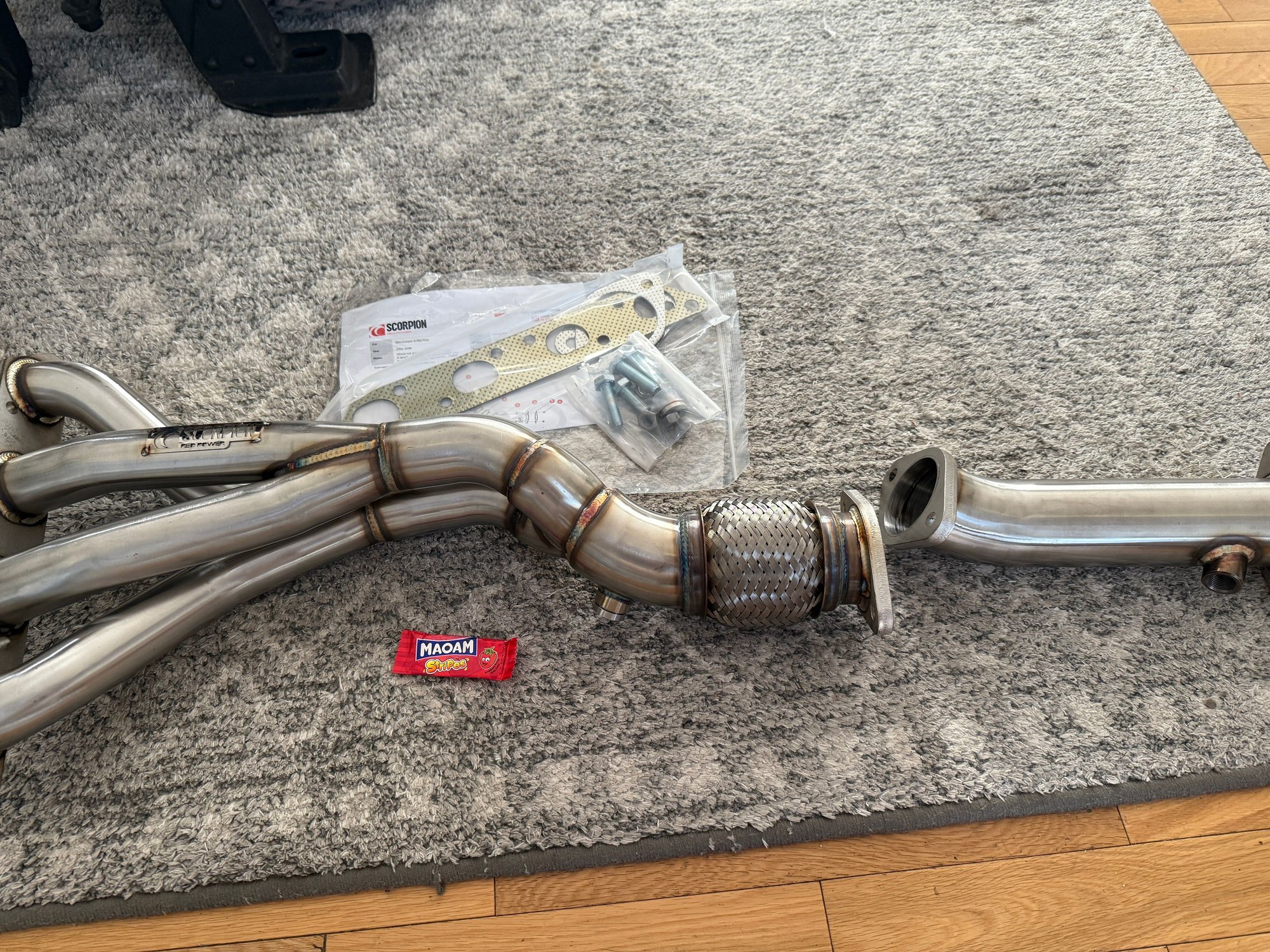

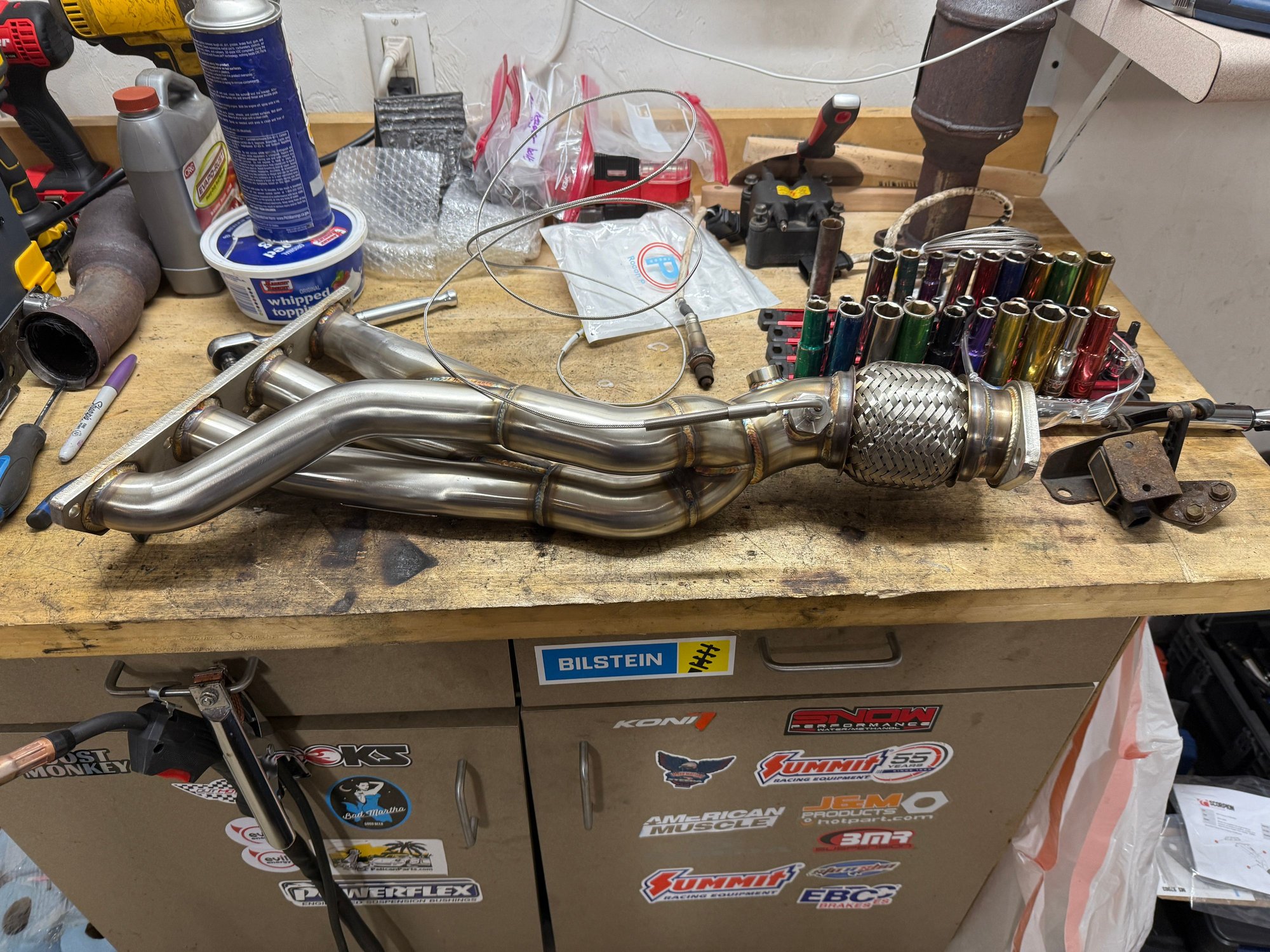

Order placed with Orranje, with Fedex shipping and VAT removed it came out to £496.67 ($651.56). Theres a %10 tarriff on the UK (Much better than the %100 on the Chinese header). So I expect to pay $65 tarriff and $40 MA sales tax when it hits the port. Bringing the total to ~$755.
And then this wont have to be replaced again I'm really curious how it will sound, I've heard the 4-2-1 design gives it a nice tone.

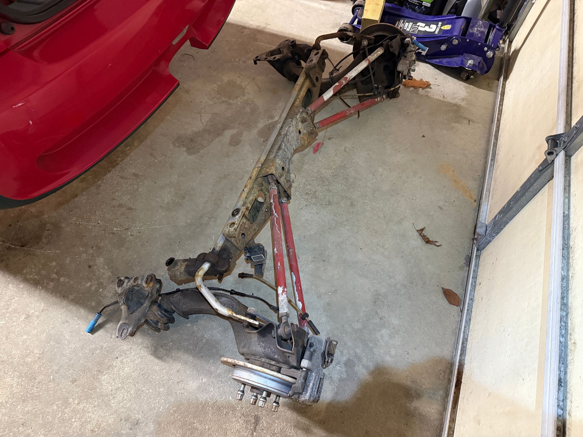

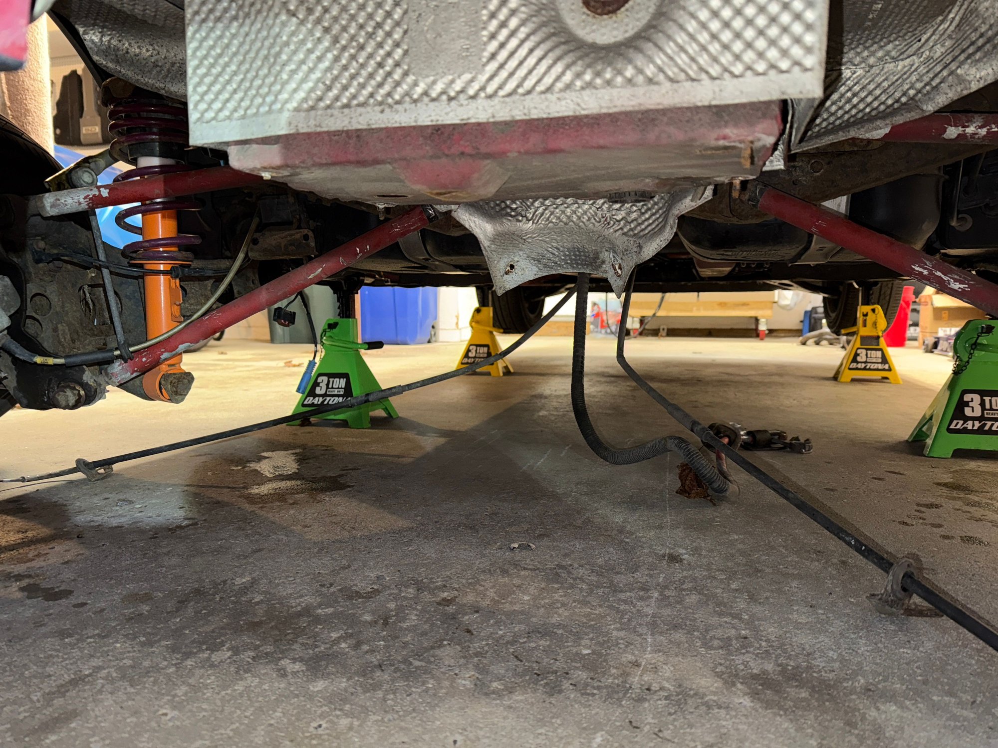

Update:

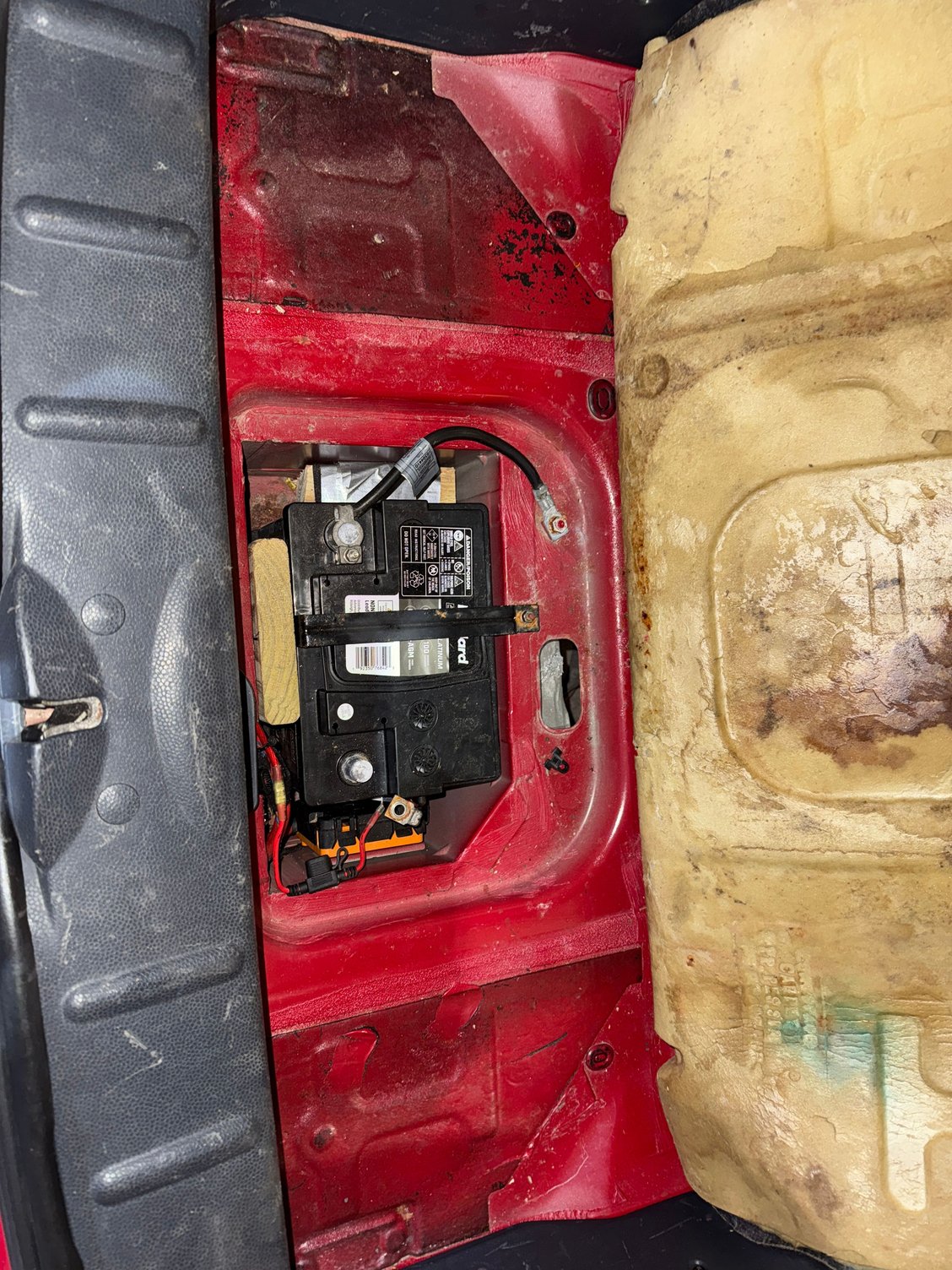

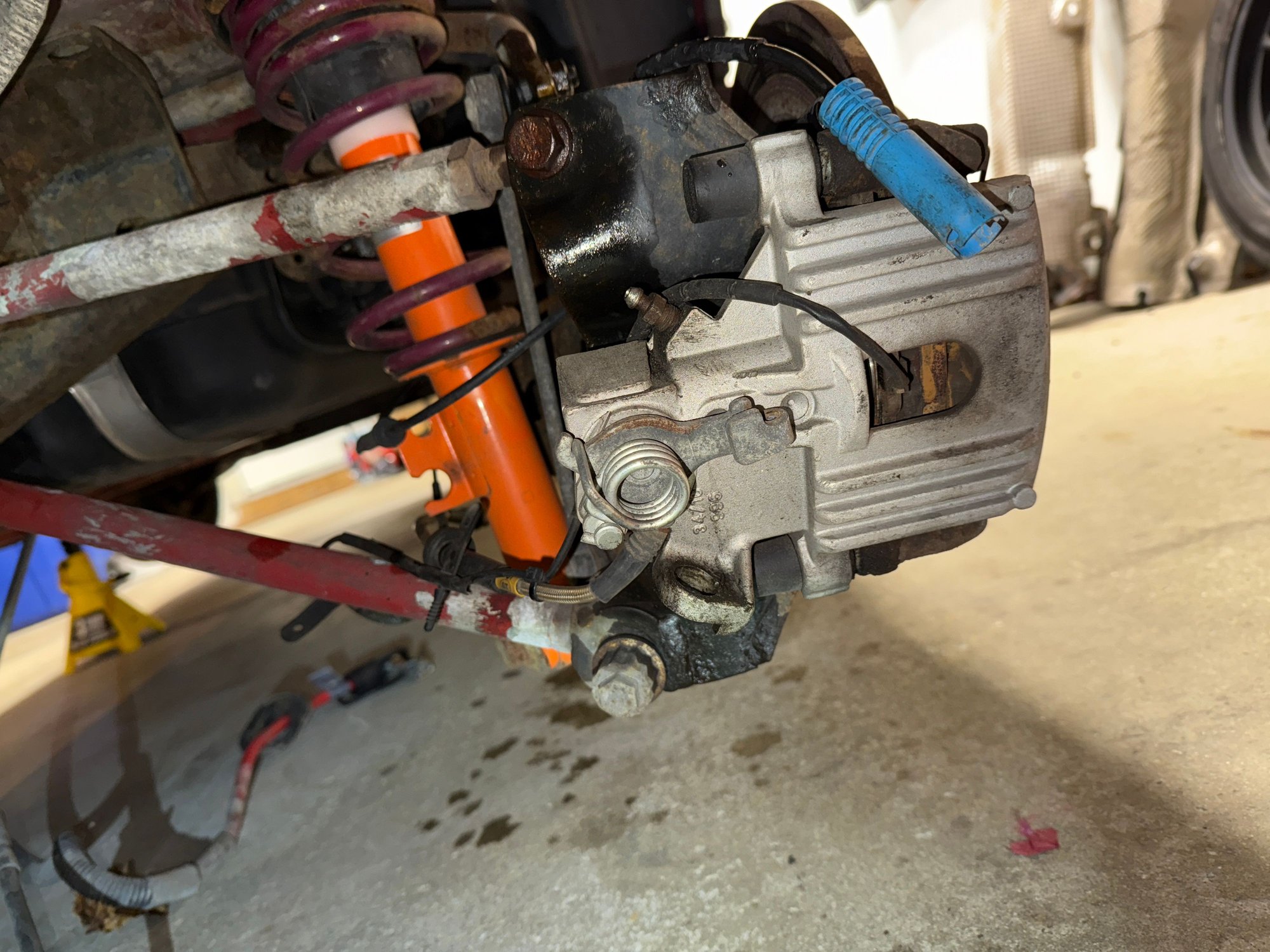

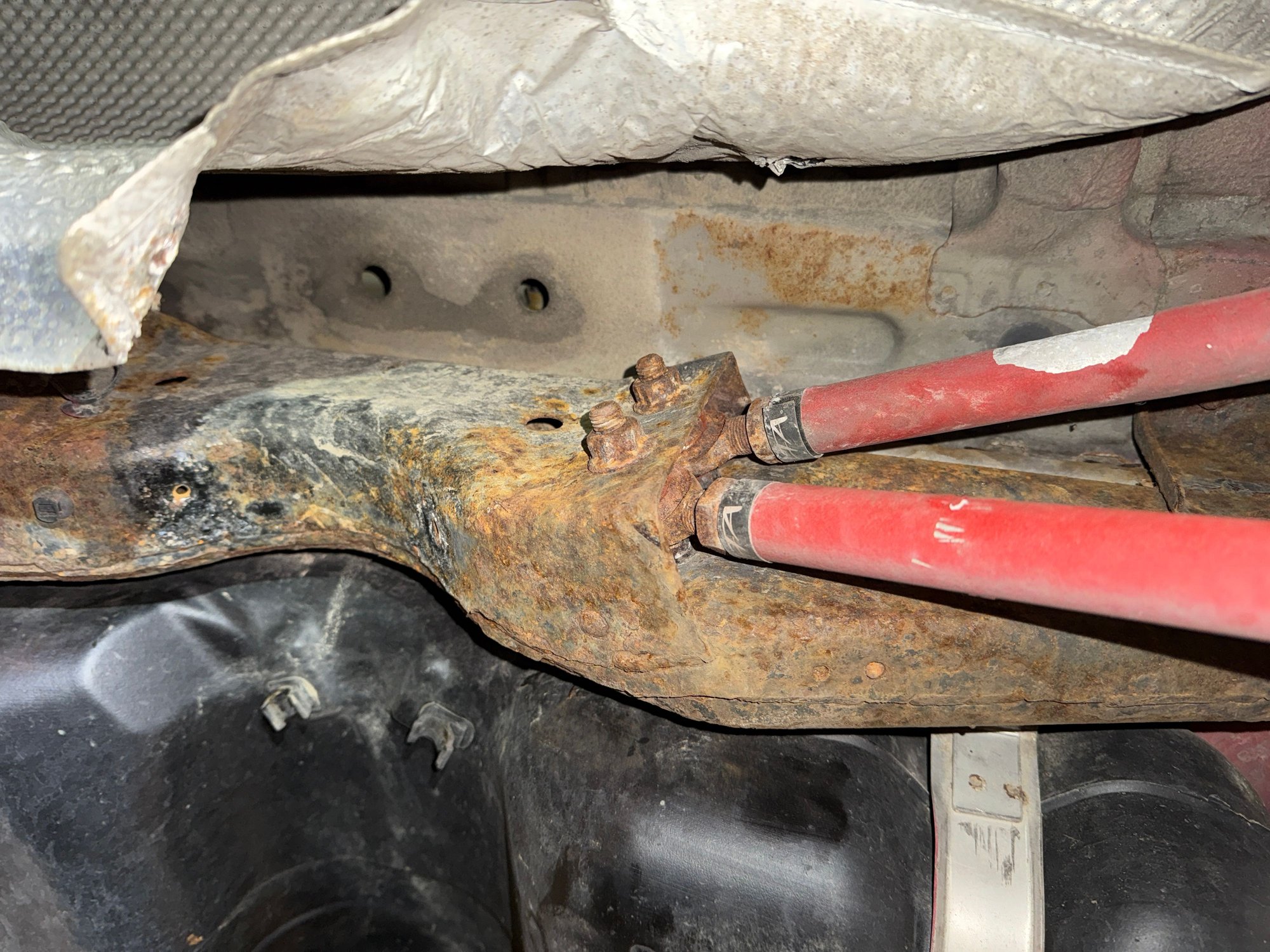

I've pulled the manifold, the exhaust, and rear heat shielding. I've detached the rear struts, rear trailing arm bushings, parking brake cables, rear brake lines, wheel speed sensors/wear sensor, and battery positive cable. Right now the only thing holding the rear subframe up are the mounting bolts. I'm planning to let it down tomorrow night after work. Need to figure out how to handle the gas tank straps, worried the tank is gonna fall when those are released.

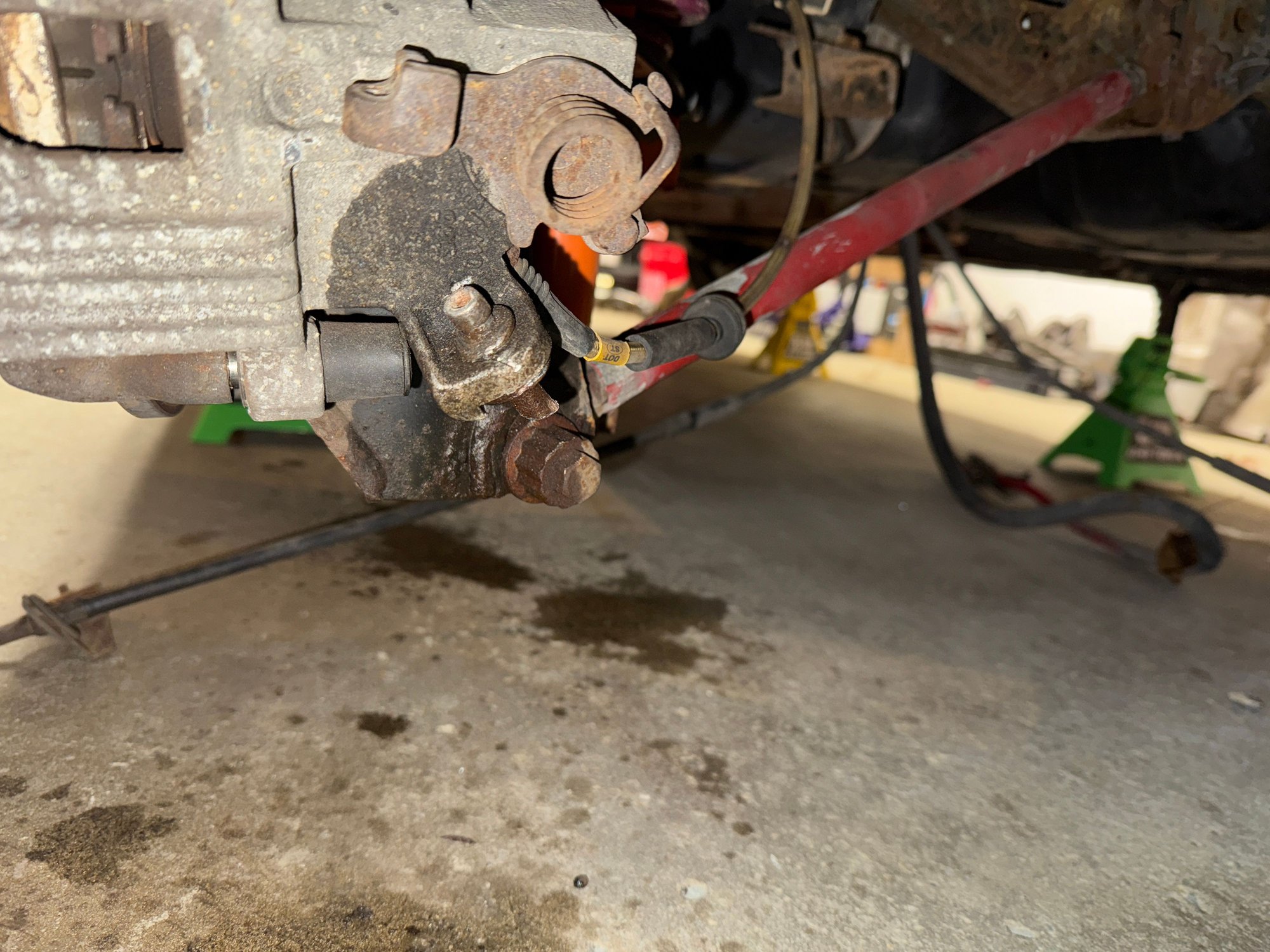

The driver side parking rake cable was so seized, I had no option but to cut it. I really tried to keep it, heat, PB blaster, a chisel and a mini sledge. Nothing, after seeing that a new OE part is only $30 I just cut it.
The subframe is very rusty, but doesn't appear to have any holes or compromised structure. I think now is the time to take care of this, I'll be having it sand blasted and then painted with epoxy paint. This should keep it in once piece for another two decades :D If I let this go I wouldn't be surprised if it failed within the next 2-3 years, the rust is progressing fast.

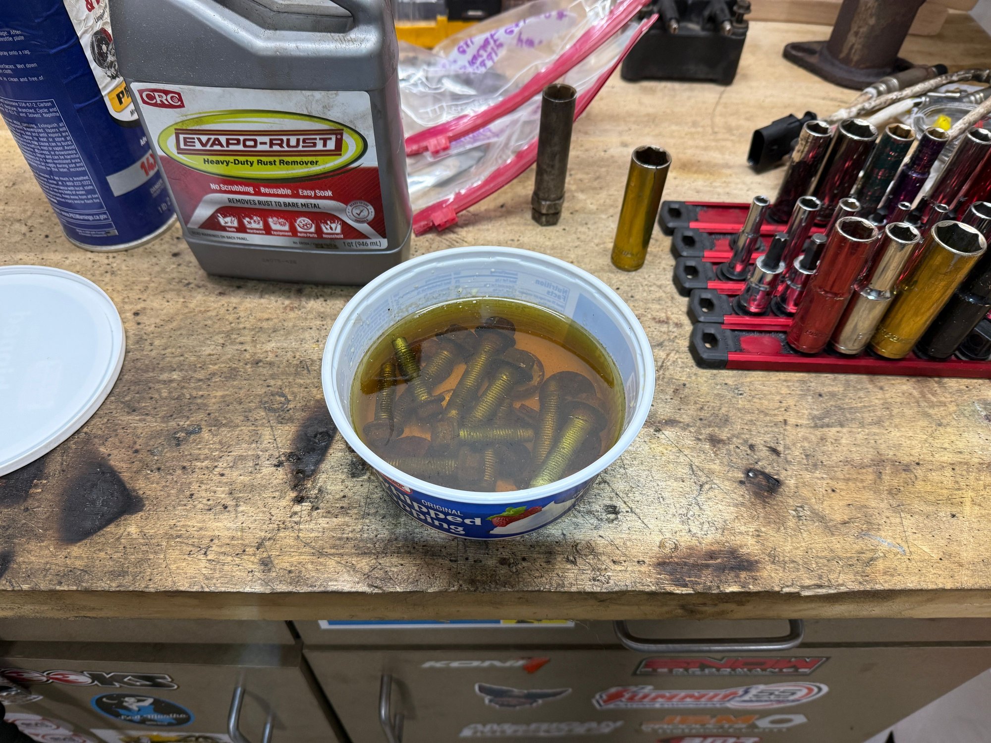

it’s a bit like working on the titanic back here, the front subframe was so oily it never rusted lol.
Rusty
Rusty
Crusty
Crusty
Seized solid
Seized solid
This side came out
This side came out
Parking cables and battery cable out
Bolt soup (evaporust)

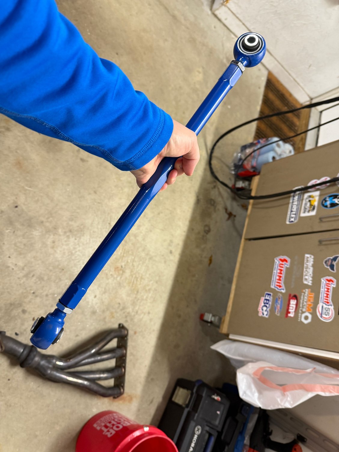

New shielded spherical bearing rear control arms

Header arrived, put it in the same day. I used the second spare O2 bung at the collector for an EGT probe. Will definitely help with tuning.
I had to bend the lower heat shield under the manifold above the coolant and power steering lines. Just a little bit, nothing crazy. The ports are nicely made and match up perfectly to the gasket, u like the Chinese one from before that was not even matched to the head let alone the gasket. That alone should make more power.
they included a haribo candy which was very delicious 😋
Cyl 4
Cyl 4
Cyl 3
Cyl 3
Cyl 2
Cyl 2
Cyl 1
Cyl 1
Decat pipe and hardware.
