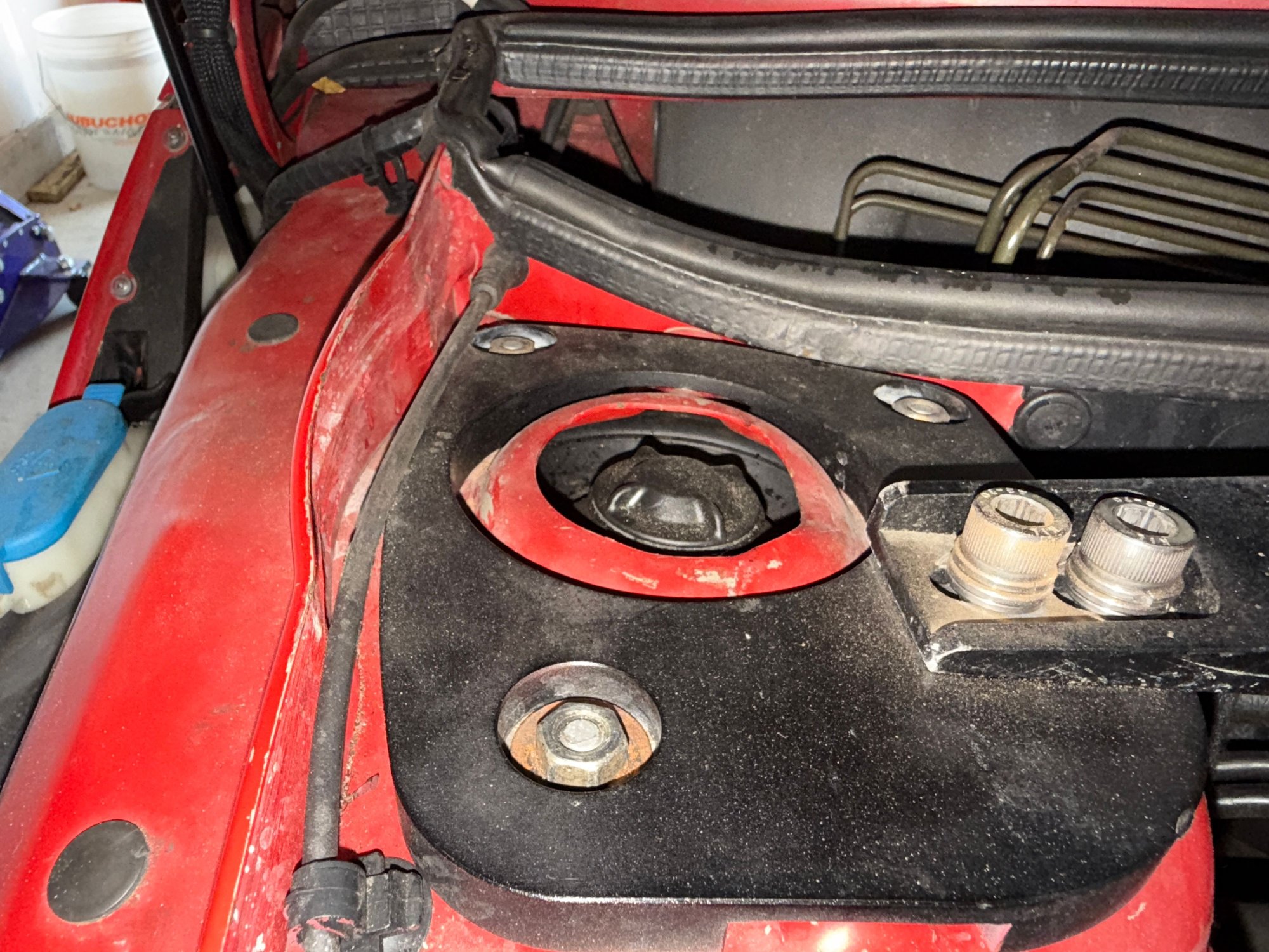

Interesting about the dead time. Nice going.
Do you know about the threads for the shocks in those control arms?
If not, here goes (If you know, then ignore this )
Those are not real threads. Those are cut by the self tapping bolts that they use during assembly. I would get replacement, real, bolts to do the shock assembly. Also the R56 shocks have a conical piece that fits into the trailing arm. If you are going to use your existing shocks you will need to get an adapter piece. I think Way Motors sells them. Only hand thread the bolt in, very carefully so as to not cause any damage to those threads. Even no hand tools until the bolt is well threaded in. A little never seize will help. Also, don’t over torque the bolts. MINI spec is for something like 120 - 130 ft-lbs. I believe that is for initial assembly when the bolt is cutting the treads. Upon reassembly that number should be much lower. I used the wheel bolt torque of 90 ft-lbs as those bolts are about the same size.
Interesting, I was not aware of that. A self tapping bolt is certainly an interesting choice by BMW, I can't say I'm a huge fan of that lol. When I pulled it off the junkyard car I didn't pay much attention, I just whizzed the bolt out and yanked it out of the car. Is there any reason not to run a tap through it to try and clean it up before re-assembly?
I was able to find the adapters at WMW, so thank you for that recommendation
Nope, I’m not a huge fan, either. Especially after having a friend dropped the rear of his MINI on the ground when, after changing the shocks, one of the MINI bolts tore out when he was on the highway…
With these the operative general instruction is to do nothing that could potentially cause damage or weaken the treads.
So, no, do not run a tap through. The threads that are there will be fine for threading a new bolt into. But like I said, hand thread a new bolt in, with a little lubricant (suggest: never seize). The lubricant will keep the aluminum from wearing and potentially galling with the bolt.

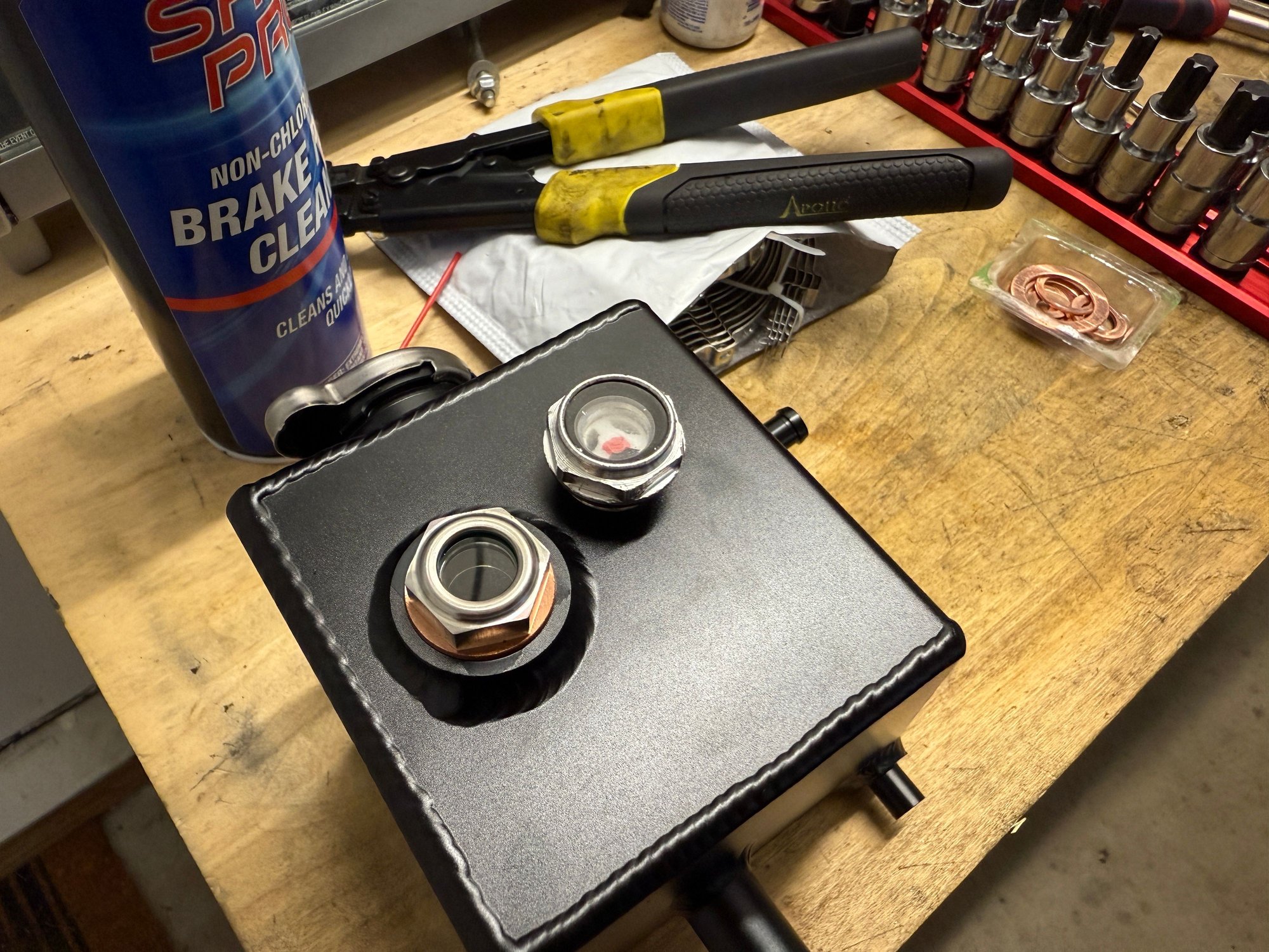

i bought this low cost coolant expansion tank from Amazon. $85 shipped, but it uses a very cheap plastic sight glass with a rubber seal. I replaced the sight glass with a better quality glass one for $14 and used a copper crush washer to seal it.
hoping to get this in this weekend potentially

Haven't updated this thread in a while:
Not a whole ton going on really though, I've got the tune pretty well dialed in, still have trouble with hot starts but that's next on my list of things to get to. I ended up turning up the timing a little bit, I'm running 20 degrees from about 3k-4.5k then ramping up to 24 degrees by redline. Car pulls pretty nicely without knock, I don't know if its MBT or not but it feels good and from what my research suggests its not anywhere near the maximum timing people run on these cars. I think for now, its a safe and good timing curve. Adding the WMI spray in keeps the IAT nice and cool and definitely makes the car pull harder.
The next step would be to find a dyno and spend some time dialing in the timing correctly for both93 and 93+WMI. Thats definitely a low priority item.
What I'm going to do next is try and get the hot start working better, the car will crank right up from cold but when its hot it turns over a lot before it finally kind of sputters to life. Tells me it isn't a hardware issue or else it would be happening all the time. Other than that the car's been really nice lately. Very well sorted, driving nicely, good handling, brakes feel good, no new coolant leaks. I'm very happy with it!

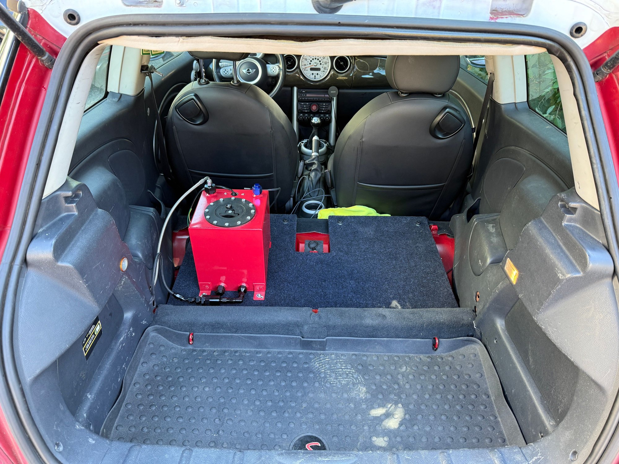

I did make this rear seat delete which is where i mounted the WMI tank and filter:
You can see I also added a vent line on the top, this keeps the harmful methanol fumes outside of the car. Especially on warm days there's no fumes at all in the cabin, methanol is easily detectable even in small quantities.

The rear seat delete is just a piece of plywood, cut into the right shape and covered in carpet. Its wedged under the factory seat hold-downs and then affixed to the front edge with M10 bolts and rivserts. Its completely removeable and rear seats can be re-installed if I ever desire. Its really nice, lets me really haul alot around in this tiny car. I recently used it to move a 15 gallon air compressor.

I can easily put 8’ 2x4s in our R50… For track events I have put 4 tires/wheels in the back of my R56. Ya, great little haulers.

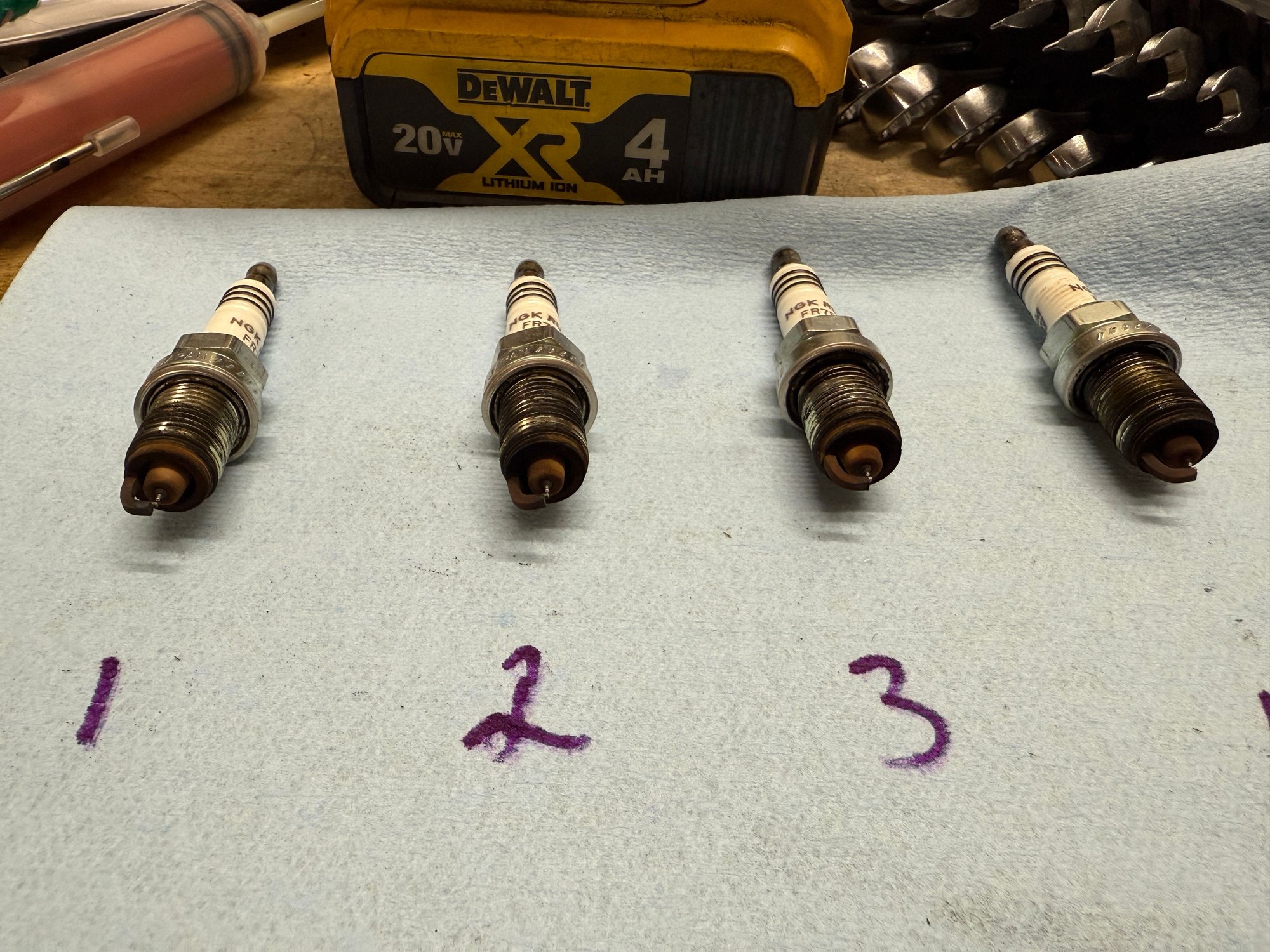

The Mini went out for an unexpected 180 mile stress test!
My two brothers and I like to a do a little western MA scenic drive around this time every year. Typically I take my S550 mustang, my brother takes his B8 A5, and my other brother takes hisF87 M2. Well as luck would have it, on his way to my house (our meet spot) my brothers charge pipe shattered in the M2. So in a very last minute decision, he took the Mini on the trip. This is 180 miles round trip with a good mix of high speed highway and curvy mountain roads. My brother was not easy on the car either, he was really enjoying the flat foot shift for most of the ride haha.
I'm happy to report the car did great! Pulled the plugs the next day and found they look really good too! No signs of spark knock, looks to be running a touch rich but nothing crazy at all. The WMI was on for the whole ride, he did report some stuttering/misfiring in low RPM high load scenarios. So the spray needs to be reduced in those areas as its obviously injecting too much water there.

Is this setup using the info from the GP spark tables to guide your tune's timing strategy? 🤔
