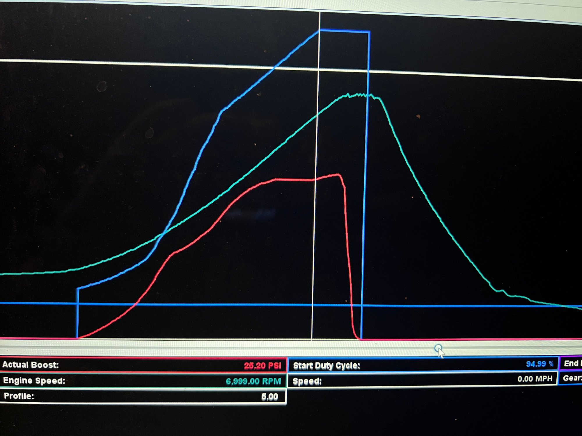

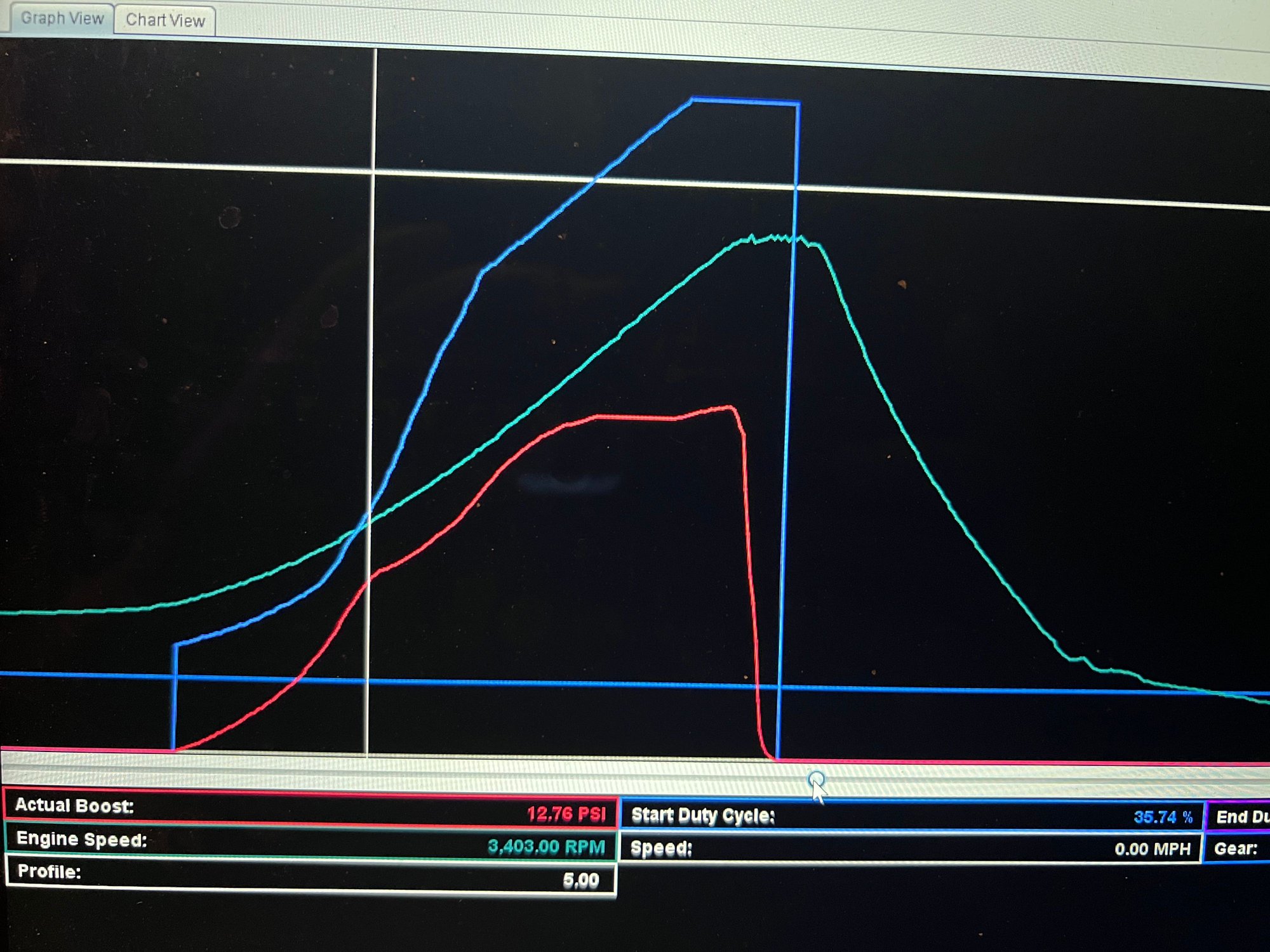

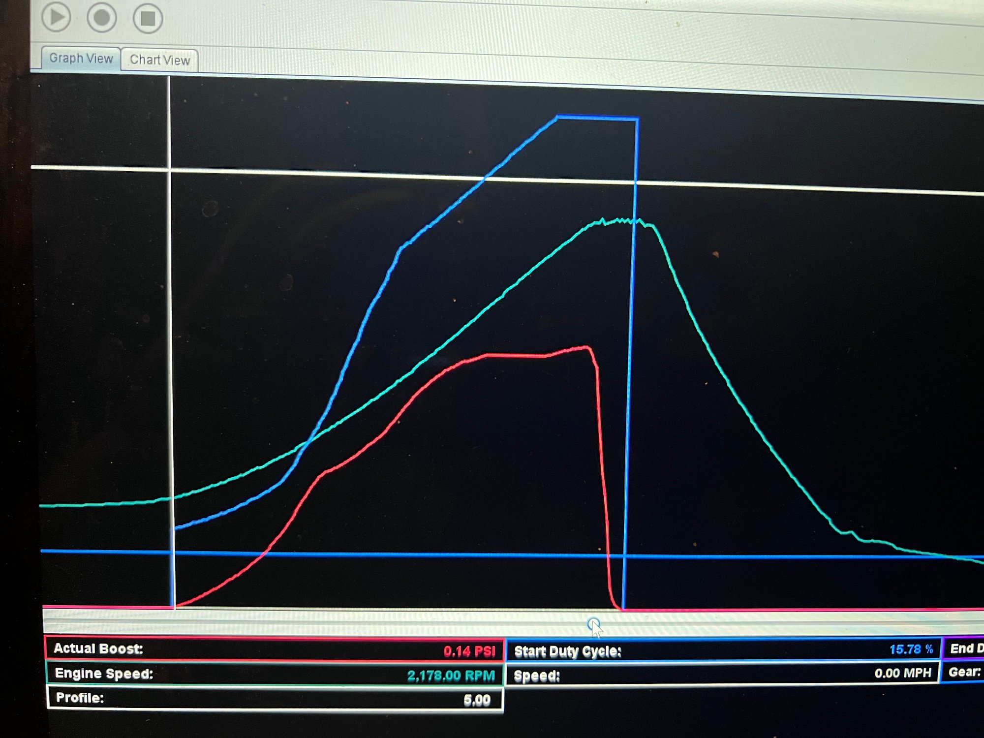

Yes I’m running e22-23 in the tank. Basically 4 gallons of 93 mixed with 1 gallon of e85
Upgraded intank fuel pump to a 450 Walbro fuel pump using oem fuel line. And then fuel line goes from one side of the fuel rail on the manifold out the other side into the high-pressure fuel pump. So the port injectors always see the low pressure side of the fuel system. So I am running eight injectors. The DME still controls the 4 direct injectors. I control the port injectors with the boost Cortex EBC boost by gear controller. So the port injectors only spray when in boost.
I can spin the tires pretty easily in first gear launching at 3800 RPMs using a wotbox. I have a light flywheel set up as well. But I’m also using higher compression pistons so I’m not losing as much of the bottom end rpm grunt. Everything over 4Krpms is very responsive.
EBC I ramp in the boost. I tune in the port injectors and I really don’t want a big boost spike down low because it makes it undrivable and safer 😂 but here is my boost duty cycle set up.
See here.
Green is rpm, blue is duty cycle, red is actual boost. This is the log from the dyno graph.
