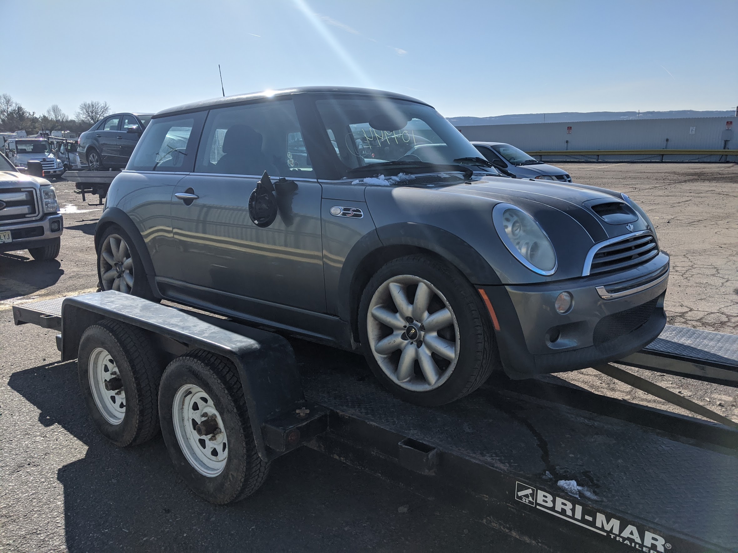

Thought I would start a thread for 24 Hours of Lemons racers. Some friends of mine and I picked up 2005 MCS w/manual trans from a Copart auction for $425. (If you're buying from Copart, the fees are not cheap. I think we paid almost as much in fees as we did for the car. ~$375 or so.) Thought it would be fun to swap stories and tips. We're shooting for the Pittsburgh race in April and maybe the Chump car at VIR in August.
Here's a video of it getting loaded on our trailer.

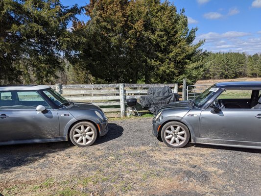

The one on the left was gifted to one of my teamates which is how we ended up building a MINI. We were looking for a parts car, and ended up with the one on the right from Copart. Turns out the parts car was in better shape than the one we were going to build, so our parts car is now our race car.
