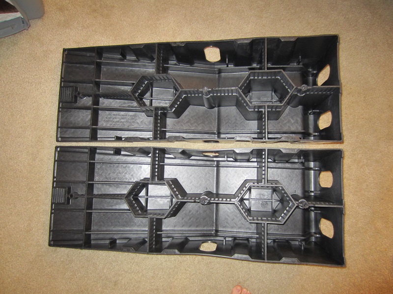

Also, a bonus: to make life a little easier, I picked up these:
Rhino Ramps
RhinoGear 11912 RhinoRamps MAX Vehicle Ramps (Pair, 16, 000lb. GVW Capacity) : Amazon.com : Automotive
Honestly, it's a little incredible that they can do 16,000lbs. Especially seeing the underside:
Regardless, should be good enough for the MINI! Obviously I can't change tires using these, but should make basic maintenance that much simpler.

If you don't have one already, you should also get the 3000# aluminum floor jack from Harbor Freight...that is the best for the money. They also have an all metal 12v tire pump that works really well.
old car (not using stands lol):
