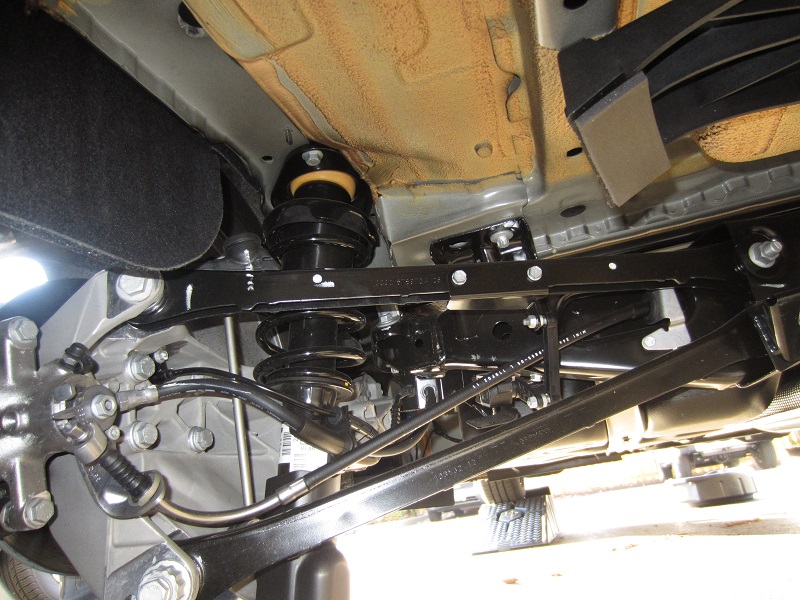

11/23/2013 - Undercoat Protection
Decided to hit the car with a few rust protectant/prevention measures today:
1) Wax a few of the bolts with a special wax that a friend got me
2) Hit driver's side with Amsoil HD Metal Protector
3) Hit pass side with Boeshield
Notes: Amsoil's spray is actually totally orange, and completely matches the orange from the wax - I wouldn't be surprised if it's the same stuff. Boeshield goes on clear, but it's easy to see the waxy/filmy consistency. Also surprised to see the entire underbody is some kind of orange rubberized sealant (normally it's black but maybe that's grime lol)
Amsoil and Boeshield (wax not shown):

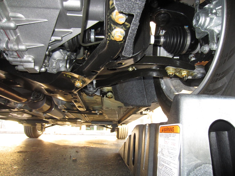

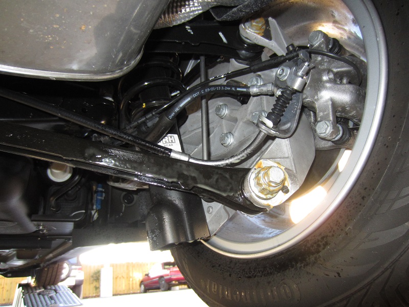

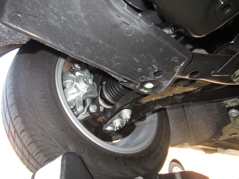

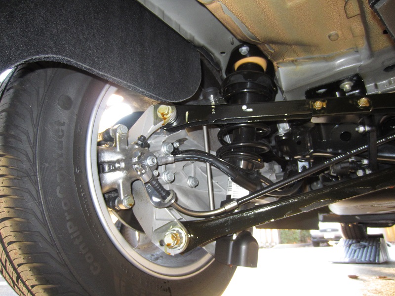

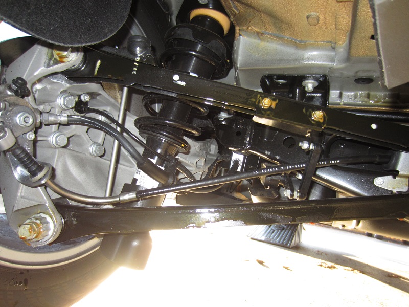

Before Wax:
After Wax:
Driver's Side:
Passenger's Side:

Before Wax:
After Wax:
Driver's Side:
Passenger's Side:
Only one can? Heck I used 3.5 almost 4. I sprayed in every hole I could find, every exposed fastener. Even in the engine bay as I saw a mini that had been unprotected and it was.....um pretty bad. One final place was under the door seals where the rust likes to occur, and trim panels. I look at it is if water can get there, then salt can get there, and finally rust can form there.
Heheh, pics? I was freezing my *** off when I did mine, pics were the last thing on my mind :D
I hit every spot that wasn't going to
- Get super hot like the exhaust....but wasn't picky if it got dripped on, the excess just burnt off in the first mile. Stuff like oil pans would not bother me......BUT as I had my skidplate on, I didn't hit anything on the underside of the engine...but the steering rack and the skidplate.
- Need grip.....ROTORS do not spray brakes......but if you change out wheels and run steelies.....spray the insides and let the stuff dry before installing them
Everything else was fair game. Heck I even hit the plastic in the wheel wells while I was spraying down all the metal parts. I figured it would help the snow fall off instead of caking.
If my underside looked like yours....I would over kill it. It'll never look that clean again.
Also any drain holes you find just pump the stuff in those in every direction.....moisture will sit in there.
