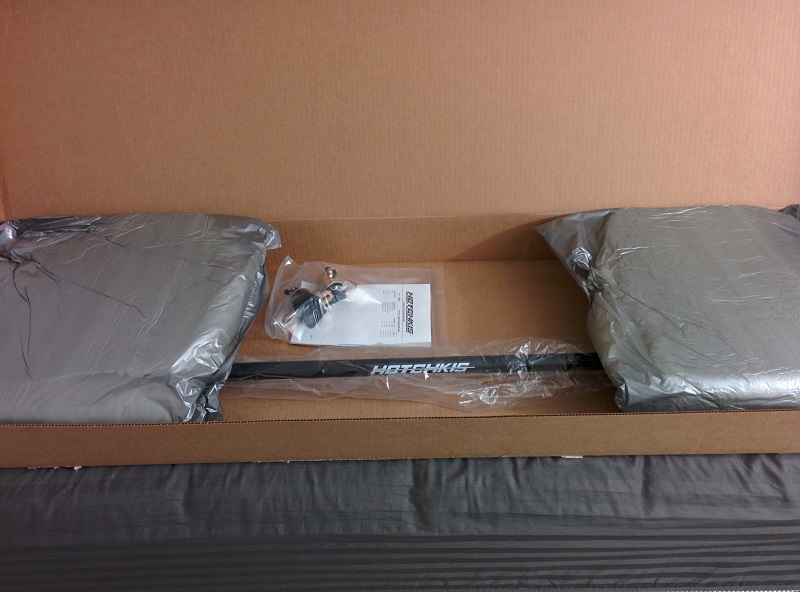

It begins...
Old Feb 7, 2014 | 05:08 AM
  #102
cmt52663's Avatar
cmt52663
Posts: 4,166
Likes: 402
Hanging around bars now are we??
