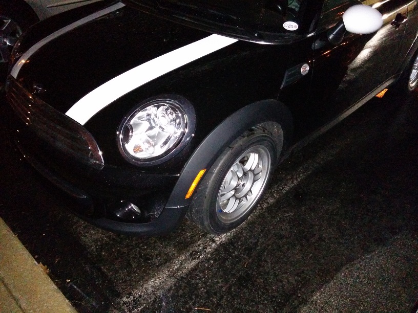

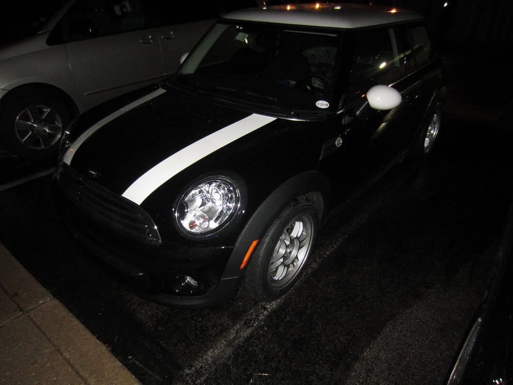

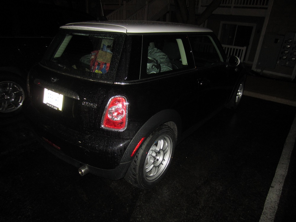

too tired to write right now, but the car is all set! i didn't push it at all, it was pouring rain and i just wanted to go home. however: suspension is on, wheels are on, off to be aligned tomorrow, and dog approved:
very very stoked.
very very stoked.
ha!

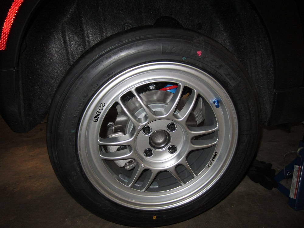

thought i'd throw out a few more pics of the wheels/tires:
http://r56hs.com/2014/03/28/new-shoes/
btw, very glad i decided to go with 205s over the 225s. fits perfectly and it's kind of close clearance-wise as is.

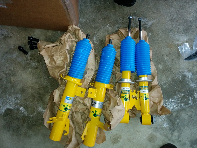

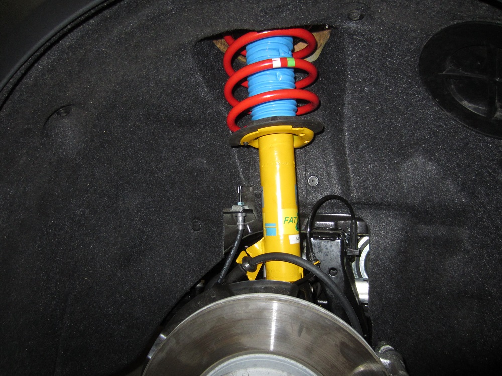

posted this in another thread:

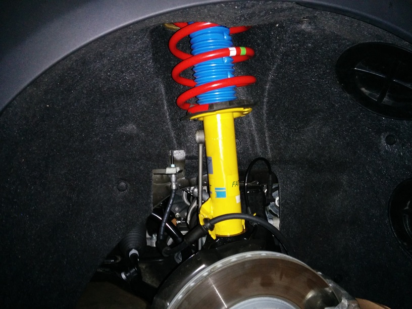

Not to flood this thread, but I thought I'd also share my new suspension set up:
http://r56hs.com/2014/03/29/fat-cat-...pension-is-in/

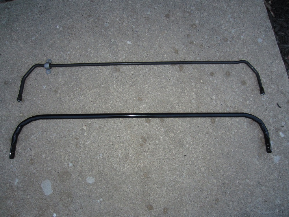

Handling Impressions: I think “WOW” pretty much sums it up. After a year of more or less fighting the old 08 Mini’s (stock sport suspension) understeer, this is a huge surprise. This car is very very neutral. I should probably add an asterisk here, my impressions stem from one (so far) autox event on a cold day, albeit with a codriver and tire warmers. Anyway, I think it is neutral enough that I can play with tire pressures to get the car to basically the same level as it was today. There is a hint of understeer when I overcook things, and a little more than a hint of oversteer when I lift throttle or I’m being too jerky with the steering wheel. I used to have to use some pretty violent inputs to get even a neutral balance out of the old MINI, so this is going to take some seat time to get used to. Fortunately enough, seat time is one thing I will have a lot of for this year. Overall, the car feels very good, and very planted. It just feels well sorted out, and I think the JCW FSB + JCW Springs + Fat Cat Motorsports Bilsteins + Hsport RSB is the best combination for HS. Seriously. In addition to FCM’s custom valving, my Bilsteinsn also came with his proprietary Kerb Blow Off (KBO) technology – AKA a proprietary technique to high speed compression blow off. All in all, I wouldn’t change anything about this set up (except if I could somehow increase the front camber).

A detail question...do you think the front sway bar was worth it? I know you did everything at once so it will be tough to tell what part did what for you. However, there are some who have posted on here that the change should be to a smaller front bar not a large one. I am guessing, by the tone of your posts, that you are pleased with this part of that part change you made as it fits with the rest of your changes.
to start, i had to get the front sway bar regardless of whether or not i wanted it, because of stock/street class rules. that being said, given how perfectly neutral my car is right now, i imagine that i would have had too much oversteer with a smaller front bar, which would have made life a little more difficult. as it stands, i am very happy with the overall balance of the car right now, of which the fsb contributes. the install wasn't very painful for me, mainly because St Louis MINI Club basically did it for me lol. regardless, i'm pleased with the upgrade.

I decided to write in a little more detail as it pertains to my FCM dampers - I'm very, very, very happy with these. I can't stress this enough - I firmly believe these are the way to go over Koni Yellows.
FCM Dampers: I am very, very impressed with these dampers. These are Bilstein Sports, custom valved by FCM and include his proprietary KBO technology for digressive high speed compression. As far as the KBO high speed compression bit - FCM asked me to take a video of me driving the car over a speed bump at 15-20mph - I'm not brave enough to do that yet, but it should give you an indication of how confident they are in their KBO. Overall. the car is very stable and very planted. I've gotten comments about how well they ride as well as how they handle. One of the top level drivers in my region commented that it looked like FCM hit the money on the valving. According to my codriver on Saturday, the car transitions much better, especially in slaloms, and the car overall behaves very predictably. He went as far as to say it might slalom better than his STF R53! We had a stretch of the TNT course on Sunday that had a very rough/bumpy patch - I was basically able to keep my foot down during this entire portion of the course - i KNOW other drivers were for sure losing time here - I hit my head on the roof of one car I was riding along with when we got there! To be honest, I've even had the thought that these dampers are too good (for my skill level), allowing me to get away with certain bad habits (especially with throttle on bad surfaces) - hopefully that's not entirely true. To my fellow autoxers - forget Koni Yellows and their ***** - that's really their only draw, and if you've read A2W, you'll know that the ***** aren't even reliable to begin with! Not to mention they like to blow when you custom valve them. FCM Bilsteins are where it's at!
