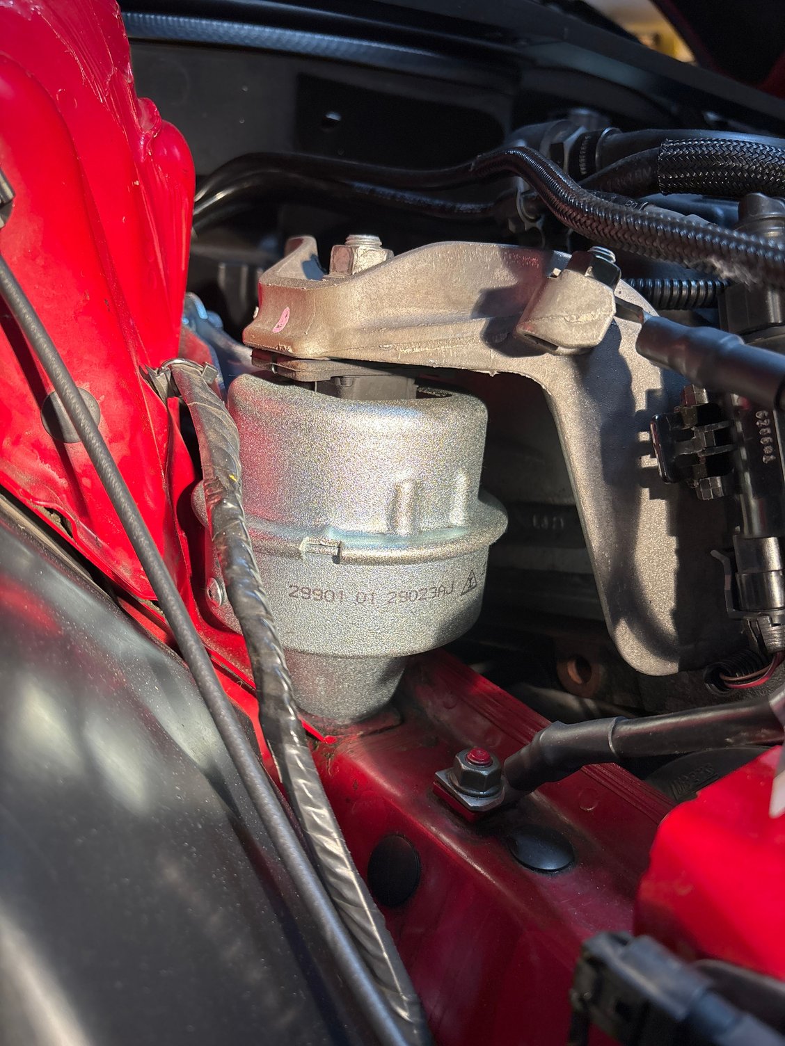

Waymotorworks sells a lower engine mount with upgraded bushings in it already, which makes it a simple swap. I’m running a BSH lower and an eBay knock off vibra upper. Unless you are thinking of tracking it, don’t go this route. The extra vibration in the cabin isn’t worth it. My buttons for light on headliner are the rattling at certain rpm’s, luckily the dash and everything else remain rattle free. Another tip, stick with stock intercooler and stock intercooler boots, honestly just throwing money away on anything else
Only pic of eBay upper I seem to have.

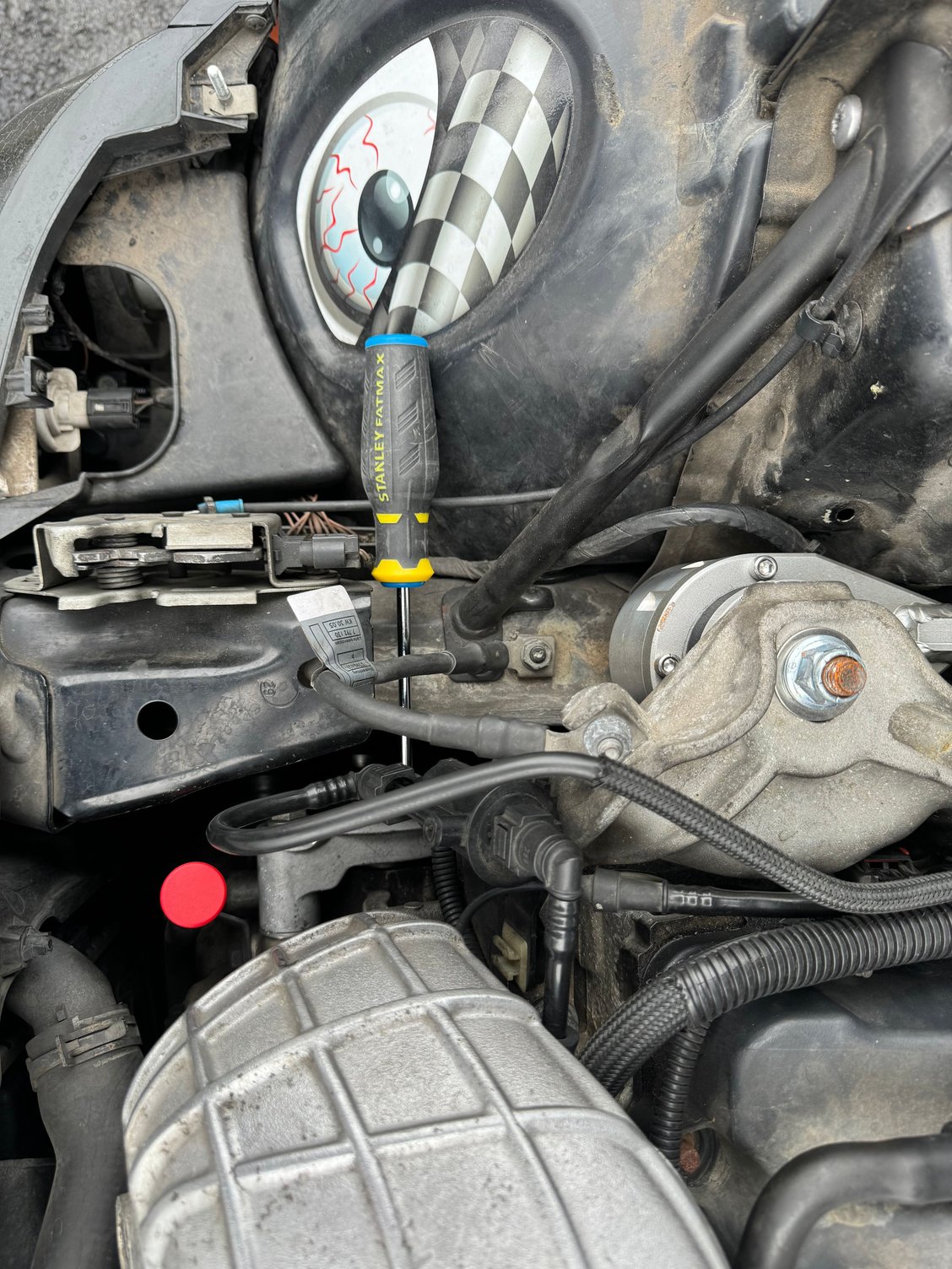

It’s easy to see if the engine motor mount has failed. The rubber on top is crushed down to 1/8”. I recently replaced mine and the bolt was rusted from the hydraulic oil leaking out the bottom. This is the only rust I have found on the entire car.
The replacement bolt was $12 and the shipping was $12 and the rust in the eye is priceless!
Motor Mount
Motor Mount
Kurt
Motor Mount
Motor Mount
Kurt
yea, that design right there is exactly why i used a poly insert on the upper motor mount. this mount should last a while, hopefully, seeing how it cannot collapse on itself.
