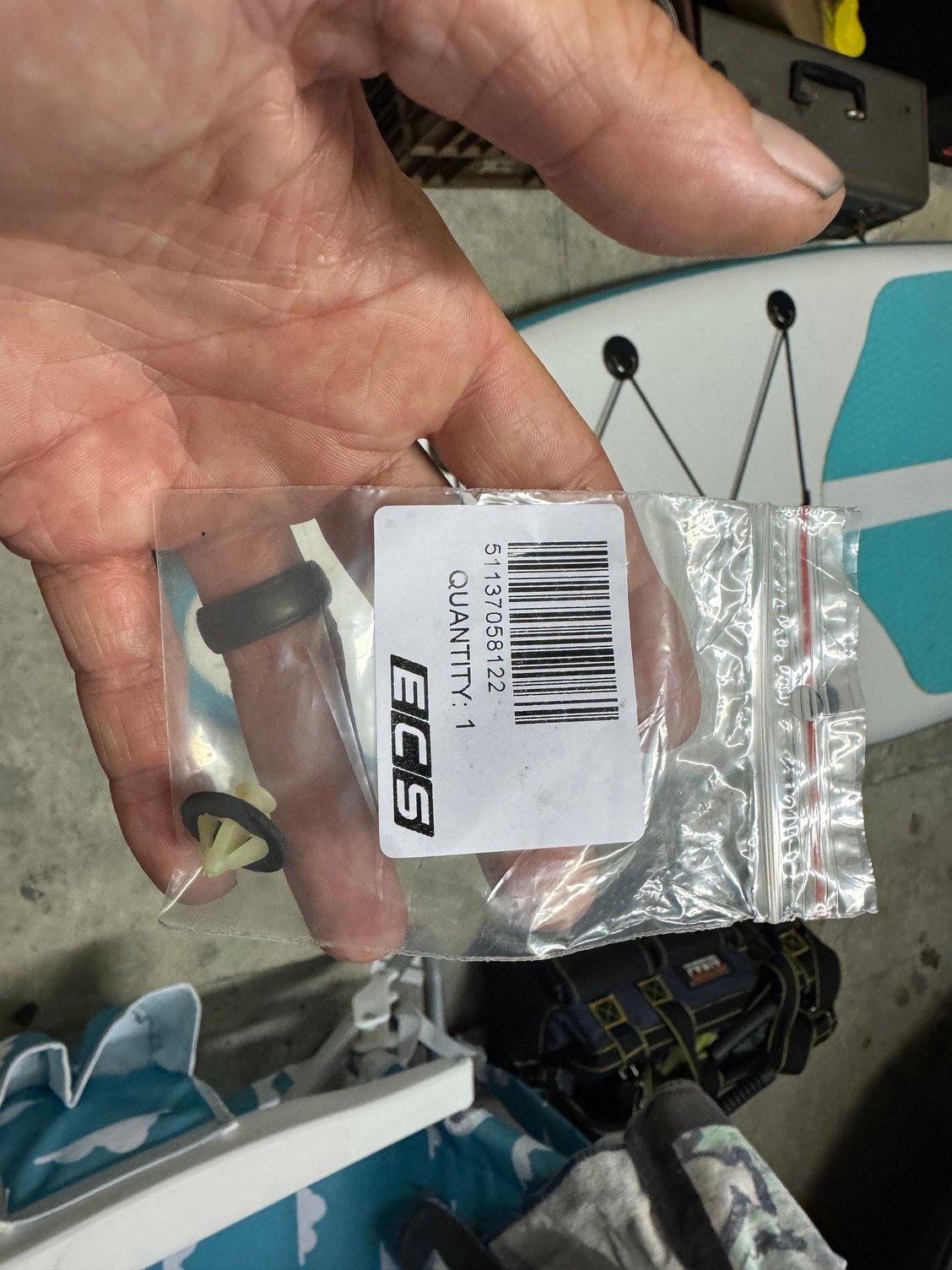

Originally Posted by Jason Cornelius
but didn’t have the white clips that go under the windshield to hold the chrome trim
How hard are these to replace without removing the windshield? Apparently our windshield was replaced but the chrome isn't held on properly as some clips are missing.
it isn’t too hard, you can squeeze them in. Removing isn’t to bad, I used a straight pic and just punched the middles out, then used the same pic to carefully push the new pins in on the new clips. I picked the deluxe windshield clip pack from ECS. I’m not a very big fan of Safelite and their BS they pulled. They didn’t even attach my chrome trim, broke a whole bunch of the clips they put in, didn’t even put clips on the chrome trim at all, and apparently couldn’t find the clip to put the plastic trim piece back on over the outside a pillar, oh and broke my chrome trim where it screws in and dented it. I had to get all new clips, picked up a good set of chrome trim, and I magically found that clip they couldn’t.
