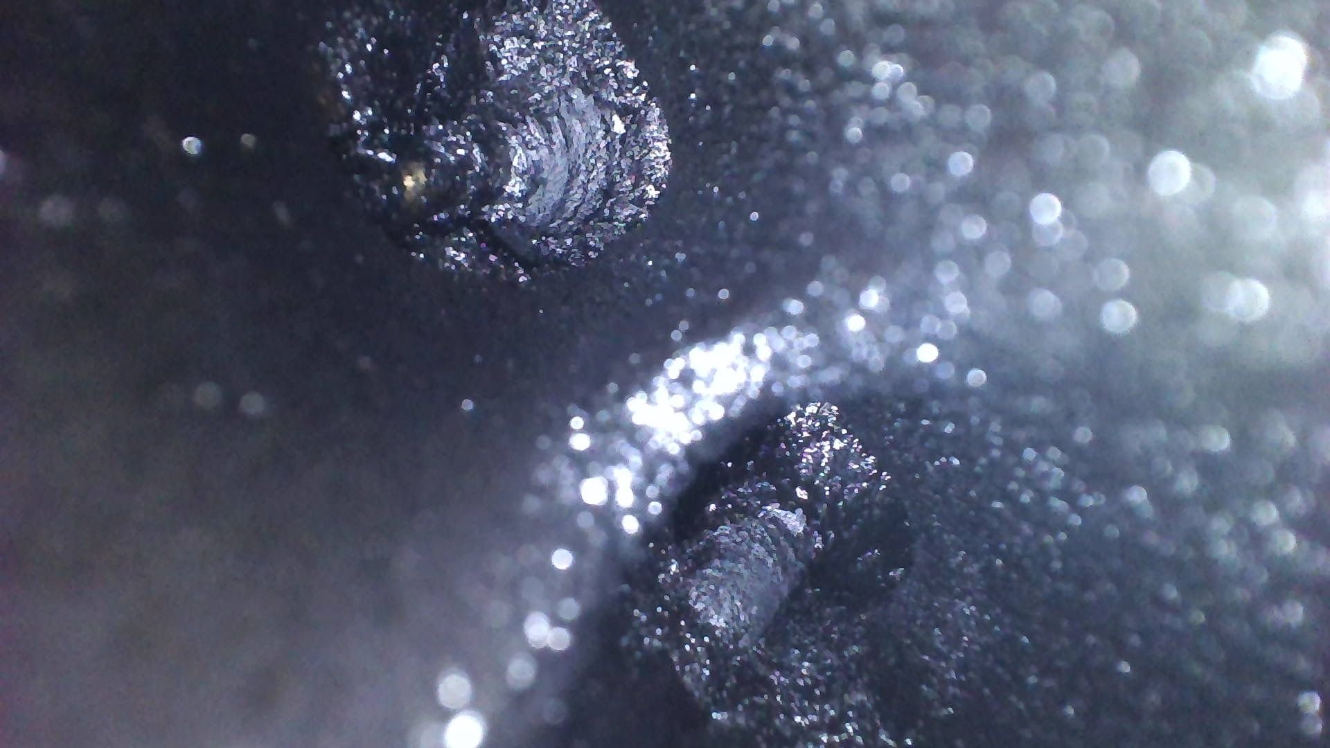

After 1 can of BG 44K and used 1/3 of the tank at 90mph AND two seafoam applications it "funs" a lil better. Less missing when cold and smooth idle. It still misses but not as much. The pics are before. I will plan on pick/blast/seafoam the intake as well as a catch can after the Dragon run this w/e.

Oh man, you need an intake clean!

Old May 8, 2023 | 01:23 PM
Posts: 36,758
Likes: 2,548
100% time to clean: https://www.northamericanmotoring.co...ispreloading=1

First car in which intake coking like that was a possibility was my VW Golf TDi. The combination of oil/water vapor from the crankcase ventilation system and soot from the EGR could combine and over time build up so bad to restrict engine breathing.
I'm loathe to have to subject the intake/head intake ports to any physical cleaning unless absolutely necessary and to keep this from becoming necessary I changed the oil every 5K miles (vs. the 10K miles VW scheduled) and avoided driving the car around like a big rig with RPMs never breaking 2K. Put 150K miles on that engine with no build up.
For my cars with direct injection gasoline engines and this currently includes my 2023 JCW (and my 2023 BMW M2) I will change the oil every 5K miles and avoid super low RPM usage. And every so often -- 250 miles before each 5K mile oil change -- use a bottle of Techron to remove fuel injector, intake valve, and combustion chamber/piston top deposits.

Valves now clean and boy, she screams now!
Old May 18, 2023 | 09:02 AM
Posts: 36,758
Likes: 2,548
Much better!
