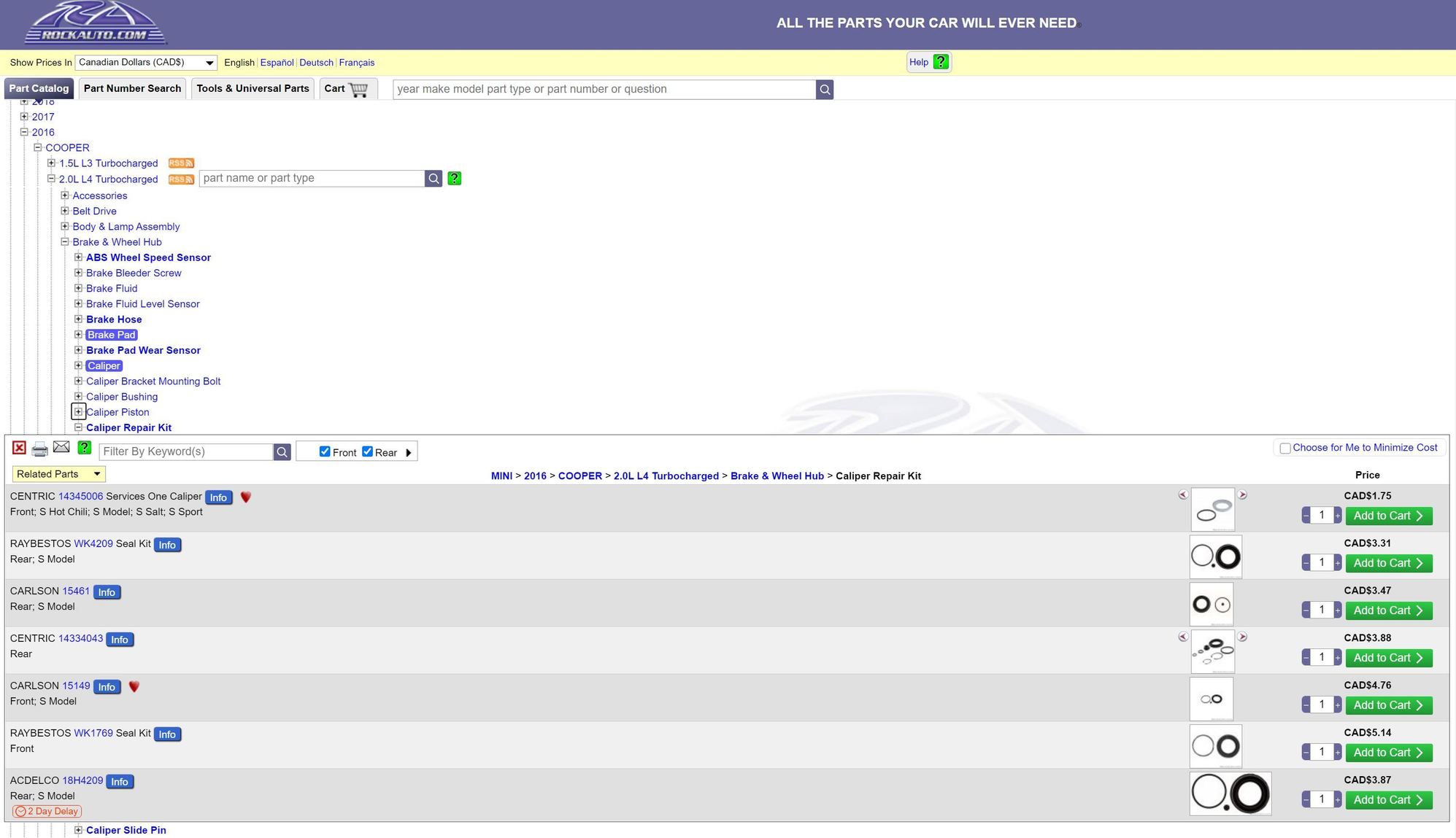

Hi, changed my rear brakes as one side was completly worn off (and the other side still had lots to go)...found it strange... So, while doing my rear brakes, I noticed that the dust boot on my piston was torn pretty bad (the side that had the brakes gone) and I think that would explain why the brakes were so used (maybe the piston isnt moving properly).
Aynhow, I called 2 different mini dealers...they all tell me they dont sell the dust boot by itself ..u gotta buy the whole caliper (800$ can)...screw that.
Can anyone help me locate the part ..for the life of me I cant find it on the internet...I've looked on old threads and so on...but all I found was boot dust for r53/r56 .... I have mini jcw f56 2016.
Pls help :(

are these the correct ones? is the jcw f56 the same as the cooper s f56 for the rear brakes / calipers?

I know, but I cant and wont pay for the whole caliper..thats just crazy lol. I just have to figure out the diameter of the piston ...as of now, I think its 36 mm...but unless someone has the information, ill have to go and measure it myself... and try some 5$ rubber part from an autoshop...This is just ridiculous :(

Try centric brakes. The F56 uses the same rear brakes regardless of car, even the GP3.

This may not be the one you need, but, I do see they sell just the piston seals...

When I had to rebuild the JCW calipers on my '06 R52, I picked up the complete seal kits from O'Reilly's.... kits were $6 each
