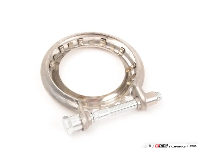

OK, new question. I installed the early style JCW exhaust onto my R56 S. I still smell some rotten egg smell in the cabin with windows up after decal from high rpms.
Is this normal for JCWs? I don't see a gasket between the downpipe and exhaust flange. I see the downpipes are different part numbers, is there a difference in them since JCWs don't have the second cat?
What do you recommend to get rid of the smell?

There should be a gasket between the down pipe and the exhaust pipe. If there isn’t, it could be leaking. Do you have a cat less down pipe, or it still OEM?

I have the OEM downpipe. When I looked up the exhaust on Realoem it doesn’t show a gasket. Do you have a part number or link to one?

I don’t know if you can purchase just the gasket, but it come with a new clamp:
https://www.ecstuning.com/b-hjs-part...302756352~hjs/
Old Mar 30, 2020 | 07:00 AM
Posts: 36,758
Likes: 2,548
Just the clamp/gasket you can get.
i have that clamp gasket on the down pipe side. Nothing on the exhaust side.
Is that correct?
Old Mar 31, 2020 | 07:03 AM
Posts: 36,758
Likes: 2,548
Just that clamp on the connection from the DP to the cat back. On the upper part of the DP to the turbo there is a gasket. If you have an aftermarket exhaust they will have sometimes a band clamp half way back or select OEM exhaust.
Is that correct?
It will only install correctly one way. If you re-used the old clamp, you might not have transferred the gasket.
The gasket (metal) is still attached to the down pipe.

I am installing a new clamp, and it came with the gasket which has a bunch of tabs around the outside edge. What's the proper way to install this gasket and the clamp?
Do all of the tabs go on the outside of the flange from the catalytic converter? Or do some go outside and some inside? Is the purpose of those tabs just to hold it in place while installing the clamp?
I removed the old clamp and gasket because it was leaking exhaust pretty badly there. the pipes are all in fine shape. The old gasket was still intact, but most of the tabs were broken off, and they were just mashed inside the joint. Any advice?

They go together. Little bit of a pain. Sets like the one below. Then connects to the front of the pipe. Clamps like the old ones in the same orientation.
https://www.ecstuning.com/Search/Sit...h/18302756352/
