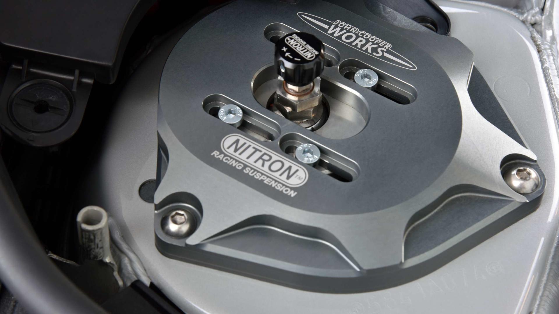

good info thank you Eddie. I think the Challenge runs Nitron

Here's a link to the Nitrons: http://www.nitronracingshocks.com/Mi...t-_p_2122.html
A bit pricey .

yup a little pricey

From: Upstate NY
Maybe a bit of what you are paying for is the MINI name on them and the fact that they ARE SHARP LOOKING!! Love ‘em.
I did note that they are adjustable from the top, which is difficult for the rears...
