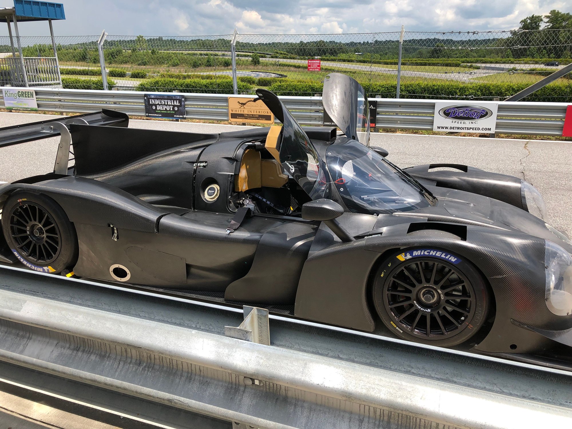

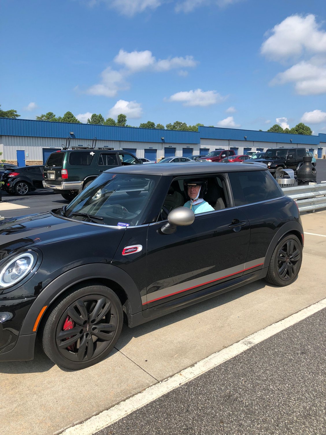

First track day in my '19 JCW HT. (Mods still have not allowed name change.) Five 15 minute sessions on the track with class room sessions in between.
I voiced my braking concern with my instructor. He explained a better technique in my trail braking. Problem solved before I even went out. But now I have another one.
In my second session, using all my instructor's corrections, I'm blasting around the track. 70+ in the big sweeper, 100 on the straight with only a few miscues in the twisties. I must be the fastest man on the planet and breaking all kinds of course records. Finishing the last twisty before the straight, I look in the mirror and there is a traffic jam behind me. How in the world could anyone have caught up to me? I give the pass-left sign. An ex-LeMans car, two high end 911s, and something so modded and totally covered with stickers I couldn't even tell what it was. I could still see the 911s through the next set of turns but they were gone after that. The LeMans car appeared again in a few minutes in my mirror. There was also an old F1 and a couple smaller open wheelers that ran earlier. Tough crowd.
I hope I didn't embarrass any of you JCW guys. I was pedaling as fast as I could.
I thought I needed to report back that there is nothing wrong with my JCW, it was just the driver. My new problem is that I just need to get faster.
Attached Thumbnails why does my JCW handle worse than my justa"-img_0536.jpg   why does my JCW handle worse than my justa"-img_0537.jpg   why does my JCW handle worse than my justa"-img_0533.jpg

Sounds like you had a great instructor.
Keep getting an instructor in the car as much as you can. Most will be really great and helpful. There is so much to learn with respect to driving fast that has nothing to do with the car... Hope it continues to go well for you.
Great looking cars at that event. Some times it is almost worth it the cost of a track day just to see the cars that others bring to an event.
