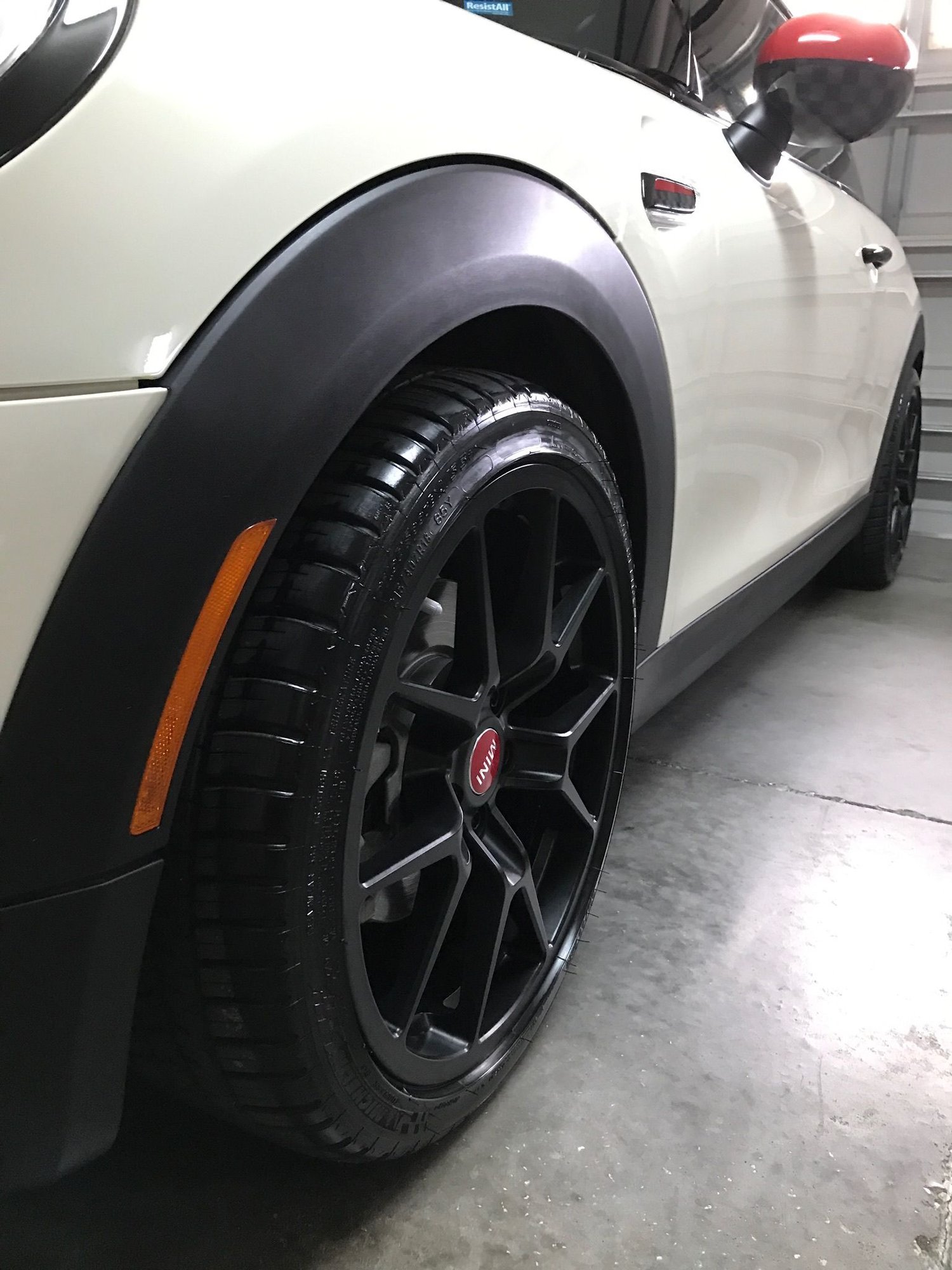

I am running the RSE10 which are 18 X 7.5 with a 45mm offset, 215/40 and the JCW coil over kit. Your wheels are an offset of 40mm, so they will stick out a little more than mine.
I was rubbing on the inside of the wheel well so we had to raise it a little bit.
Below is a picture I took at work Wednesday am, so hopefully it will give you an idea.

The nice thing about the Coilovers is the ability of been able to adjust the ride height. I probably dropped about an inch. I can fit 1 finger between the tire and the wheel arch with some wiggle room. I'll take some pictures later today so you can see. It is perfect for my taste. The dealer has an S with the JCW exterior kit and wheels, theirs is set up to OEM specs and it is much lower than mine... but those wheels have a 54mm offset.

Here are a few shots of my car. I am at 23 inches from the bottom of my rim to the wheel arch. It is perfect for MY taste.
Front drivers side
Rear drivers side
Car

Thanks Brian. Yes, the wheels are flush with the fenders. Yours will be 5mm more towards the outside. Stock is an offset of 54mm. The coils will settle and go a little lower in the next few weeks. If you want to lower it more, you can do that... That is the beauty of the coils. In regards to the grill, I had it wrapped along with the red under the S.
The picture below was the day that I got the wheels, prior to getting the Coilovers installed. Not the best angle but it will give you an idea. Can we say fender gap... LOL. I look forward to seen your pictures.
