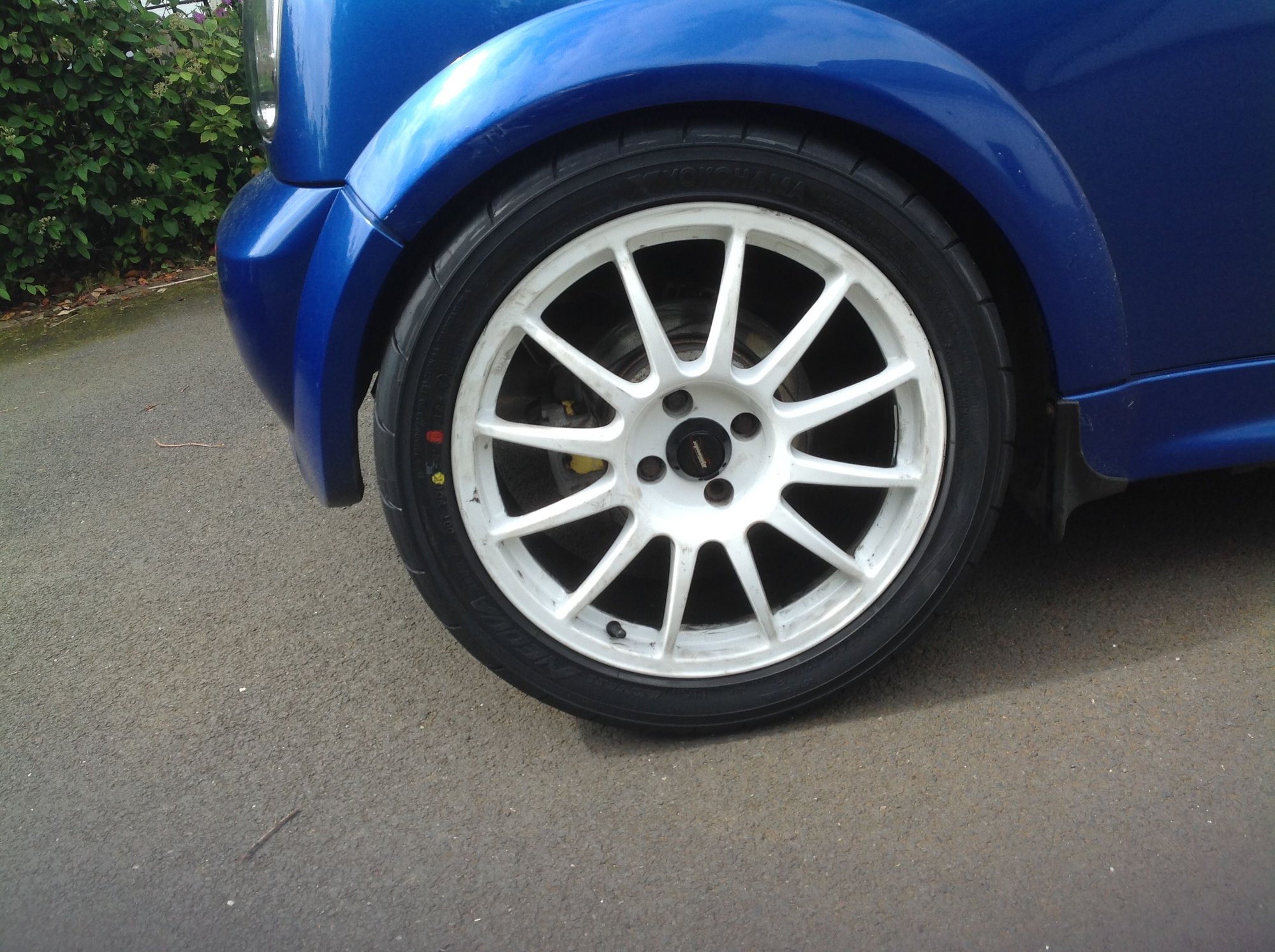

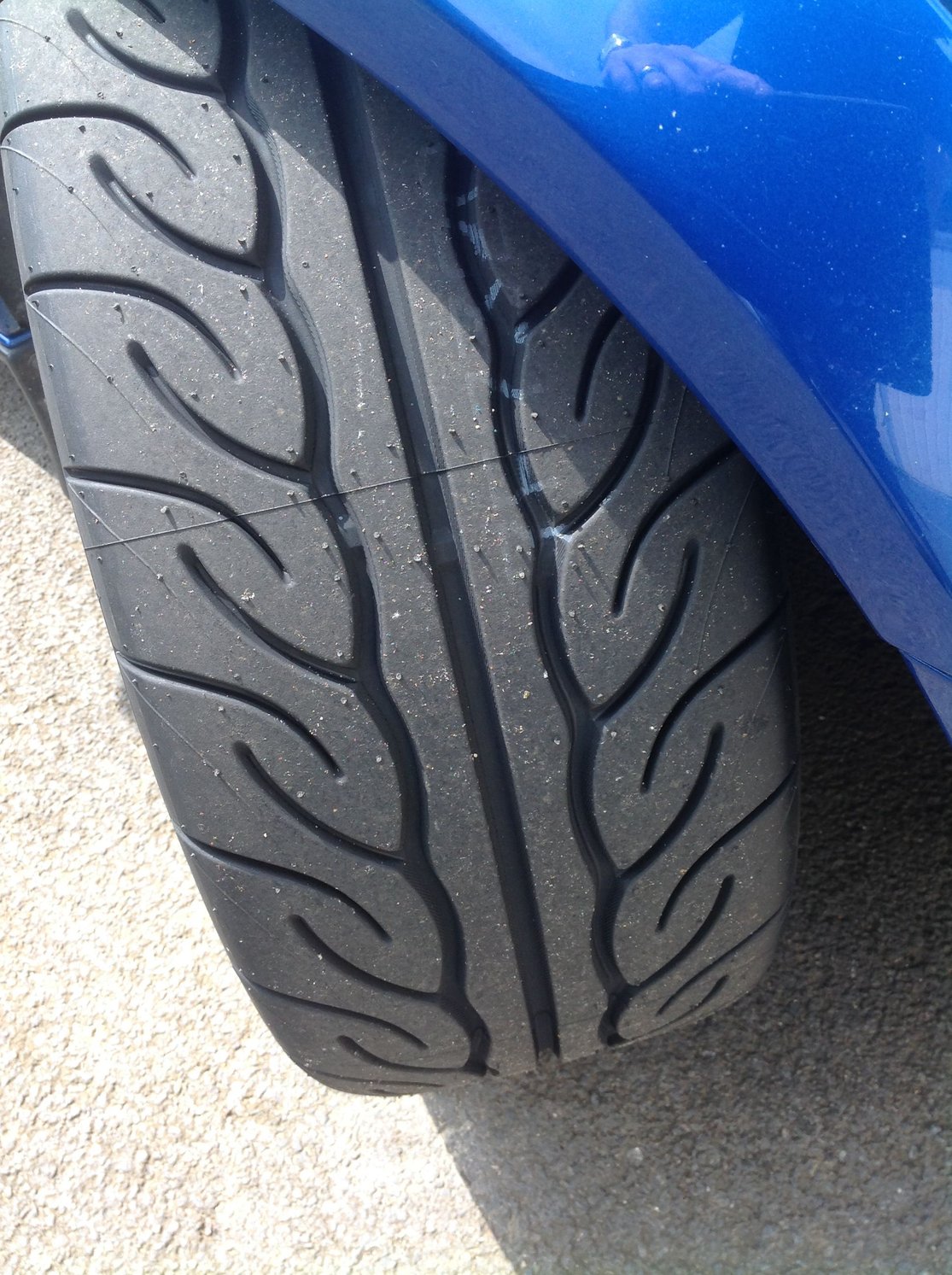

Ran Yokohama 215/45/17 Ad08r as a Uk summer tyre on my r53 with 250 whp,
Good dual use for street and a little bit of track
Factory LSD was a big help also
Good corner speed, no noise, no drama
