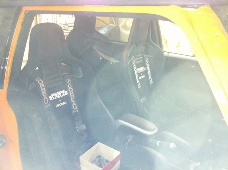

Ok here's the latest. Mini has apparently been bombarded with requests to retrofit minis of all types with the recaros. No final word yet, but it might end up being something that the dealer will install w some engineering work arounds for airbag issues. I do know that the Recaro won't sell me the OEM recaros directly no matter what I am willing to pay. So the purchase has to come thru a dealer if you want to keep your mini in OEM spec. Of course, you can always order second hand and hope for the best- not my pref. My goal is to create a mini that rival evil mini. I've got about 10 extra in it now and I think I have another 15 or so to finish it off. The end result will be the "Limesicle" bc of the gt3rs green paint job. I am so excited.

Originally Posted by Blainestang
Orangecrush has them in his JCW, as well. PM him.
Best seats in the house.... well worth the money.

They look great! But how did you go about with the airbag lights and passenger weight sensor issue?

Originally Posted by Drobinson1692
they have airbags and passenger sensors.
For me, yes and no....
They have airbags and heat. They do not have pass. sensors.
You have to take the factory pass. seat apart and install the pads from the old seats into the new seats.
Now, since they're going to be offered in the US, they may indeed come with pass. sensors but when I bought them, that was not an option.
