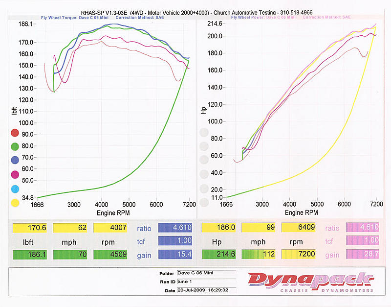

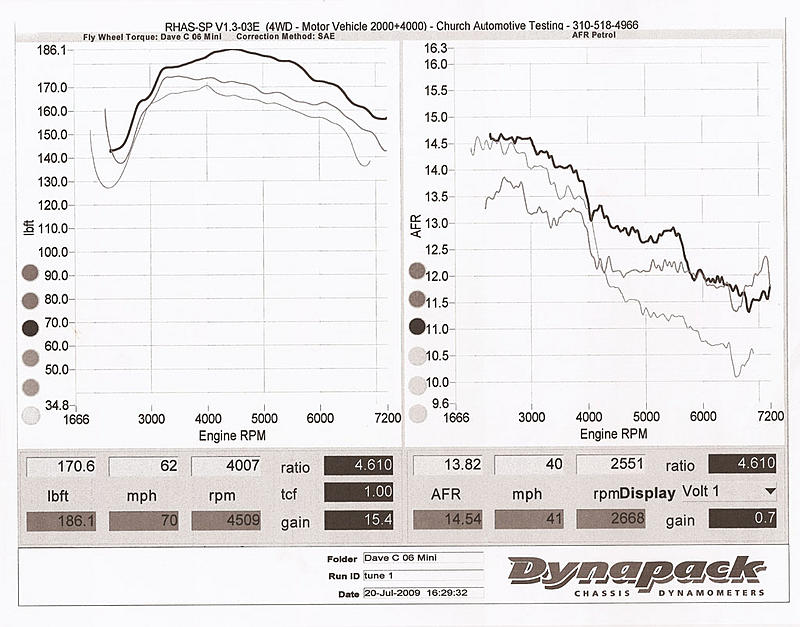

Got our '06 JCW Tuned by Jan (RMW) in two phases. We finally fell out of warranty at 60K and needed an oil change. Went into Johnny's Auto Clinic in San Pedro, got the car properly fixed up (dealer had apparently neglected a leaky engine dampener/mount, leaky valve cover gasket, wrong length serpentine belt, loose rear struts, and a few other things while we were under warranty).
Then went to Jan to get a Dyno Tune of the JCW maps but essentially running stock factory JCW hardware except for a set of new Brisk plugs on 7/20. Nice gains with the Tune alone and the car was faster, pulled stronger and was much more fun to drive, exhaust note under heavy acceleration was much more aggressive...however, we were now hooked...
We still needed a new clutch (which had been getting stiffer and had been having a creaky clutch pedal feel and sound when being depressed), which unsurprisingly the dealer also punted on doing under warranty...go figure :(
No worries, we went for UPGRADES. Jan and Danny at MiniCorsa worked out a package deal for a RMW Cam, RMW Shorty Header to be installed while Danny was doing our stage 4 Clutch with lightened aluminum flywheel (a good time to do the engine work as the engine had to be all taken out to access the clutch anyways) as well as some other work. Like I said, we were hooked.
Finally got into Jan for a final re-tune yesterday and here are the Dyna-Jet dyno graphs, all were done on Church's Dyno in Wilmington CA (essentially at sea level, ~32 mmHg?).
Some notes:
Dates for both graphs show the date for initial tune on 7/20, newer plots were done yesterday but superimposed on the 7/20 graph.
The lowest curve in both graphs is the baseline, 186.1 WHP is just about where you expect a factory JCW (rated at 208 at the crank by MINI). Not bad for a car with 60K miles on it.
The Torque and Air Fuel Ratio graph (black and white) shows the palpable gains from the software tune alone (97.4F ambient) in the middle plot, and the upper plot shows the larger gains in the mid range torque after RMW Cam/Header/Tune combination (92F ambient).
The second graph TQ/HP graph (with funny colors, they were running out of color ink on their inkjet printer, which is why we switched to B+W for the AFR graph) shows the baseline as before. The middle fuscia colored plot is one of the less optimized early Tune only runs (not the final Tune only run, oops don't know how that got in there) and the two higher plots are for after the RMW Cam/Header/Tune combo. The Green one is a earlier run before AFR's were fully optimized but the engine wasn't too hot yet, the Blue is the final pull with the AFR's better optimized up high, but the engine/IC are now heat soaked and the engine is pulling timing down low. It was 92F with IAT's running in the high 50C's by that time.
What a difference 15 ft/lb and 30 WHP makes!! Driving around last night in cooler ~70F temps the engine felt even stronger, Jan said to expect to find another 5-10 HP in cooler conditions due to the IC Heat Soak issues.
Special thanks to Johnny for thoroughly checking out our MINI and finding and fixing all the crap our dealer's shop ignored for so long, Danny for the huge amount of excellent quality work that he did in such a short amount of time and to Jan for setting this all up and spending so much time doing a detailed/thorough tune (I'm talking like > 10 pulls per session, 1 1/2 hrs +).
No regrets on doing this, the MINI is like a whole new car with some serious grunt now. Just got to be careful not to get any tickets...
