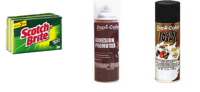

Chrome painting instructions
Originally Posted by burack
Mase, can you link the required items for a proper paint job?
sure.
attached are the 3 items I use all the time...
1. after removing the part from the car, I like to give it a quick wipe down with a terry cloth, some water and a drop of dish soap to make sure it's clean.
2. I'll wet a scotchbrite and use the green side to rough up the surface. Of course you can use sandpaper, but a scotchbrite is something that almost everyone has in their home and provides just the right grit.
give it a few good scours and wipe it dry to make sure you can see some good scratches.
3. wipe it down again taking care that it's clean and dry.
4. First coat of adhesion promoter should be very thin. Wait about 5 minutes since the AP dries fairly fast. When it has a nice frosty apperance, you can spray a nice medium coat all over layering your spray passes. Let it dry for 10 minutes
and repeat with a second medium coat. hopefully your outside in the sun which will help speed up the drying process. Wait 1 hour for the AP to do it's job and will be dry to the touch (enough to handle while painting; using a light touch).
5. Paint: I like to do 2 thin coats and 3-4 medium coats with about 5 minutes in between (matte and low-gloss paints dry much faster than ones with gloss). Apply additional coats as need be taking heed to not pause your spray too long on any one spot (creates drips).
6. Here's the hard part: let it dry 24 hours before installing!
let it sit out in the sun as long as possible to dry and bring it inside and away from kids at night. Rush yourself and you'll scratch it before fully cured and you'll be starting all over.
a couple of notes:
1. I like to use low gloss engine enamel because the finish is between matte and semi-gloss. I've only seen Dupli-color offer this finish. Engine enamel withstands high temps which can't hurt. The ceramic adds some strength as well...
2. If you're painting that is metal, I like to bake it in the oven to help harden it.
warm your oven to 400F. Turn it off, place the piece on a cookie sheet and leave it in there till the oven completely cools off. This will save you about 12 hours of drying! I haven't tried baking plastic pieces so try at your own discretion.
2. I've painted numerous pieces over the past 3 years exactly this way with no problems. The longer the paint and AP has to cure and dry, the better it will withstand to the elements. I've never had a situation where the paint just peels off the chrome like I've seen when people try to paint directly on the chrome.
I've painted the star on the grille of our wagon this same way and it still looks great except for some small chips from rocks on the highway. No worst than the ones that the normal paint gets, say on your hood or bumper. I just did my grill surrounds on the R56 and have every confidence that it's going to be fine.
good luck!
