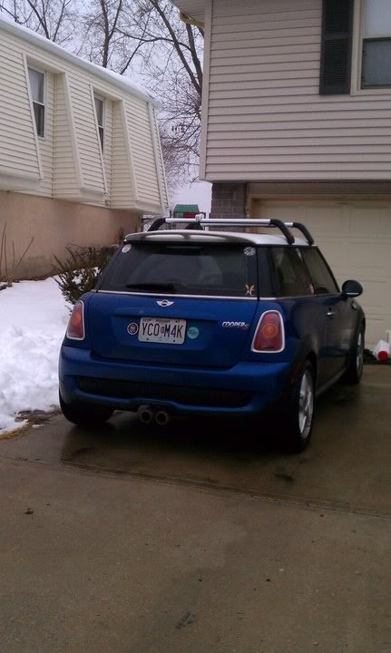

I was going to put my roof rack on today but I just noticed I've lost the tools for it.

Found it:

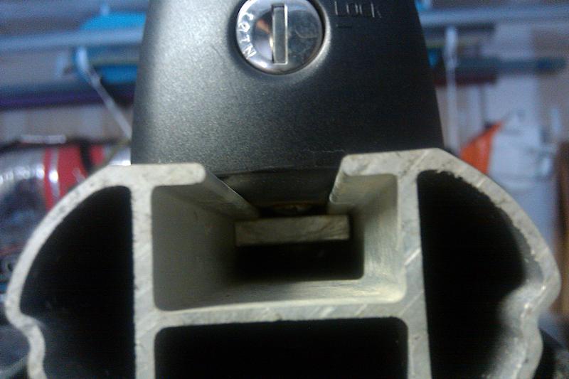

I like to see Carbon Fibre used for for something useful, light bike frames.
Having sold and installed both Yakima and Thule racks I do think that the OEM rack is a pain to install the first time, but it is a better fit and can carry more weight.
Not liking the look of the universal fit of the Thule ski rack I modified mine to fit the OEM rack.
Attached Thumbnails R56 roof rack-imag0067.jpg   R56 roof rack-imag0066.jpg   R56 roof rack-imag0064.jpg

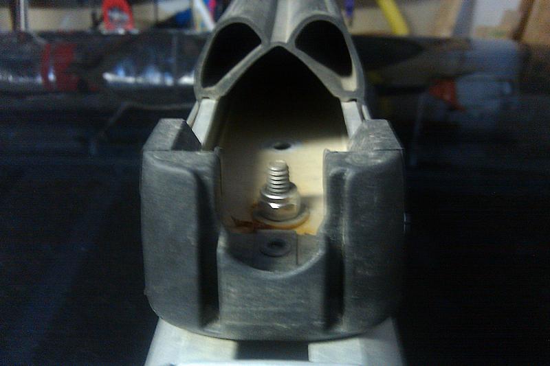

I read the instructions yesterday and it said to back off the nut till it stops. Well it did not stop and ended up striping out. This is also not a service part. Your rack looks different, mine had a slot on the end of the stud that was used to damage the thread to make a stop. I would not be able to remove the nuts on mine without striping them out.
Just something to watch out for with people doing this out there.
I ended up getting stainless steel parts to replace the brass.

Yea, mine had a stop in the bolt thread that ended up stripping the brass nut as well. We found the thread on mine to be M6x1.0
So for those that ever run into this problem a stainless steel M6x1.0 Nut and Washer combo should be perfect. Make sure you re-thread or file the bolt thread so that you dont strip the new nut!
I wouldn't worry about using stainless instead of brass, I don't think that you want this nut to fail. Brass was probably used because it is easy to machine.
