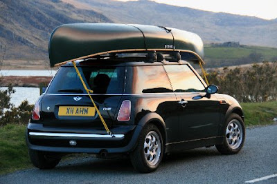

Anyone put a 20 foot long canoe on the mini roof racks?
I am interested in that one too!
Old Sep 11, 2010 | 02:33 PM
  #273
david in germany's Avatar
david in germany
Joined: Aug 2008
Posts: 637
haha, I googled it! it is an R53 though.
