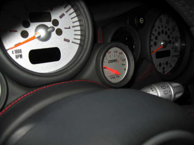

Installed dual Cooper S gauges? Too dark :-(
I have installed boost and volt gauges in my mini today. They sit to the left and right of the centered tach. The look great in the day they match the light gray of the OEM dials perfect. The only problem I have is at night the new dials are very hard to see. I removed the light and found that it is a four sided LED attached to a very small circut board.
My main question is "How can I make them BRIGHTER"? Not sure what to do.

Here is a pic of my new gauges I took during lunch.
M
hell all you need is the pointer anyhow. once you know what's normal for your car. mine are too bright and the dimmer barely knocks any off ; wanna borrow some volts?
