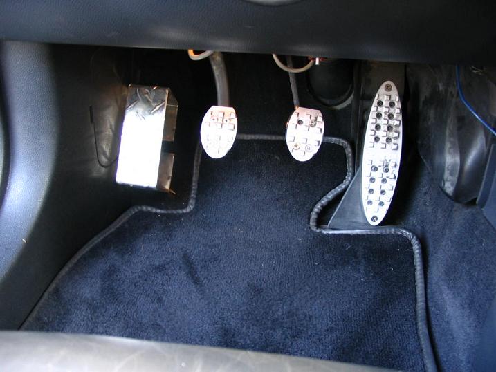

I was not happy with the dead pedal placment as well. I found it took too long to go from being braced to using the clutch and back to brace mode in the canyons. I had these done up by a local sheet metal shop for myself and a few friends and it is not a M7 product offering. It is simple but works for me. I can even leave my heel in the same place and just roll the tip of my foot off the brace onto the clutch pedal and back again without lifting my heel. It definatly makes for quicker operation of the controls and a more secure posistion in the car , not shifted off to one side, under hard cornering.

Is it aluminum? Stainless?

Very nice. Any problem with access to the fuse panel ?

Those were made of aluminum plate. The fuse panel can still be accessed . I also use the stock mounting bolts and nuts. I was selling them to locals for $20 a pop but they can be made easily . It just takes a few cardboard templates to get the angles correct.

I have one of Randy's dead pedals and its great. Your foot is always ready when you need it :-) Plus you can get better leverage to stay in the seat with it a little higher.
