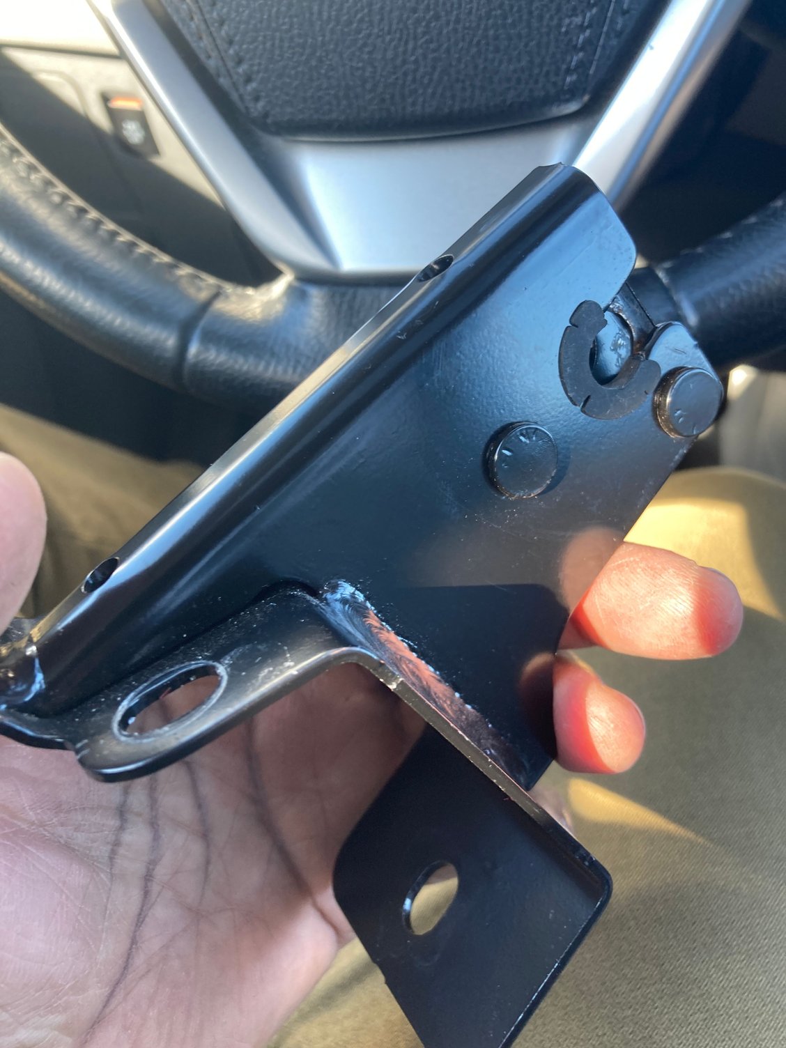

Install rear r56 seat into r53 using r56 rear center bracket
Originally Posted by Ive's Mini
The only thing you need to do is file the outer pivot holes to fit the R56 seats. I did this on a R53. I wrapped the pivot on the seat in some insulating tape and installed it right in. There was no noise from it after the install. It is relatively easy.
U need to get this rear center seat bracket from a r56 to install into the R53 so the rear seats can lock into place in the center.
get one at a junk yard like I did

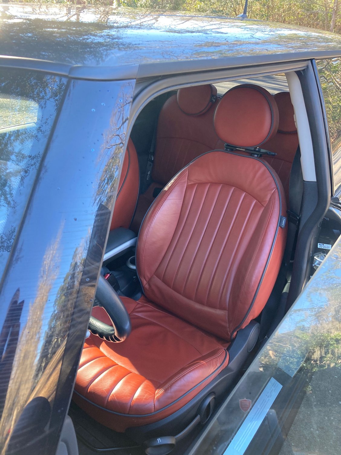

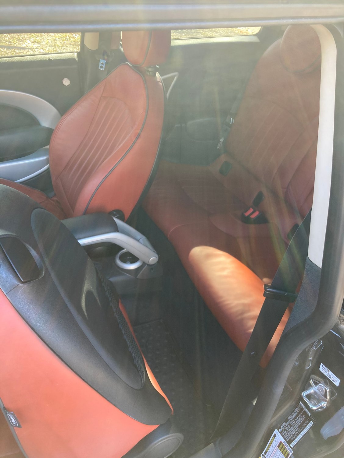

I did and u will love it ! Who says ? Accessgastro Says !
Originally Posted by mountainhorse
Has anyone done the conversion of the R56 Front & REAR seats into their R53??
Any help is much appreciated..
R56 seats front and rear install into a 2006 R53. Mini Cooper S manual . It indeed we fits. It is indeed easy to do both front and back. Pull out the weight sensor from old seat or junkyard r53 seat and connect it to you new passenger seat set up so that the airbag light doesn’t stay on. Or get a bypass one on line .

Those seats are amazing!! What did they come out of? They look so great.
Old Sep 1, 2021 | 05:39 PM
deepgrey's Avatar
deepgrey
Joined: Jun 2009
Posts: 1,316
Likes: 485
From: Atlanta, GA
They look like R56 lounge leather seats.
