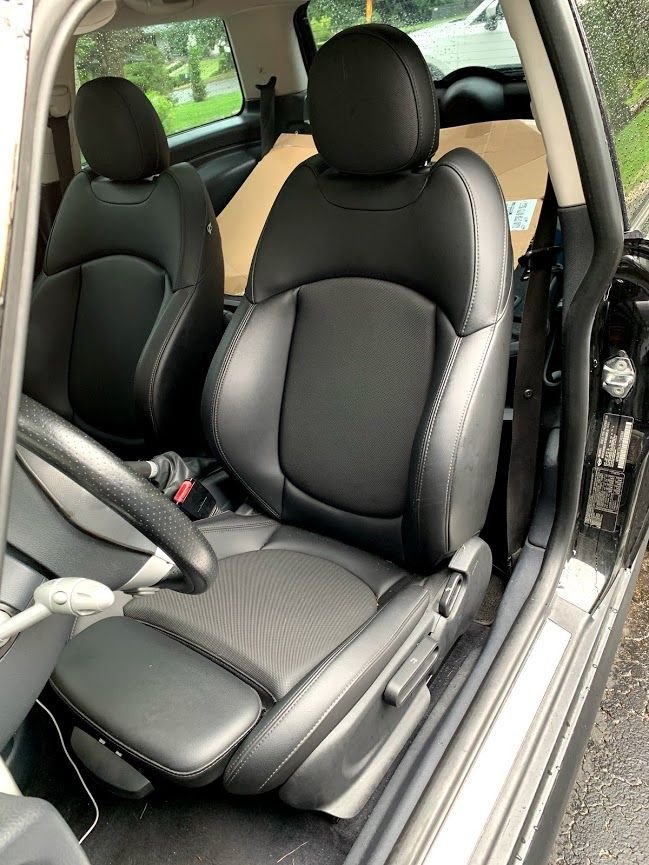

bumping this old thread up as we are trying to put a set of F56 seats in to an R53. We know we can make em fit, but more interested in any issues with the match up of the systems for seatbelts & airbags. I know there is some splicing to be done, just trying to know if resistors need to be changed and if anyone has the done this before?

You will need to switch connectors and match the wires (the colors changed from Gen. 1 to Gen. 2).
This thread has the info you will need: https://www.northamericanmotoring.co...nd-pics-4.html

I just did it with these sports seats +1 , you will need to splice the connectors to match .
Impressive! So these are Gen 3 sport seats?! And you just needed to modify the wiring harness to get them to work? Did the rails fit in the 1st gen with no modification?
Did the rails line up in the first gen, or what modding did it take? My local junkyard has some nice looking f56 seats in one of their cars I've got my eyes on.
