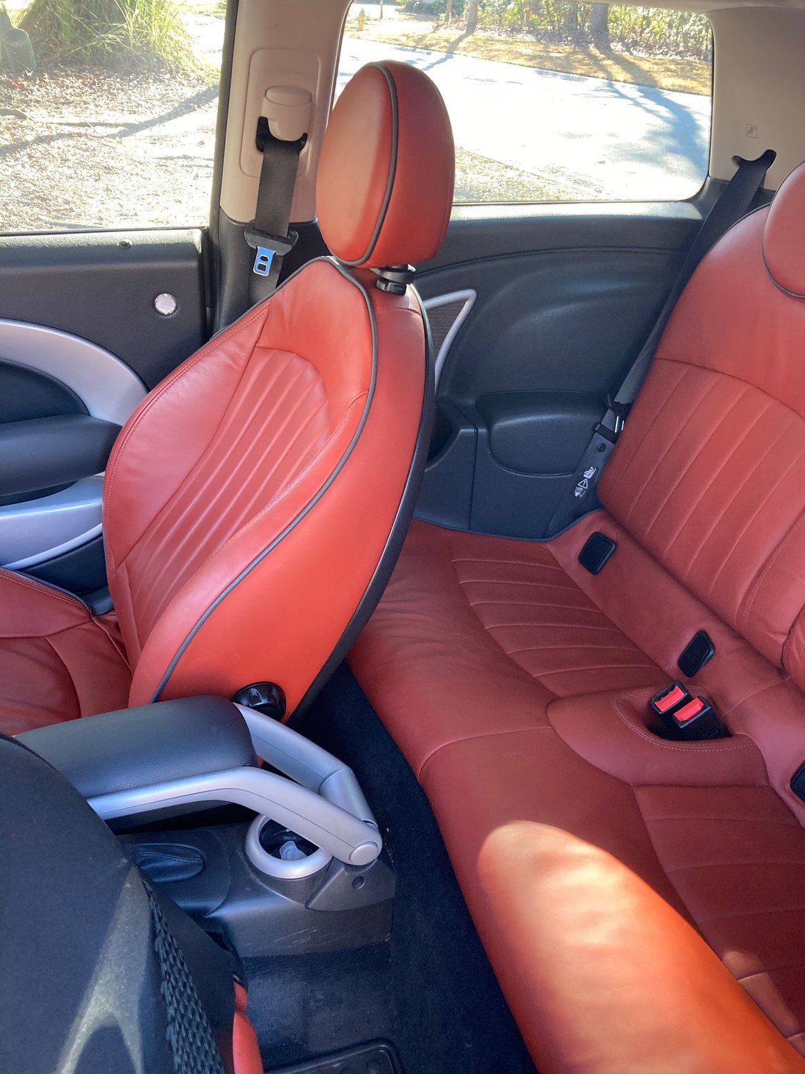

Redwood red leather r56 into r53
To install rear seats...U have to Remove the r53 rear center seat bracket and replace with the One from the donor r56. Get the bracket from a seller or from a junk yard like I did. You also need to make the hole on the sides where seat post goes a little bigger with a hole making drill bit.
The final result will amaze you ! These seats are comfy / make it easier to drive the car/ more cushion/ more seat functions / more comfy for longer drives/ look elegant/ add some weight to car- car seems more planted/ easier for me to drive due to seat cushions and better seat position. Pull out the weight sensor from an old seat And transfer to your new seat position.

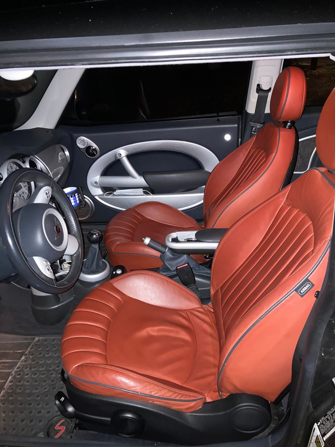

Outstanding Lounge leather in the Redwood... I have a set wating for spring install on my 2006 PW/Blk JCW R53 !
This thread is an inspiration from all of the contributors... and especially from ih8cornnuts....
Thank you all !!

I just wanted to thank everyone on this thread, especially the OP - I used these instructions to install a set of Championship Red Lounge Leather seats into my 2002 JCW at the weekend . . and they worked perfectly. And, thankfully, no airbag warning light on!!

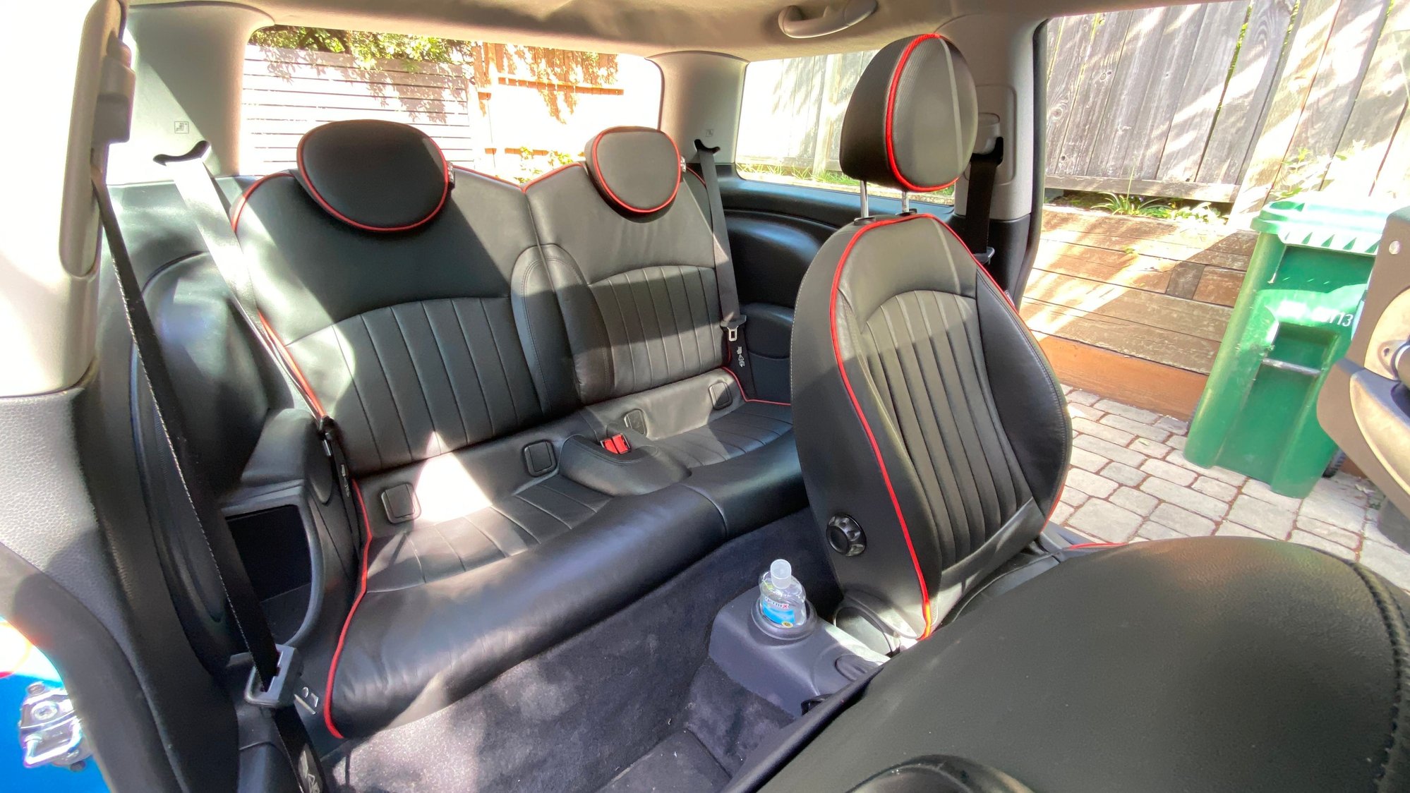

I have the base of the back seat in, but not the two 'backs' yet. The base just clips straight in in place of the R53 seat base.
For the seat 'backs': basically, you need part number 52202751377 which is the centre mount, which is bolted to the floor between the two seat backs, and two of part number 52102752602 - these are the bushings which go into the two outer L shaped brackets where the outer mounting points of the seat backs go. In the R53 is looks as if those brackets are bolted in - but for the R56 they appear to be welded into the car, so you can't just swap the brackets over. The new bushing will tell you what size the hole in the L shaped bracket needs to be (which you will need to make bigger). I have not got to that stage because I do not have the centre mount .. yet. I should have that in a couple of weeks and I will be attempting the fitting then .. and will take photos for a good step by step.

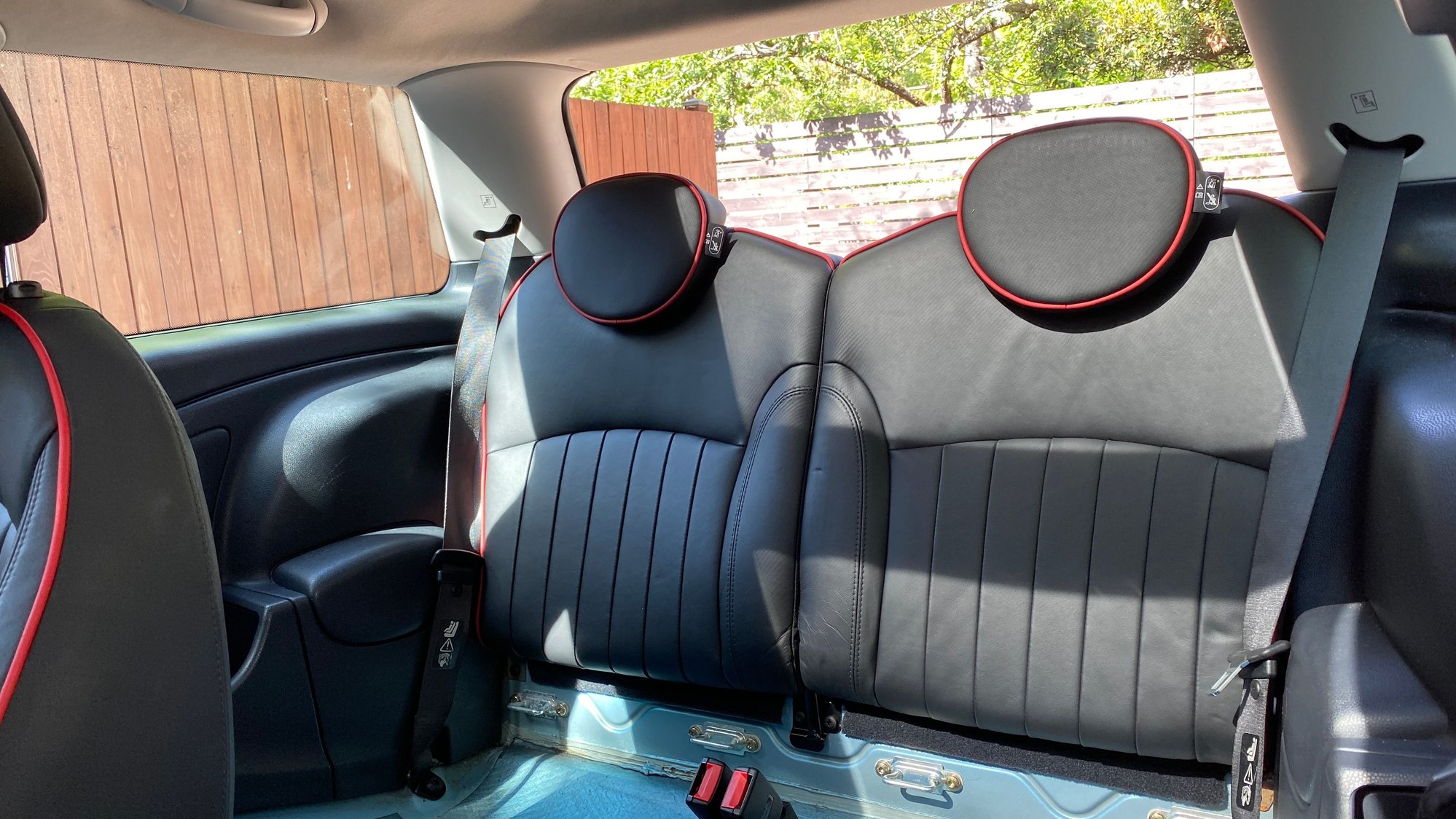

OK, I finally got the back seats in today. IMO, it's a huge pain in the ***.
As I mentioned in the above post, the outer brackets in the R53 (at least in mine) are bolted in - and in second generation cars (at least all the ones I checked) they are welded - so one can't swap them over. The only option is to drill out the holes to make them bigger. You need a 5/8 inch drill bit .. and then you have to do some dremmeling too.
And you do need a new centre bracket, or to get one from a parts car - unfortunately the parts cars I was going to get one from all went off to the crusher the day before I went looking at them . . so I ended up ordering one, which came from Latvia and took 6 weeks to arrive!
The seats look fantastic, now that they're done, but if I'd known it was going to be this difficult I would have just held out and hoped to find a set of R53 English panther leather .. and not bothered with the lounge leather at all

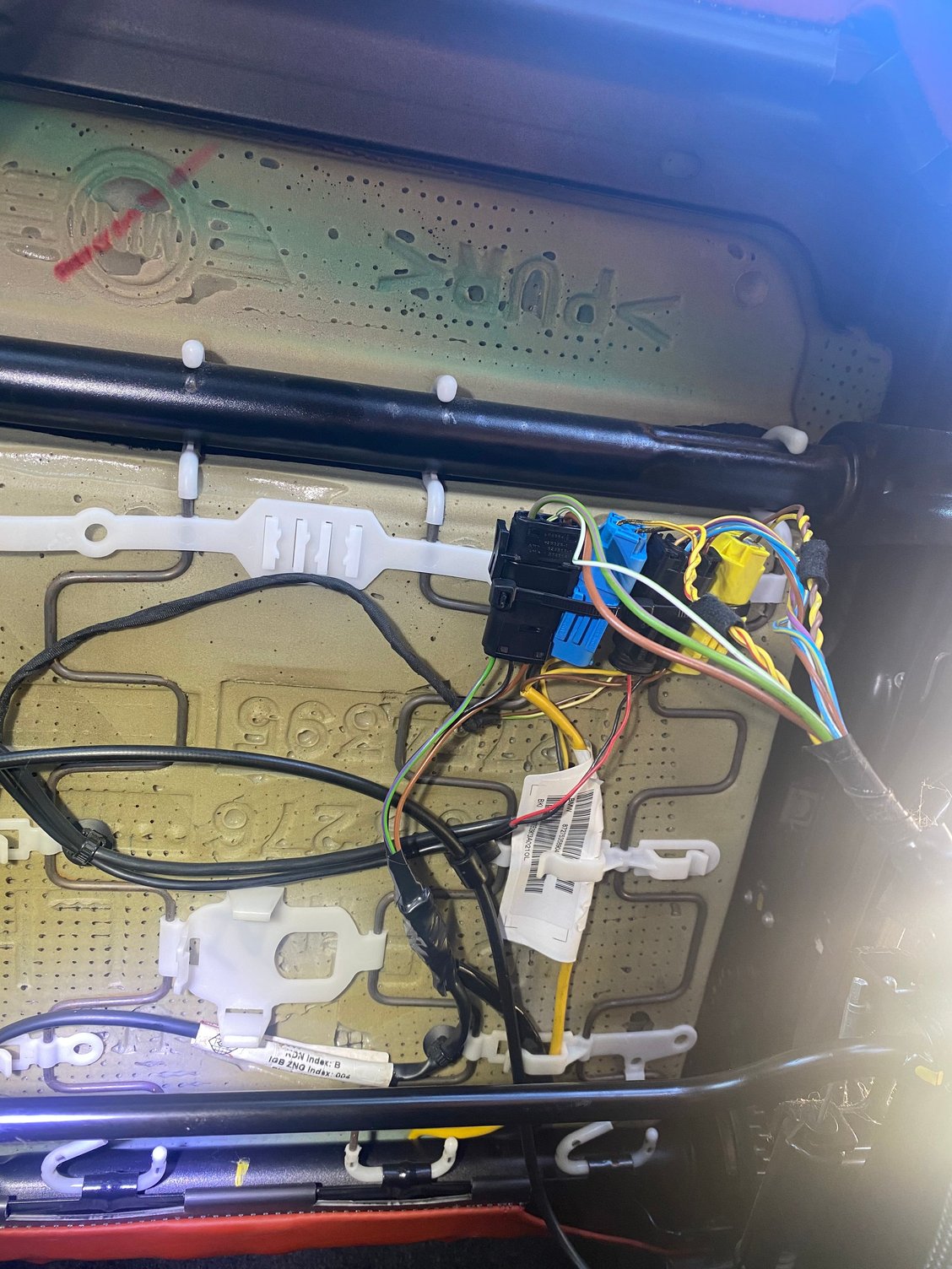

Here's a picture of the driver's side harness. Hopefully, someone can tell me which wires on the R50 to attach each of these to. Thanks!!!
I am currently in a similar dilemma. I am putting R56 heated seats into a 2002 R53. I noticed most of the wire colors are different and the extra wire that is present on the passenger side for some reason. Worth noting that I am attempting without any diagrams, except the one I created along the way. I can say for sure that there are 2 pairs of airbag related wires on each side, which are the ones with the shorting bars.
Fairly confident I got those right but my airbag light was on already, and is still on so I cannot confirm this. I retained the R56 pretensioners but I must have got the wiring wrong because the light stays on now. I still believe it is the black and red wires, but there are 4 of them. One other thing I noticed as that the seat wiring seems to change colors after passing through connectors, which may help match things up. BMW loves brown, black, and red as well.

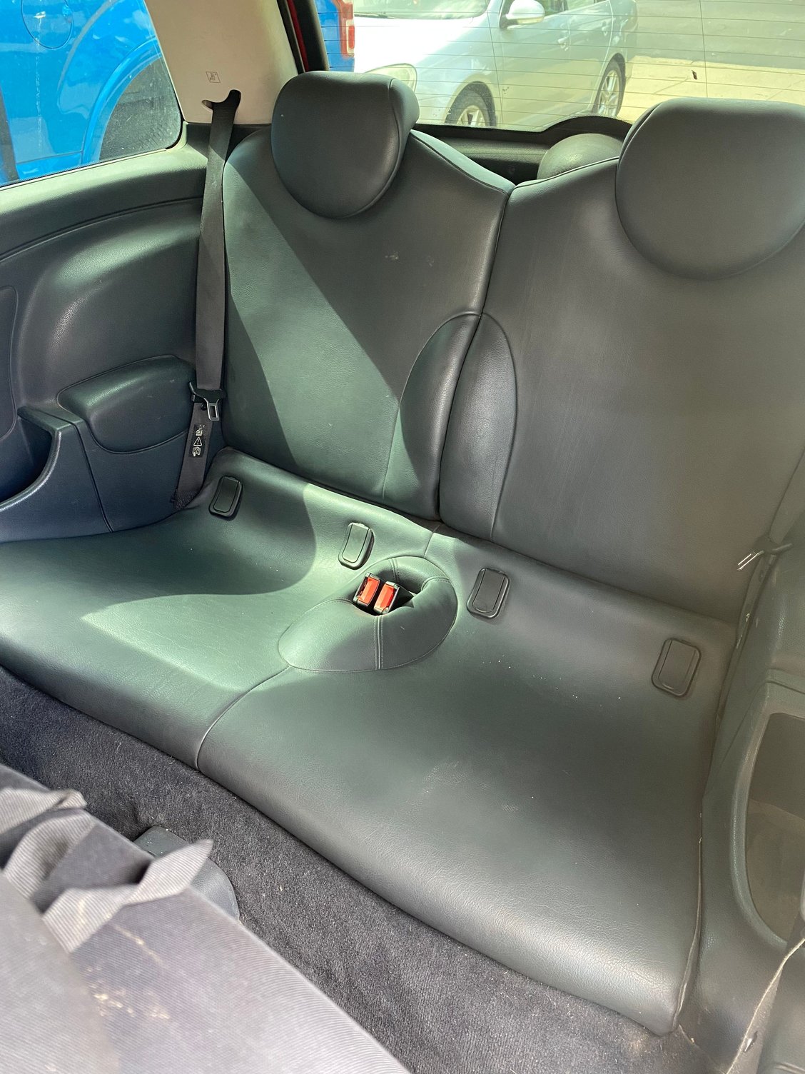

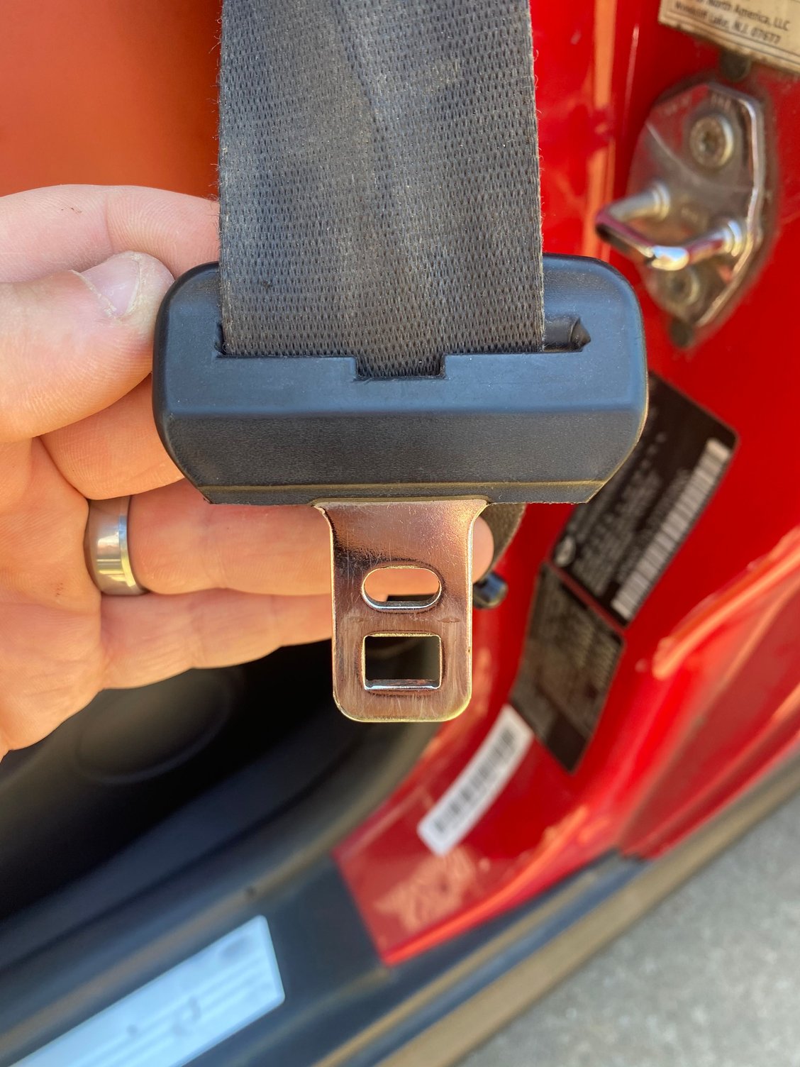

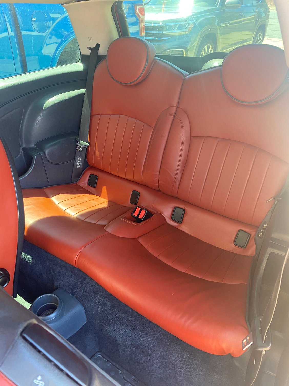

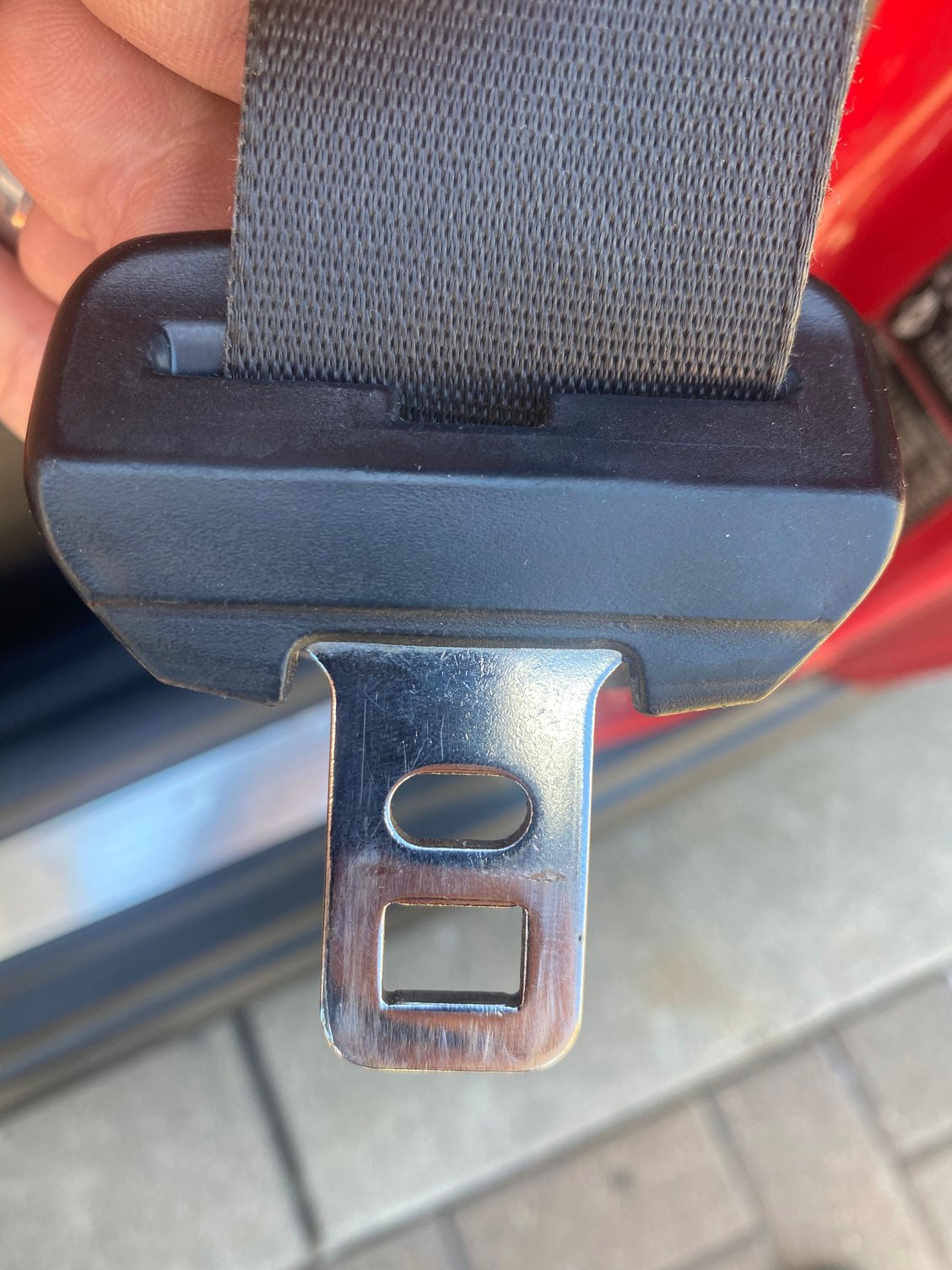

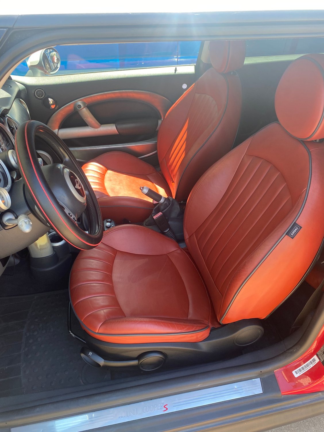

Just semi-finished this mod and wanted to share before and after photos. Now, I just need to sort out the wiring to ensure there are no future issues. Hoping the chart above will help with this.
I decided to retain the R56 buckles, simply because they are newer. I also opted to enlarge the holes for the outer rear seat pivot and got the center support from the donor car. As others have mentioned, the hole and key slots will need to be enlarged and it is bigger than 1/2 inch, which is the biggest drill bit I had. I ended up using a dremel and various attachments. Would be easier to get the outer brackets if they can be removed.
Rear seat pivot. Saw a lot of questions about this but no images yet, so here is a side by side.
R53 buckle before mod
R53 buckle after mod

It is still on, but it was on before changing the seats. I was hopeful because I found a repair to the passenger side pretensioner wiring, with but connectors. Keeping the R56 buckles allowed me to resolve this and the fact that they are newer with nothing spilled into them.
I plan on playing with the wiring again today since I found the chart listed above and also now know how to get the heated seats connected properly.
