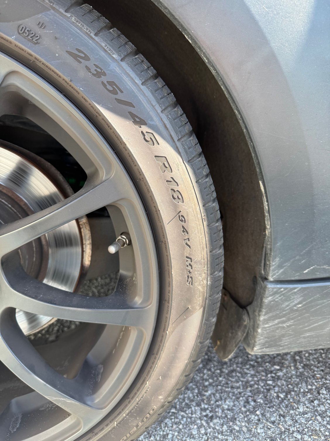

My current set up
Originally Posted by AWD_Rally
Finally got around to installing my APEX Race wheels, studs, 5mm spacers and Firestone tires. I also installed VIP Custom Parts rear control arms. I'm now waiting for the coilovers to arrive. Once those arrive i'll also be installing the M7 25mm rear sway bar and replacing all bushings (available to purchase) with PowerFlex race bushing. we'll see when the coilovers go on, but as of right now there is no rubbing. I may put up to 12mm spacers all around, it will depend how much room we can make with shavings the inside fenders and without going too extreme with the camber (no more than -2.5).
I'll also be vinyl wrapping the car in matte black with matte bronze accents to match my coffee company's branding.
A note on the current height: the car came with the OE sport suspension, so the isn't typical of any MINI stock. The car has raised over time since I have dropped a little over 250 lbs of sprung weight off the car.
Wheel specs:
17x8.5" et40 wheels, 17 lbs each
---> Added 5mm spacers all around, new et is 35 (sits same distance away from strut as stock 18x7.5 wheels)
245/45-17 Firehawk Indy 500 tires, 25 lbs each
---> About 0.3 inches shorter in height compared to the stock 225/45-18 tires
Weight savings from stock: 30 lbs (rotational mass)
Tires
How the car looked before...
How the car looks now.
A few other angles.
Front left
Front left
Front left
Rear left
Rear left
Rear left

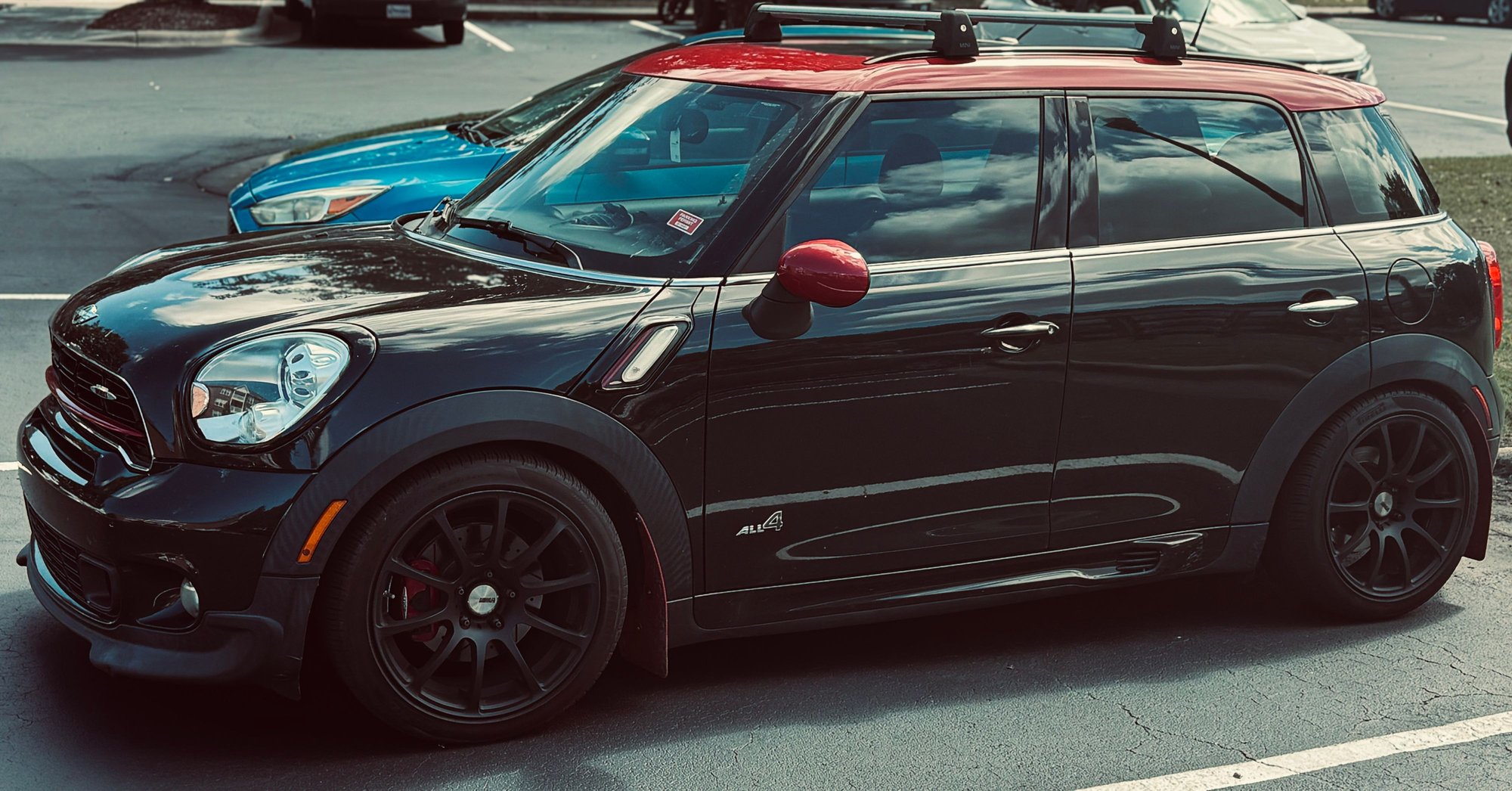

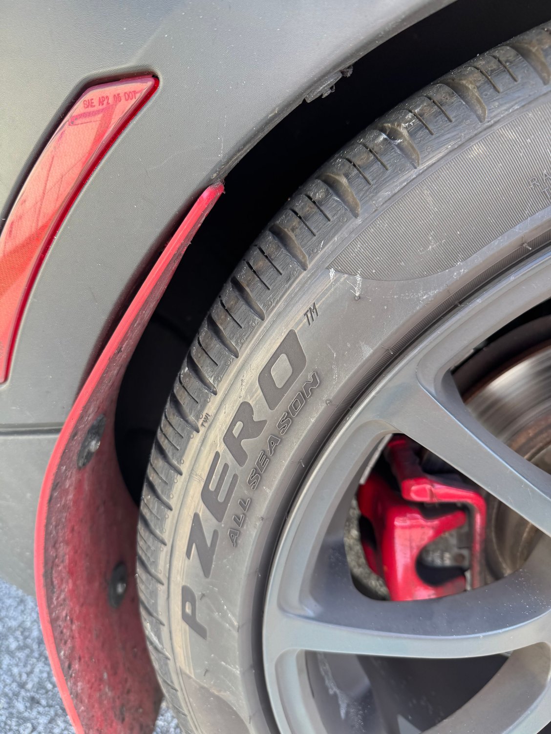

Current stance on 18x8.5 I added more so u can see
Current stance on 18x8.5 I added more so u can see and running 5mm spacers all around I had 15mm all around but couldn’t find studs long enough and was breaking them off weekly got expensive zero run ever
Rear look
Forward front
Forward front
Rear right
Rear right
Rear front
Rear front

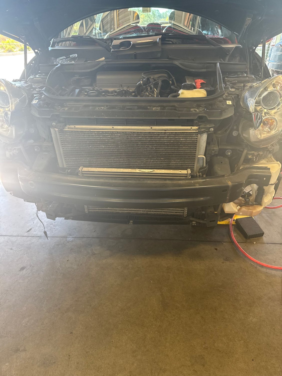

Haven’t started weight reduction yet I started with power mods
Sitting roughly around 2980lbs, down 240lbs from the stock 3220lb curb weight. My goal is to get as close to 2800lbs as possible. I want to for sure keep the A/C, although that would be an easy 60lbs or so off the front end...
Eventually I'll get back to it, I had started the process to get a carbon fiber driveshaft made. Stronger, and of course lighter by about 10 lbs. Combined with the lightweight clutch/flywheel and wheels/tires, the rotational mass will no doubt be highly reduced.
I've deleted little things here and there, and done some major things. Here's a short list of a few things I've done so far:
• Fog light delete
• Window washer delete (installing small tank)
• 5 lb. Li-Ion battery
• Lightweight Flywheel & Clutch
• Full custom exhaust (lighter mufflers, no cats)
• Center console delete
• Rear seat delete
• Small hooks, brackets, etc
• And more....
Once my new APEX wheels go on that will be another 40lbs off the car -- the OE wheels and run flats are super heavy. The APEX wheels are 17x8.5" 17lbs each. I'll be running 245/45-17 tires on them. I also want to install coilovers at the same time.
Getting a carbon fiber hood is probably my next major weight reduction purchase, shaving around 25lbs off the front end. The hood and wheels will cut off about 65 lbs, putting the ALL4 at 2915 lbs.
Day 1. No weight reduction, stock height.
Today. Most recent pic of ride height. You can see that it's raised a bit since day 1.
Current engine bay. Has a few upgrades.
Running all RPM Power stuff so k20 350hp turbo, rpm stage 3 tune, rpm intake with heater delete, high flow filter, progressive meth injection system, hard pipe intercooler pipes with injector bung, 750cc injector, comp intercooler, RPM careless downpipe with factory JCW exhaust system. I have lots more just started saving for the weight reduction jcw alcantera steering wheel, ONP wrc seats etc… how did u do the rear seat delete been looking for one like the r56 can’t find one can’t go forward.
