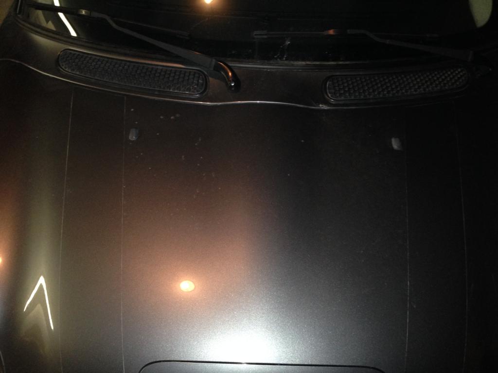

It took a grand total of about 12 minutes to peel the stripes off. I kept the blowdryer about three inches from the stripe, peeled slowly while heating, and they came off in one piece. I actually just peeled up a corner (at the top) with my fingernail and then pulled down - never used the scraper during this step. The heat made the biggest difference, it was absolutely necessary.
Note the small lines of residue on the edges of where the stripes used to be.
Then I gave the hood a really quick wash to get rid of any dirt

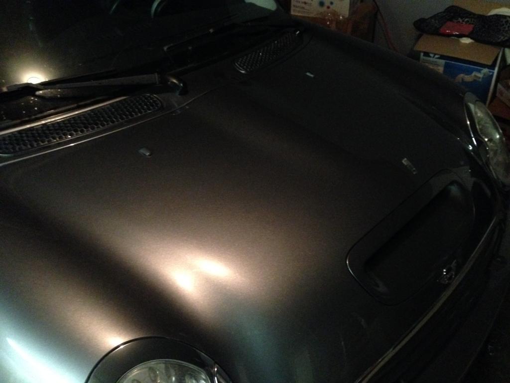

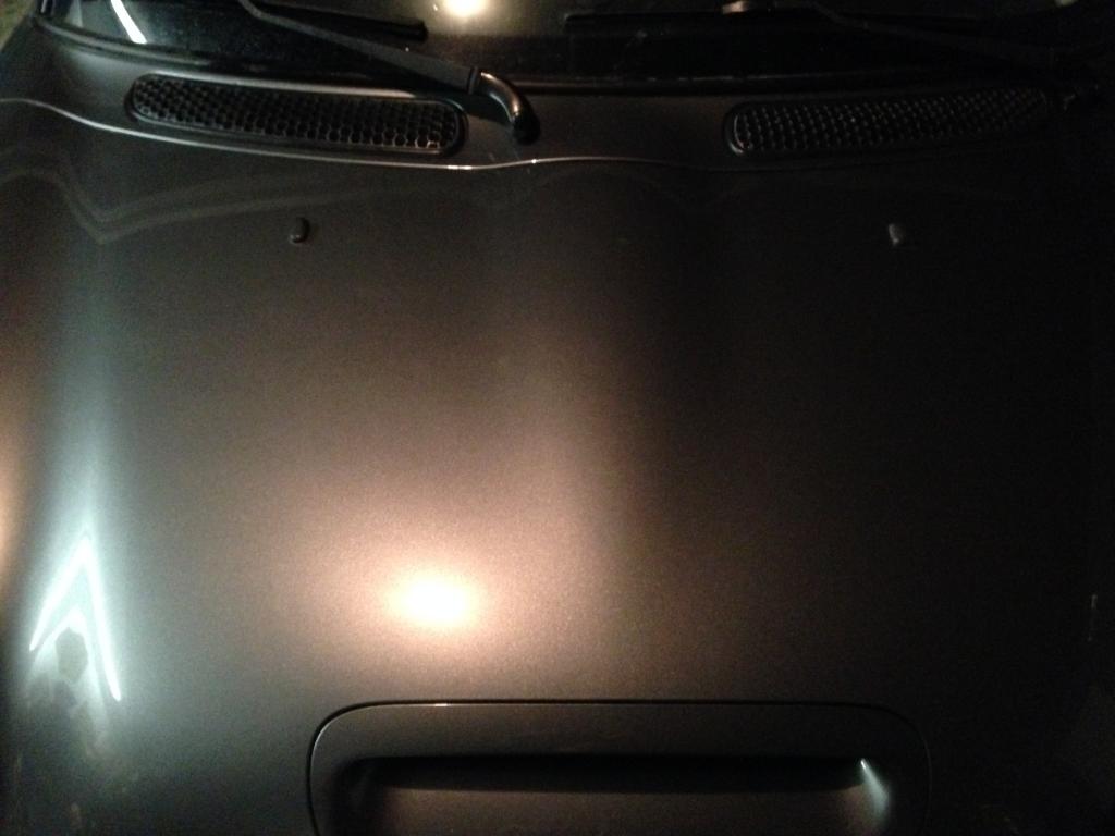

The next thing I did was take my All Clean and water mixture and spray down the area with the residue on it, and scrape with the yellow scraper. I did this very gently to minimize any micro-scratches. Overall, this did a great job, hardly anything was left over. There were a few problem areas though that I expected to be able to take care of with a clay bar job.
After the clay bar, a few little patches of adhesive remained, which I hope to remove tomorrow. Should come off fine with a soak of All Clean and a little scrub.
The discoloration really seems to be very minimal. There is more than the pictures show (again, sorry for the dark, I'll get up some sunlight pictures tomorrow), but not bad. Hopefully with some polish and a thorough buff the shades will blend more or less seamlessly.
Overall, the job was very quick, taking roughly an hour, and I didn't have too much of a problem with anything. Anxious to see the results in the morning.
