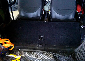

I got bored one day and decided to remove the rear seats and figured I could probably build a seat delete kit for cheap... so I did.
Here are some low quality phone pics but I'll get some more shots when it warms up a bit.
Materials/Cost List:
24 x 48 x 3/4 Birch Plywood - $14
2x Hinges - $8
Handle/Pull thingy - $6
Carpet - $8 (actually was $17 but I bought way to much. Only ended up using half)
Screws/Washers/Nuts - $10
Bolt - $5
Conduits - $4
Total: $55 + a few hours of work/planning.
I think it turned out better than I thought it would. My goal was to build it in a way that I could reinstall the seats and no one would ever knw they were yanked out.

Good job! Is there a storage compartment under that cover? I notice it has a pull ring for lifting it up.
The GP2's have some limited storage space under their deleted rear seat area.

Affirm. There's some storage space under there but I need to figure out how I'm going to section them off for a first aid kit, tire repair kit, cold weather stuff, etc...

Hahaha Negative. That nook is about 5-6 inches deep and slopes so I doubt anything bigger than 10x6 would fit.
