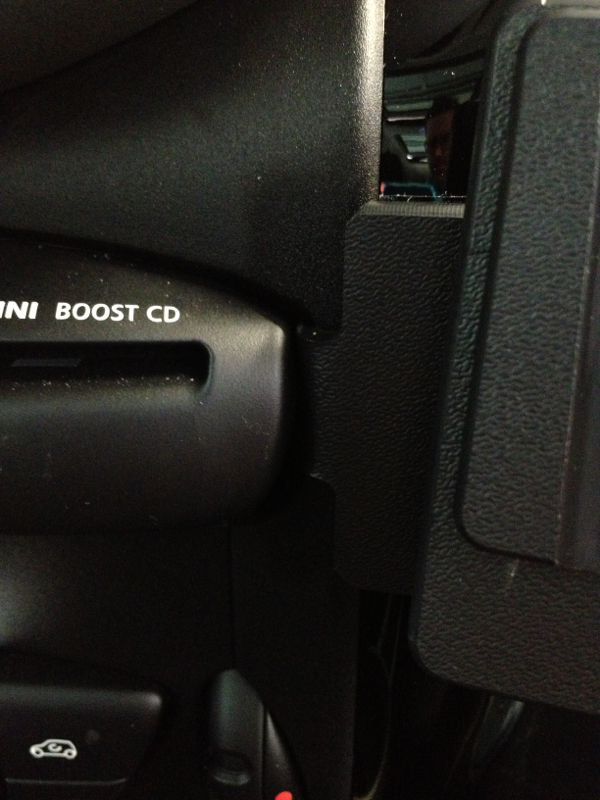

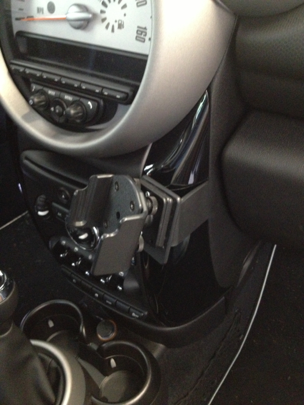

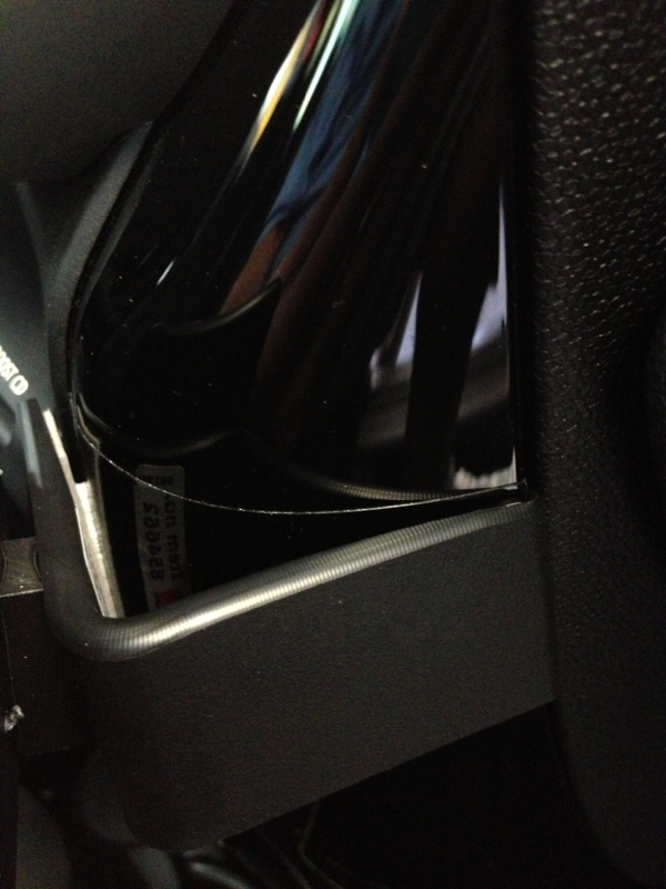

It's important to note that the Proclip holder uses the gap between the CD player and wraps around the trim (piano black in my case) on the center console. Two things. The ProClip mount was very thick where it pushed into the gap where the CD player was. I was able to carefully use the dremel with a sanding tool to remove material until it fit, and would not distort or damage the OEM plastic. Also, I was concerned that the clip would eventually scratch or mar the piano black plastic trim. To prevent this, I installed some clear bra material (Avery Nano Fusion it happens) on the piano black trim. The installation is solid, and shouldn't cause any damage with use.

And sorry to the OP, not meaning to hijack your thread. I would still like to see some more closeups of the Pro Clip where it attaches to the dash.
No problem, and thanks for the info. This thread is more of a mounting option discussion thread, though it didn't start as such.
I will post some more pics (probably use my iPhone camera, but still) tonight.
Attached some photos of the mount. I recently reinstalled it. Replacing the double sided tape with some wider strips. I also reinstalled the paint protection film on the piano black trim. Lastly I sanded the proclip mount to be a little thinner and more conformed to where it inserts between the CD player and trim.
