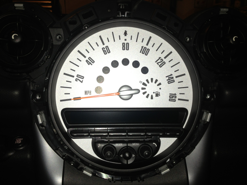

Piece is not attached to the clear cover on the CM.

On the CM there is two screw on the bottom that hold the speedo ring in place. They are not easy to get to without taking the center stack pieces apart and I am trying to avoid that.

On the CM there is two screw on the bottom that hold the speedo ring in place. They are not easy to get to without taking the center stack pieces apart and I am trying to avoid that. I can get the clips with the o ring pick but I still have to access these two screws.

Done. I am guessing the CM is different than the standard 2nd gen. You have to take the 2 side pieces that run along the center stack off. They pull off to the side me are held by pressure clips. This will give you access to the two screws hold the speedo trim ring that hold the face on. After you remove the 2 screws you will still not be able to completely remove the trim piece but it gives you enough room to remove the gauge face from the speedo. The black trim piece that is attached to the gauge face was a pit of a pain and I noticed that a few of the little stubs had the tips broken off after I removed the gauge face. I took the extra measure to put a tiny drop of hot glue on each of the stubs to make sure it stayed on. I then was able to wiggle the new gauge face in place. All in all not too bad but hopefully this will help any CM owners that want to do this mod.

Some pics.
