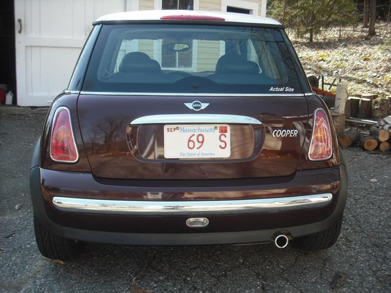

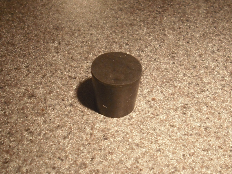

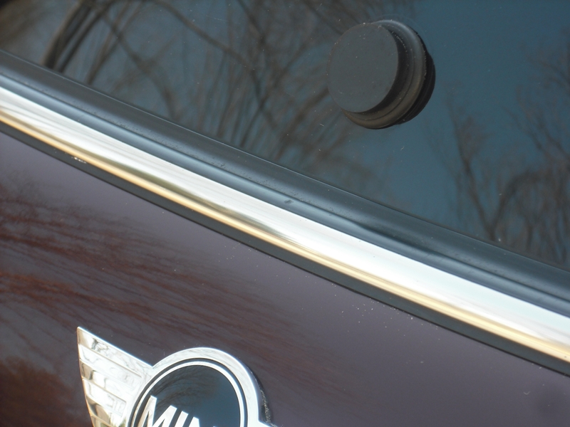

Half the price and one-third as may pieces as the $2 wiper delete kit!
Consists of one part:
A rubber stopper from the hardware store. It is listed as " 1 inch top diameter" and actually cost $1.17 with MA sales tax.
I simply drove it into the center hole of the stock gasket/grommet with a wooden mallet. It's in there very snug and I expect it to stay that way. I've tested it with the power-washer and not a drop of water is getting in. Here in New England, this is vitally important to prolong the rusting-out process which is the eventual death of most every car 'round here.
As for the washer tube, I simply turned the check valve around.
Attached Thumbnails The alt= wiper delete kit.-010-plug.jpg   The alt= wiper delete kit.-050-plug-sun-detail-wings.jpg   The alt= wiper delete kit.-040-plug-full-rear-view.jpg

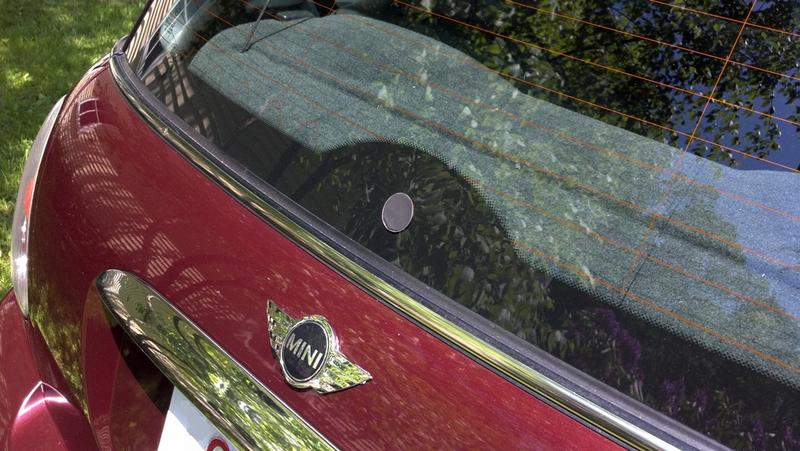

Ok, here's an update. I got a cleaner take on it. i realized if i just bought a larger plug, I wouldn't need to original rubber surround.
I installed this one under slight compression and sealed it with clear latex caulk. I did this last fall and now it's spring here in New England. Not a single leak!
Now I'm thinking about how to make it shiny so it doesn't contrast with the glass so much.
However, I'm pushing the cost of this mod upwards of two dollars with this larger plug. (for the sake of full disclosure)
Attached Thumbnails The alt= wiper delete kit.-wiper-delete.jpg   The alt= wiper delete kit.-full-sun2.jpg

So you took the grommet out, what size plug did you end up buying?
Since I live in the desert and it only rains about 3 times a year for a day at a time - all the rear window wiper does is bake in the sun until the rubber rots and the plastic is brittle enough to shatter when moved, which is what mine just did. It is coming off.
Old Jul 4, 2013 | 12:01 PM
Mynewt's Avatar
Mynewt
Joined: Jun 2010
Posts: 271
From: Mass-North Quabbin
Sorry for the delay in response. But i actually wanted to have an answer for you.
The hole in my 2003 R50 window is one-and-a-sixteenth inches in diameter. And yes, I have taken to wiper shaft grommet out and am fitting these plugs diretly in the hole n the glass.
Home Depot sells rubber stoppers of 1-1/16" and 1-1/4". One-and-a-quarter is obviously going to leave quite a bit of plug protruding. And one-and-a-sixteenth is the same size as the hole, so there will be no compression.
One-and-a-sixteenth is what i have in there now. And the clear silicone calking is essential to getting it to stay in place and to seal.
I bought a couple more plugs just yesterday thinking i would reinstall a new one that i pained first. (I'll see how flexible spray paint made for plastic is.) Unfortunately, the plugs I just bought a HD have a number "5" cast on their tops.
I'm going to stop at my local hardware store (Home Depot is not my local hardware store) and see if they have 1-1/16 plugs w/o any lettering or printing like the one I have in there now. I'll see if 1-1/8" is available too and check the fit with that.
