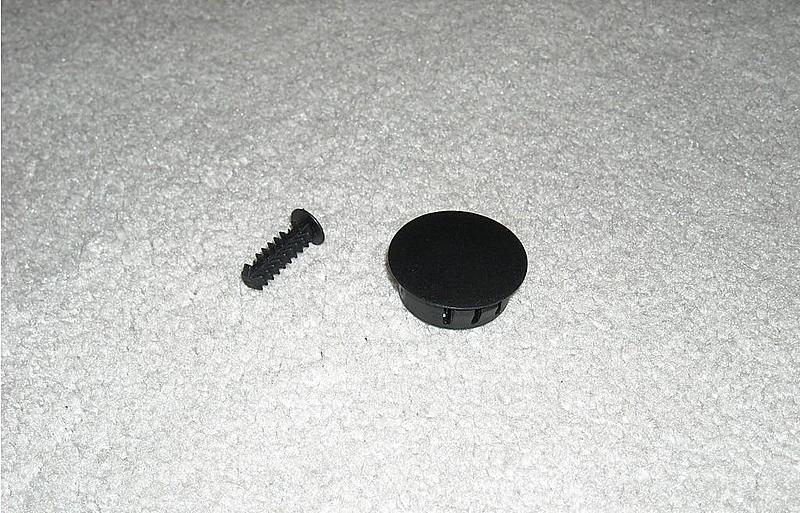

Both from Lowes, a 1" plastic hole plug, and a GM automotive trim fastener (for the water line). Each packet comes with 2ea, so you can do 2 wiper deletes. A little black RTV under the lip of the hole plug before popping it in, and a little cleanup on the glass with some WD40 (excess RTV).
Parts for this project at Lowes:
1" Plastic Hole Plug, 2pk, $1.39, p/n 139483
GM Automotive Trim Fastener, 2pk, .68cents, p/n 138211
RTV Silicone (your preference)
Attached Thumbnails The  Wiper Delete Kit-plug-and-plug.jpg   The  Wiper Delete Kit-plug.jpg

I don't have the part number for the hose plug, bought that earlier when I was trying another "experiment" which is below, and I threw that receipt out along with the little baggie. but the part number for the 1" hole plug is 139483. On each side of the 1" hole plug is small gripper tabs...bend them out ever so slightly to get a better grip on the glass. It will grip the glass right at the very top of those tabs.
