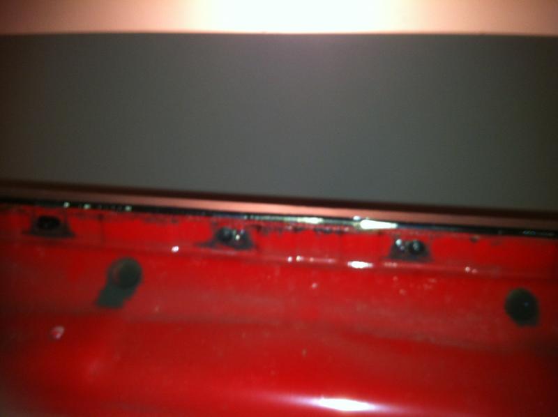

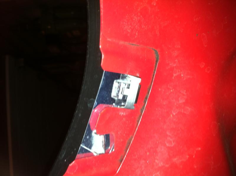

This is a quick put together for those who asked how this stuff is removed on the car. As it being 11:30pm tomorrow when I get home I will take picutres and reedit this post and be a bit more detailed.
To remove the side scutties you simply put pressure on it, press down, and pull or push (depends how your standing and holding the scuttie) towards the exhaust. It gives a small fight but makes a loud pop and that's how you know it came off. gently remove the bulb, put it in the new one, and push it back on.
grill is very simple. the top part there is 4 screws, unscrew them and gently shift the grill to the left so it unlocks and can be easily removed.
These are the two screws located in the center of the grill
This is the picture of the other screw which is located on the end of each part of the grill.
With the bottom I just took a flat head screw driver and gentled pried it off starting from the center of the bottom piece working my way outward. At the end each piece is clipped in, just be gentle with this part when undoing it i broke mine being too forceful.
For the headlight rings, each of the black pieces that are clipped onto the headlight ring pop off. push the black piece towards the center of the headlight ring and with some force they will pop off. these take extra oomph when pushing. Tip: switch up the fingers. I used one thumb and it hurt some of them can be a *****.
This is a picture of the headlight ring, there are a bunch of these little black pieces that clamp the headlight ring down. you just push these downward as well as towards the center of the headlight ring.
Heres just a picture of another one...

Attached Thumbnails removing all chrome exterior parts-img_0056.jpg   removing all chrome exterior parts-img_0057.jpg   removing all chrome exterior parts-img_0054.jpg
