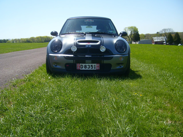

I tried heating them but it did not work, that glue is basically the consistency of plastic. I ended up cutting them open with a dremel tool w/1.5" cutting disk, just below the lip where the plastic lens sits in the light housing. Then slowly chiseled out all that glue I used fiberglass mesh tape with silicone glue to put it back together. It's been a couple of years, but it's held up great, no problems with the lights. The only thing I can offer at this point, is that it's very hard & time consuming, in my case about 2 weeks from start to finish. I wish I could offer more help, but I basically just went at it slowly, feeling my way as I went. But like I said, if you start by cutting at the base of that lip, then it all sort of makes sense as you go along.
