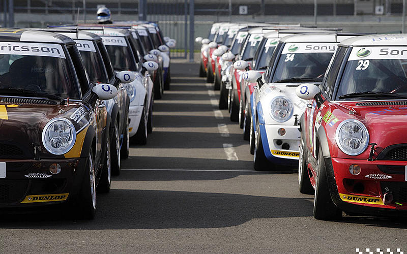

Here is a pic from the MINI challenge cars. You can see they have hood pins above the headlights. I assume they are far back enough where the pins are mounted to the strut towers/chassis sheet metal.
EDIT: They also have hood latches

I was thinking about that spot, but they also have those latched in the front. If I only had the pins I feel that the hood would catch air and would possibly come up and break where those pins are.
