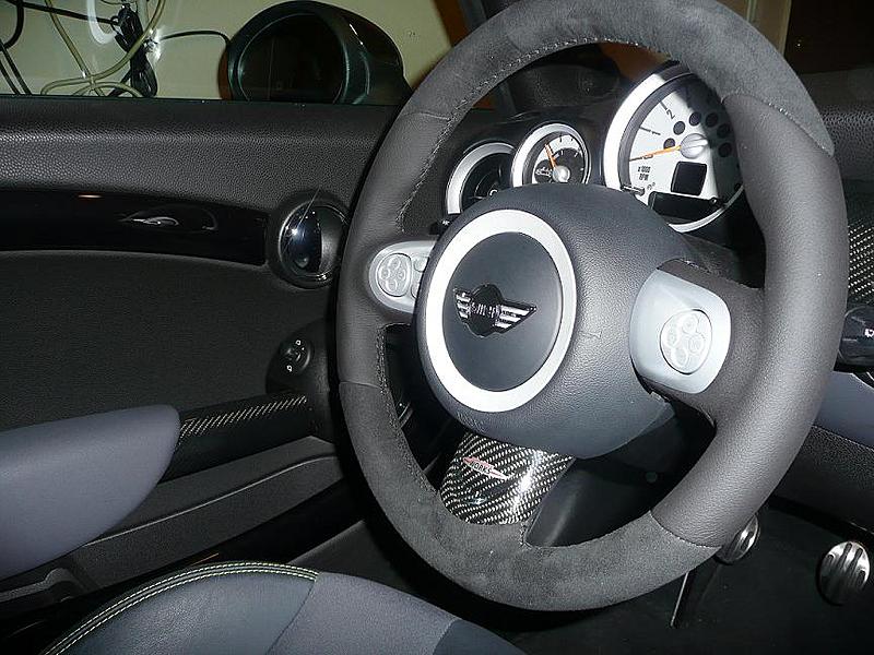

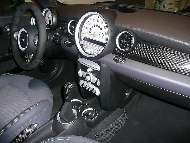

I finally figured out how to install these, after googling, and searching. Had a difficult time prying off the upper speaker cover, but after that it was easy. As stated in another of my posts, no need to remove the door panels, just pop off the speaker cover, arm rest, and it is 2 torx screws. Love how it came out. Also did the steering wheel, dash, shifter **** and ebrake handle, and alcantra boots for shifter and ebrake.

Very nice touch. The upper speaker ring is a but tricky to remove. I always say to just grab, squeeze, and pull. Is the carbon fiber the whole piece, or just an overlay?

Samysonary, thanks. The carbon fiber is the whole piece, and it is a JCW part. You can do a search on google and find them. I posted the pictures of these pieces on another thread in the interior section here, "How do I install these inner door pulls".

how much did the carbon fiber trim cost you rans? not talking about the JCW parts such as the ****/wheel/handbrake. looks very sharp

The door pulls cost 169.00 total for the pair, that includes shipping and tax. The dash cost me 400.00 total, for both pieces including shipping, those I purchased on ebay from morristown mini. By the way, these are JCW parts also.
