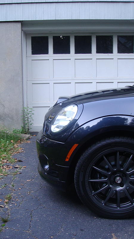

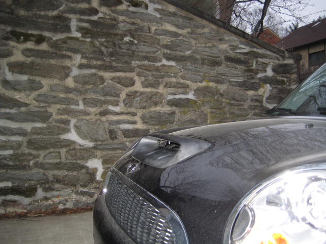

I just put it on! I had it painted glossy black. Im still on the fence if I want to keep it. Something tells me I should black out the chrome.

Yes the scoop looks great but black out some chrome and it will look a lot better.

Friends don't let friends drive with chrome....finish the job you started.

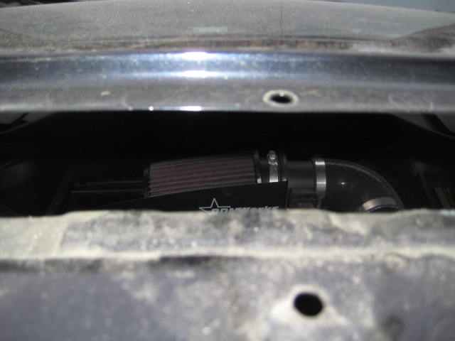

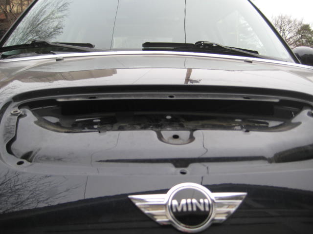

I got an M7 V scoop and did some modifying to create a larger opening in the stock hood scoop.
There is an obstruction behind the stock scoop that blocks half of the opening. The above picture is a view with the stock scoop removed.

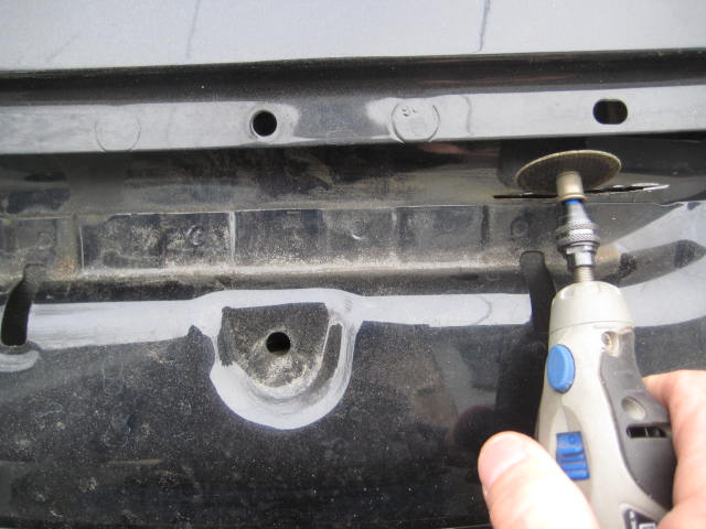

The above is a picture of the practice cut. I wanted to see how easy the cutting would be and if the blade would follow the line I wanted. The final cut, followed the line just below the practice cut where the 2 pcs. of sheet metal overlapped. After the cut, I burnished everything smooth so it would be safe to fingers and a good surface to prime.

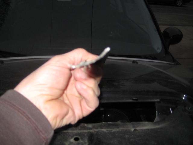

The following is a picture of the pcs of material removed from the hood. Note the profile that diverted and blocked the air.
Thats it. It is now much more open. The thought behind this was/is, why have a CAI if no air gets in.

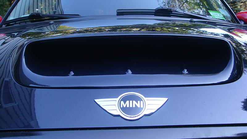

I got one too, painted it body color, you could try that too!
I also have the AGS-R, a very good compliment lol
