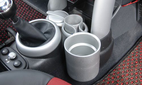

Hey Everyone
WHere do I get the little black pin from?
Attached Thumbnails How to Install a Cup Holder?-mini-20cup-20holder-20front.jpg
I'm sure the dealership only sells this as a whole with the cupholder. I noticed my cupholder broke the other day at the mounting points. Damn heavy XL cups.
Just checked my broken cupholder, at first I thought it was all one piece. Then noticed it does come apart. Wonder if I can just buy the silver mounting piece or spend $68 for a new piece
