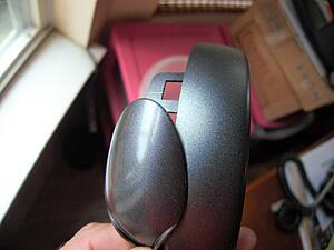

Testing out Tamiya TS-38 = "Anthacite" today
I can't help but feel that I maybe continuing to beat a dead horse thread here.
@Oldboy Speedwell already pretty much covered it in his previous post
Received 2)cans of Tamiya TS-38 from
Amazon Amazon
yesterday ($7.75 ea. + s/h $6.25).
Here are my comparison test results between Tamiya TS-38 and Mini anthracite:
Updated: Pictured above is a small white, un-primed plastic bottle I sprayed with 2wo light even passes..
I re-photographed the test painted bottle under outdoor sunny skies.
The color is a pretty close match in the black and gray spectrum and the blue hue is actually much better under these lighting conditions.
Pictured above; A comparison between the Tamiya and the Mini bottom speaker bezel taken outdoors under partly cloudy skies. Although it's a little bit on the red/purple (brown) tint side.
Metallic density is a little tiny but fair. I expected the paint to be more of a matte finish but was surprised to find that the Tamiya had a nice soft, near glossy (satin) sheen as a result.
Another example/comparison to the Mini (matte finish) door pull and the Tamiya TS-38....IMO - Still not enough blue to exact match the original matte finished components....
but it's closer than all the other paints I've tried.

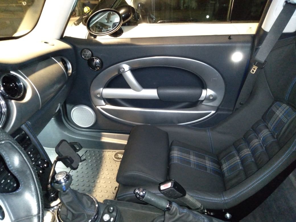

Finally; A fair comparison between the Mini anthracite door insert/pocket and the Tamiya paint sample.
This almost works for me. Although by comparison, I still feel the Tamiya TS-38 is just a bit shy in the blue spectrum.
All my other original anthracite interior matte finish components, are scratch and free of discernible wear.
My only objective is to restore/paint the entire anthracite "plastic" door insert/surrounds which have a high gloss finish.
Given that my Tamiya sample is not a completely matte finish, (perhaps because of the the way I sprayed it); This paint may very well meet my expectations after clearcoat.
BTW: To complicate the matter of finding the right match...Yesterday, going out to my Mini, there was a Tesla S parked next to me. As I opened my door, I almost couldn't believe it.
The Tesla's paint color matched my anthracite door insert exactly! The Tesla paint color is identified as Midnight Silver Metallic. Not surprising - A mere $65/can on Amazon.
And, yes - I understand NAPA can custom mix/color match an aerosol . Although the only one in my area only hires complete lazy idiots as a prerequisite to work in that store.
