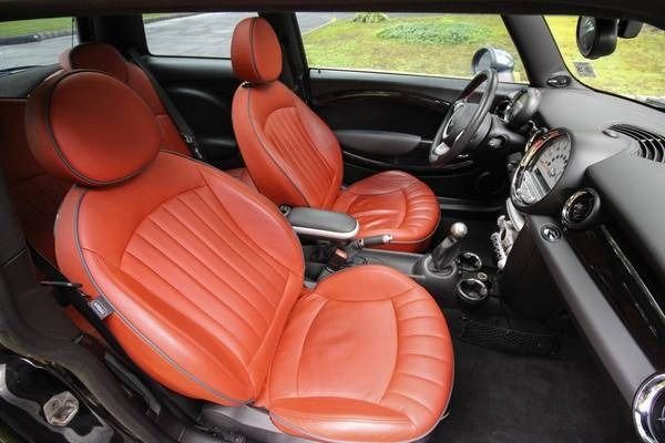

So.... They also call the dark colored headliner option on the R-series... "Anthracite" .... but it is much closer to the 'panther" of the dashboard/door-card vinyl or "panther vinyl/leather' than this 'Anthracite' metallic paint color.
I'd like to ditch the 'busy-ness' of my R53 interior by making the color scheme inside simpler and run either top notch recovers in Panther with a tone/tone double stitch (like Katzkins)... or, contrasting OE-MINI Lounge Leather seats like redwood or satellite (keeping the interior all 'Panther'... like the R56 below) ..
Its a small car interior... and I'd like to stay away from the 'cute' add-ons and multiple colors.
This 'anthracite' color, for me, is a more desirable color vs body-color or silver or 'piano black-7" schemes ... but maybe getting a slightly metallic color mixed up that more closely matches the Panther color of the dash and the pillars would nice.
THE S4AA 'Headlining Anthracite' OE-MINI option in MY 2006 53.... For me, IMO, too much going on with all the diff colors of the dash, two-tone seats (silbergrau/grey).... Simplified would be better for me. The 'anthracite' metallic Tesla/Tamiya/MINI color is the best of the factory colors for my preferences.... but I think I could up the game a bit with a gloss-panther for the dash-face, DT's etc ...that would be a good match for the S4AA-pillar color.
