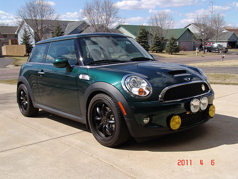

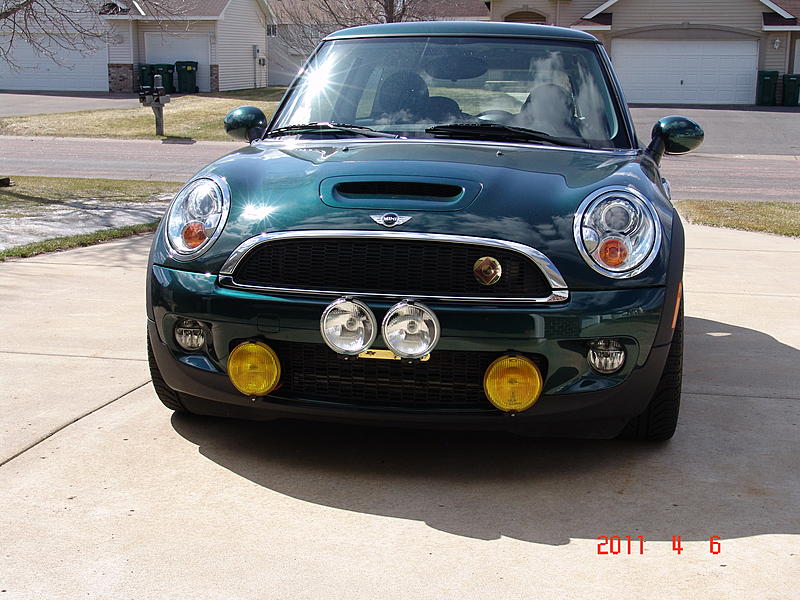

Originally Posted by Maugre
Attachment 52645
Attachment 52646
Attachment 52647
Installed Bosch driving and fog lamps. Independently switched and relayed.
Made the brackets myself out of brass. Found a way to use the two holes the dealer made for the license plate holder .
Hey, well done. This is the first 2nd gen car with lights on the lower grill I've seen. That's where the fogs should be, IMO. Yellow lens with the BRG and Rotas(?) are just a great combo. Could I/we trouble you for some mounting details or photos of the lower grill mounts? Common on 1st gen. I've wondered if there wasn't a complication with the 2nd gen lower grill mount. Are they nice and steady?
Old May 8, 2011 | 10:21 AM
  #130
Maugre's Avatar
Maugre
Joined: Jul 2010
Posts: 603
From: Minnesota
Thanks KPH, I'm sorry I don't have any photos of the mounting brackets I made, but I could give some details.
On the lower grill location, that area is basically solid plastic behind the honeycomb. The mount is about 2 1/2" long and about 1 1/8" wide. I formed it around a piece of wood that I cut to a couple of compound angles to get the lamps to sit right. I have a strap of brass behind the grill for reinforcement. They are very steady.
I'll try and take some additional pic's maybe this week or next.
I'm waiting for a FMIC so I can take the bumper off again.
I suppose once I post pic's, there goes my million dollar idea .
I suppose once I post pic's, there goes my million dollar idea :lol: .
Thanks Maugre for the quick reply. Just knowing bumper removal is required is good info. Look forward to more pics when the intercooler job comes around. As for a million dollar idea; think of it this way: Garage-Steve Jobs-Apple Computer. Ka-Ching!

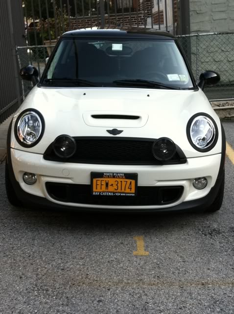

Old Oct 3, 2011 | 01:36 PM
  #133
micron's Avatar
micron
Posts: 46
Old Oct 3, 2011 | 05:14 PM
  #134
schreiber117's Avatar
schreiber117
Joined: Sep 2008
Posts: 346
Originally Posted by micron
any chance of a cleaner shot, maybe the side a bit?
What lights are those?

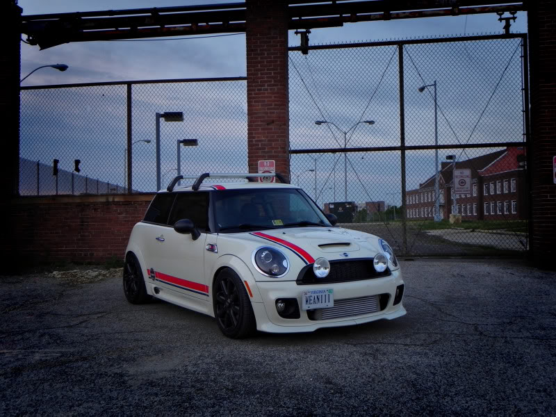

Originally Posted by TSR53
PIAA Racing 80 XT, high beam, low beam H4 bulb in each with Hella Rallye 3000 covers and custom mounts.
now those are rally lights!
